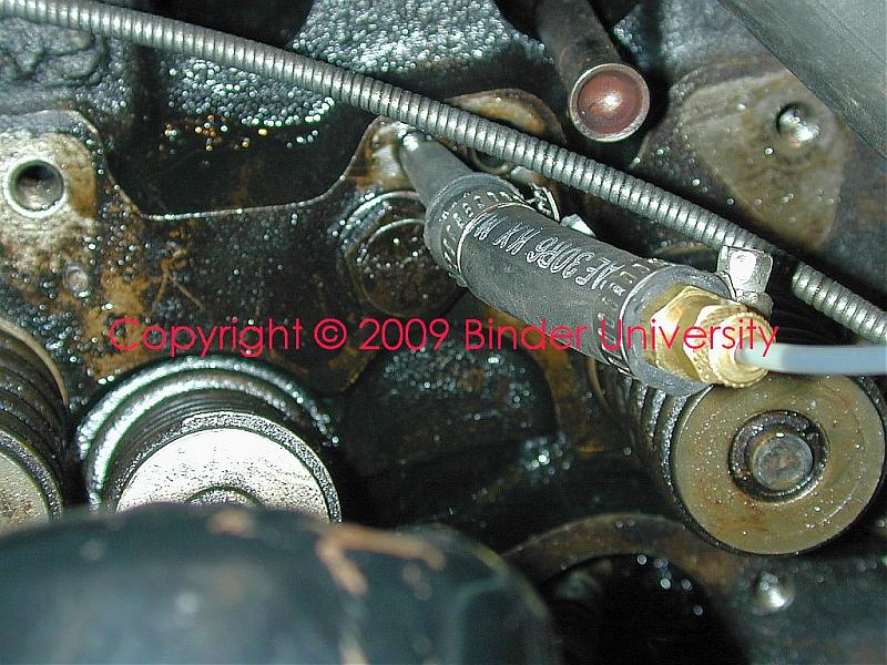

The adapter I fabbed for determining oil pressure at the feed spit hole in each cylinder head is a semi-rigid rubber fitting found in a mityvac hand vacuum pump kit, pic attached.
I have not gone to the trouble of determining degrees of crank rotation regarding when the #3 and #4 cam journals/bearings align to allow oil passage. But I will determine that soon using a 345 I'm currently building. And that build is being documented here, it will include how to properly line up the cam bearings for initial installation, and then how to verify and "adjust" the oil holes in each cam bearing/location:

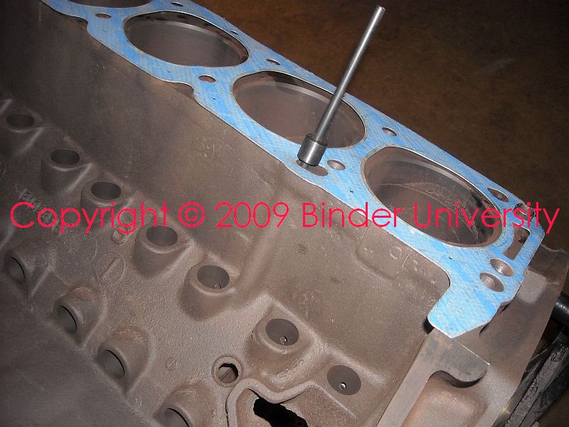

The alignment process involves using a aircraft-pattern drill bit along with a stop collar. Then the holes are slightly chamfered with a carbide burr in a die grinder.
Also...as part of this precise cam bearing installation process, Robert kenney and I are looking at additional methodology to possibly improve oil delivery to the lifter gallery. Improper rear cam bearing installation has a huge impact on oil supply to the lifters and May be a contributing factor as to why some of these engines have oiling issues only after the block is assembled during overhaul.
That is because the mechanic/machinist performing the cam bearing install just "knocked 'em in" and paid little attention to proper alignment and depth of installation. Again...very few of these engines are seen today in the typical machine shop, and the machinist simply treats 'em like a chryfordrolet! We also know that the durabond cam bearings do not have some of the spit holes drilled in the correct locations but can be fudged with proper attention to installation.

Blowing air through the lube system won't prove anything. Every bearing/journal has "clearance" which allows air escape. And the internal drillings for the lube passageways are labyrinths.
When any block is assembled, all passageways should be verified as "clear" of any debris before the soft plugs and thread-in plugs are installed. That is done by solvent cleaning the passages with various sizes of steel and brass brushes made for that purpose...followed up by powerwashing with a commercial detergent. And no rtv should be used anywhere, that shit is only good for plugging passages and orifices when it squeezes. If there is evidence of rtv on the rear cam plate at the block, oil pump mount, oil filter system mounting, oil pickup screen, anywhere near the rocker shaft assemblies, etc., that is evidence that the shit could be inside.
And yes, I've seen all the above crap with these engines on a regular basis...including a 152 I busted down into parts status just this morning. And yes, the cam bearings were wiped out and the cam is "flat" on that engine...along with the oil pickup screen being completely plugged with rtv shit and mung.
The camshaft lube hole across bearing journal #2 and #4 is not drilled dead center...it's offset. Thus the two oil holes only align with the hole in the bearing in a "staggered" manner. The oil hole for the #5 cam bearing which serves the lifter galleries is drilled dead center, perpendicular to the axis of the cam.
This pic shows the process of using a drill bit to verify cam bearing/block saddle alignment after the bearing is installed. If the bearing is not properly aligned, then ya use the drill to clean up the hole, then the bearing surface is deburred with the die grinder in a hand operation. And once all oil passages are verified, cylinder and lifter bore honing is completed, the block is sterilized for the final time in preparation for coating the interior so that assembly can begin.
When the oil passage in the cam journal, is aligned in the proper position with the bearing on either #2 or #4, then once the oil pump is spun, oil delivery through the spit hole on either bank will be near instantaneous. But those passages do not align simultaneously...again oil delivery is a "timed" event based upon engineering.

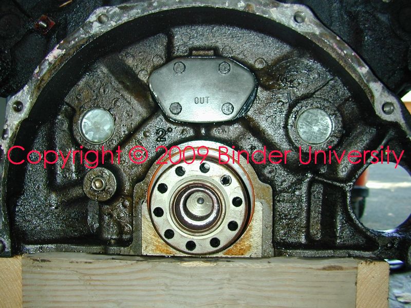

This shot shows rtv where it was used to install the cam plate on the rear of the block. Some dumfuck used only rtv instead of a gasket at this location!!!
Result...very restricted oil flow to the lifter galleries (thus extreme, random lifter collapse), rtv contamination throughout the lube passages, destruction of both rocker assemblies that were later rednecked into an unusable pile of crap, and eventual complete cam bearing failure while I watched!
