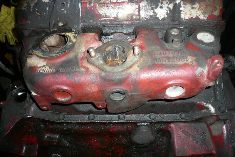

While waiting for paint ta dry on some distributors, I thought I'd play with my own stuff a bit.
Needed to clean up a lifter chamber cover and get it ready. So I robbed one that was a later model cover set up for a pcv connection off another engine that has seen some time underwater. Typical ratty po piece of crap!
The cover came off too easy! Normally takes a bunch of effort to unstick 'em. Ya can see in this shot that in the past, someone cut the connecting hose, even though all the pcv and manifold adapter for it were still in place, just had the hardened rubber hose sliced off.
__________________
http://vimeo.com/8149690
Old 05-23-2009, 02:16 PM   #57
Michael Mayben
Michael Mayben's Avatar
Join Date: Jan 2007
Member Number: 10
Location: Leaburg, Orygone
Age: 72
Posts: 7,156
Default Re: The Ultimate IH Fourbanger
The round fitting that is bolted to the cover connects to the pcv valve scruud into the intake manifold adapter.
Now ya can see why someone cut the hose...the sumbitch couldn't breathe!!!!
In all my years of scruuin' with motors, I've never seen one that has such a large breather passage that is totally sludged/clogged with no opening to the pcv! If ya just pulled periodic maintenance on this pcv, that would not have done nuthin' as far as allowin' the motor to breathe!!!
So this will be one more priceless part saved from the crusher.
