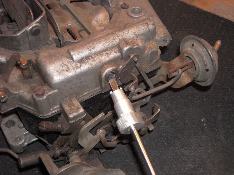

My .02. And I do not claim to be the "old pro" that mm surely is.
Pic #1: the secondary choke pull-off is missing the linkage. I know this really has little or no major effect on the normal operation of the carb.

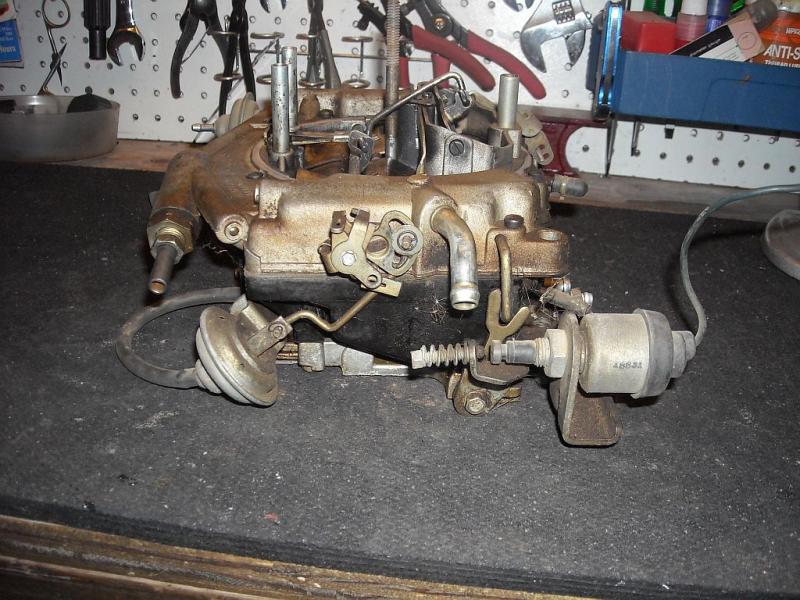

Pic #2: looks ok.
Pic #3: a. The primary choke pull-off link is not connected to the choke pull-off.
B. The divorced choke assy. Appears to be missing, or partially missing and not connected.
C. Is that a manual choke cable? It appears to not have a mount so that the inner cable has nothing to pull against, rendering it useless. I would delete that and get the likage connected properly and re-install the divorced choke stove assy. That what I did on my tq to alleviate the po manual choke that didn't work properly anyway.

All the choke things you mentioned are that way because I want to eliminate the chokes being the problem. The manual choke works as it should, believe me I have checked, it completely opens and closes.
