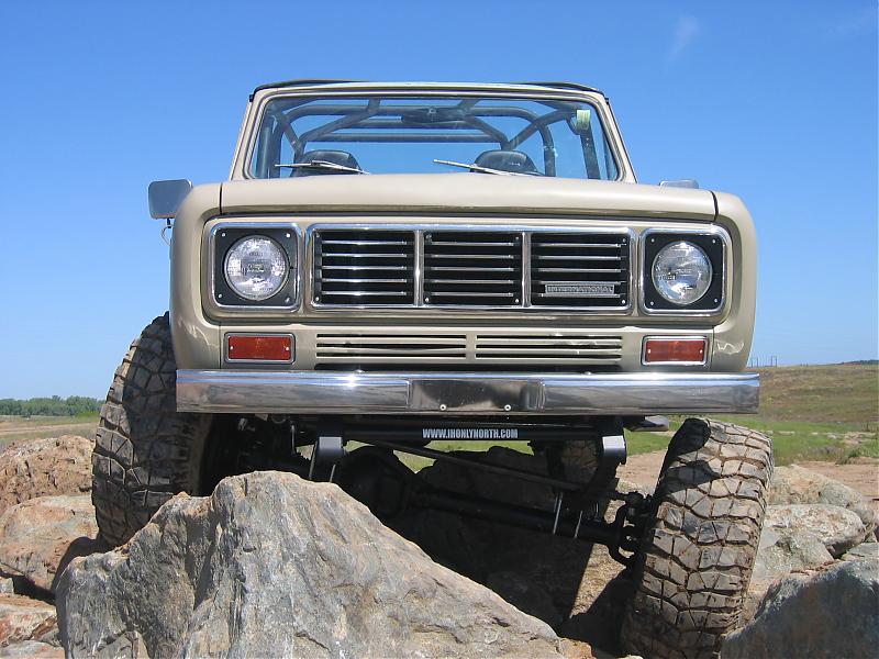

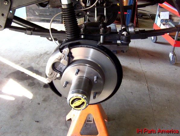

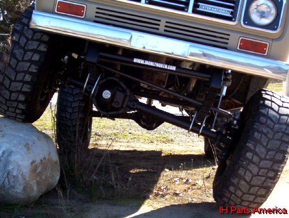

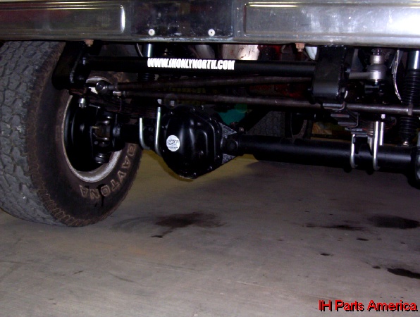

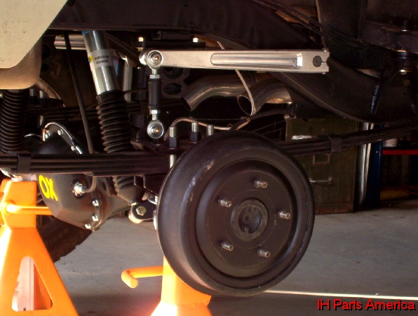

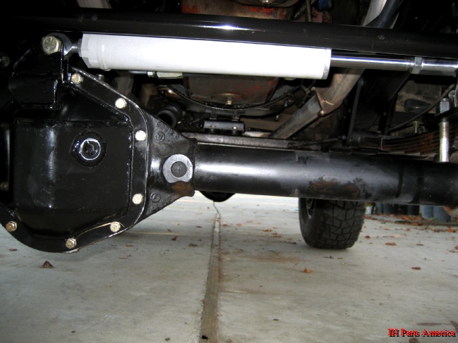

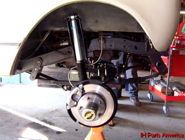

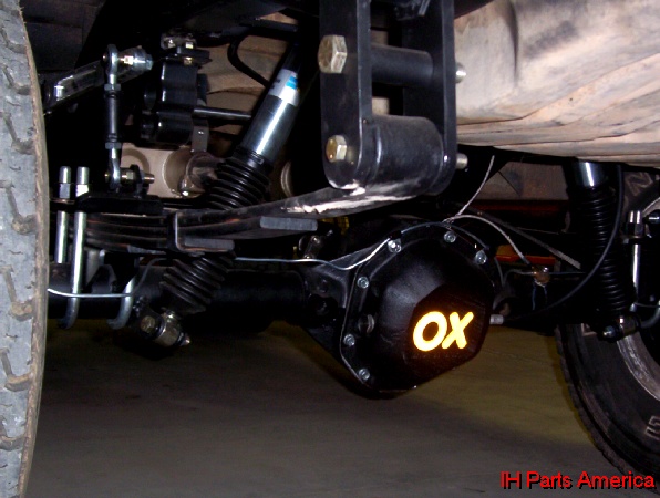

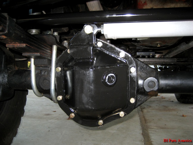

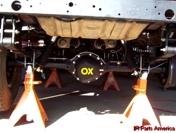

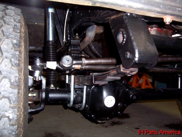

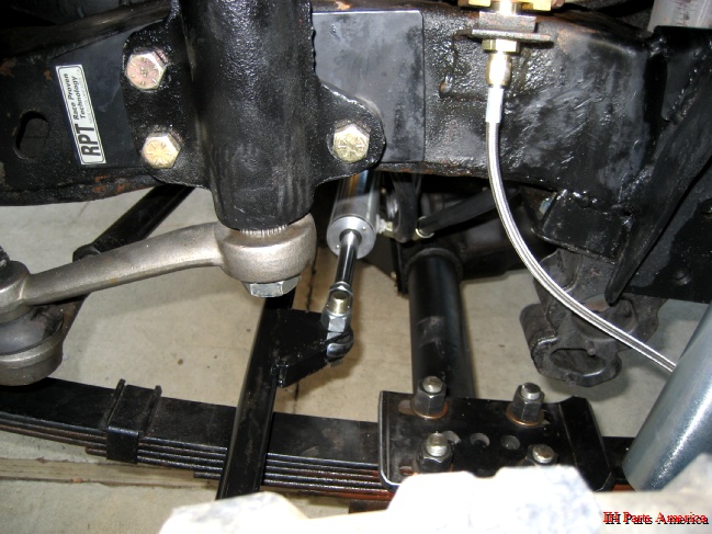

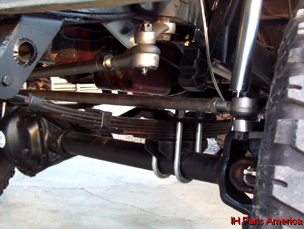

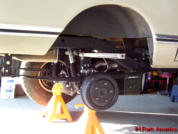

Thought I would post up some pics of a typical spring over axle conversion performed at IH Parts America. We almost always perform a reverse shackle conversion at the same time. These spring overs use all CPT products available on our online store.

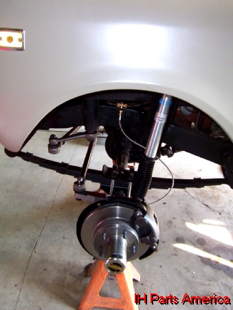

This particular build had an ox locker installed as well as a Chevy front brake conversion which is extremely stronger than the factory Scout disc brake setup(and cheaper).
Feel free to ask any questions.

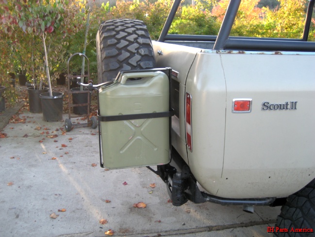

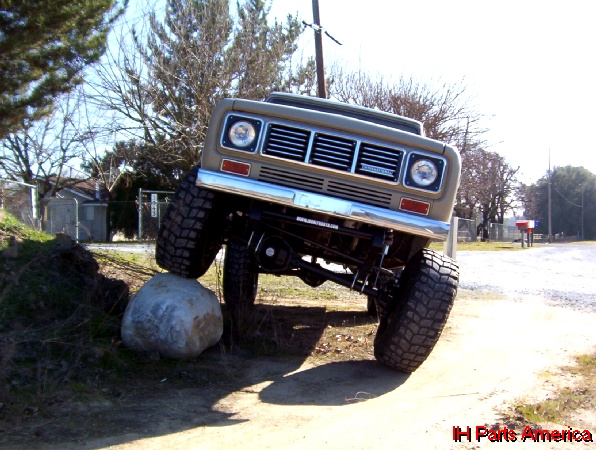

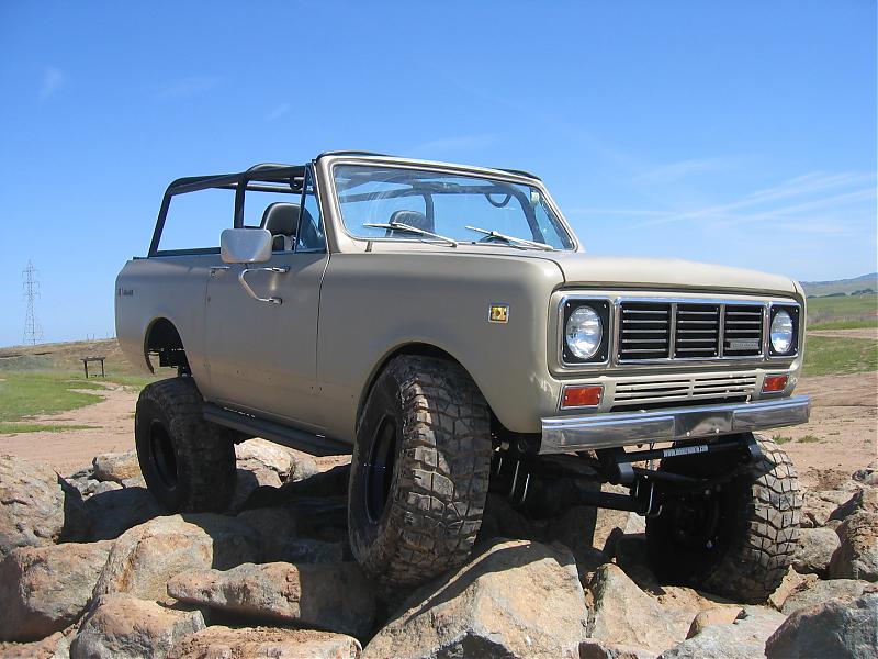

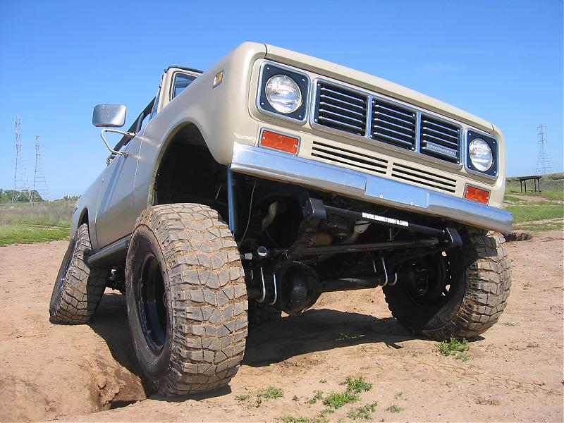

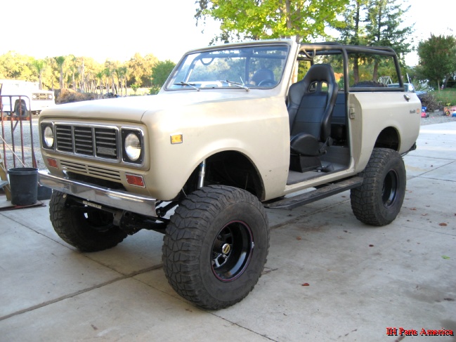

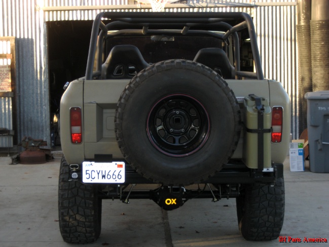

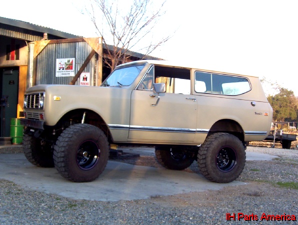

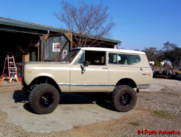

And here are some pics of the vehicle in general.

Been needing a push to SOA & you've pretty well convinced me to go highsteer instead of drop drag, I'm still not rs 'friendly' tho'. I do like the way the 'fangs' don't hang down, like some I've seen, and the fact you cross-brace 'em w/a tube.
What's the skinny on the bowtie brakes? How are they stronger? bigger piston bore & pad 'swept' area? We talkin' diy, on the brake install?

Chevy brakes are:
1. More common
2. Outer axle stub shafts are much stronger
3. Wheel bearing hubs are stronger
4. Spindles are stronger
5. Locking hubs are stronger as they are incased in steel(they sit inside the wheel bearing hub as opposed to Scout locking hubs which bolt on externally.)
a Chevy brake install is a do-it-yourself type project but you need to have 6 bolt knuckles otherwise you have to drill everything out to Scout 8 bolt type knuckles. When doing a SOA and installing the partsmike hysteer knuckles you have the option of Scout 8 bolt knuckles or Chevy 6 bolt.
__________________

nice f-ing work!!! Are those stock Scout II springs?

Thanks! Yes those are stock Scout II springs.

Those are 35s right?

Yes they are.

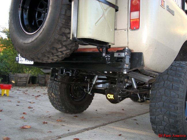

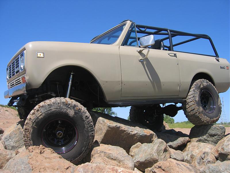

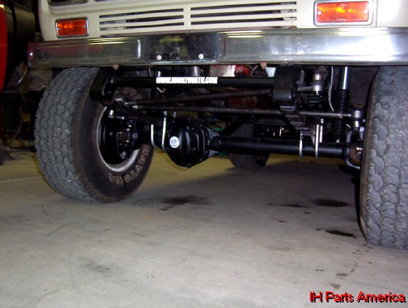

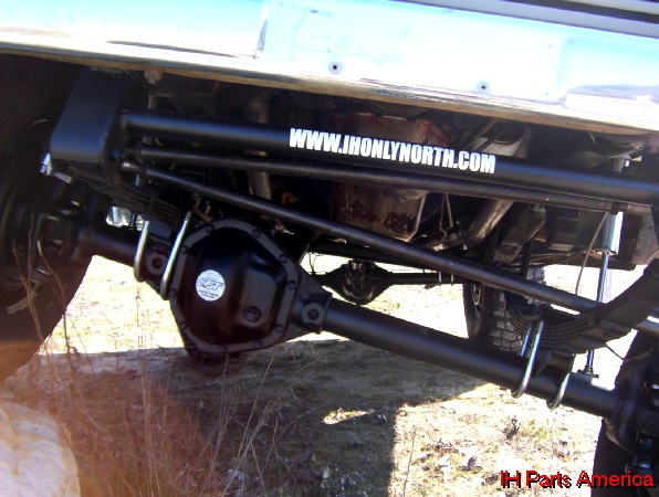

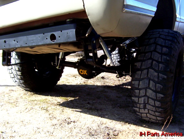

Here's a few more pics playing around.

I am curious about the cage kit on the Scout in the last series of pictures. Is that an IH Parts America item for sale or is it home made? I really like the design.
-dan
dlrecord is offline   Reply With Quote
Old 05-12-2007, 07:22 AM   #15
ihpartsjeff
Administrator & Owner
ihpartsjeff's Avatar
Join Date: Jan 2007
Member Number: 1
Location: Grass Valley, CA
Age: 44
Posts: 4,181
Default Re: Scout II SOA + R/S
Quote:
-dan
This cage was built by the owners neighbor. We can build one very similar to it. Please call for more info.
