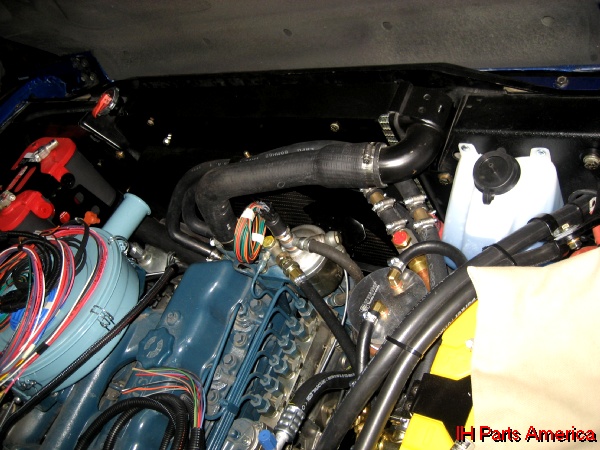

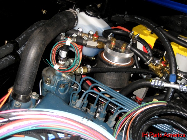

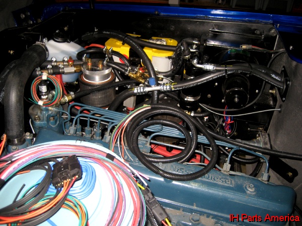

Work has continued on Steve's Scout.
The multi-fuel tank filter has a built in pre-heater and heat exchanger that is plumbed to the secondary multi-fuel tank.
Hydroboost brake booster along with a PSC remote reservoir for the power steering has been installed.
The main wiring harness and fuse panel was installed as well.
Here is the grease car brand aluminum multi-fuel tank plumbed and ready for install.
For the filtering of the diesel fuel from the primary fuel tank a Raycor fuel filter, heater & primer all-in-one with water sensor was installed.
A standard but tried and true Powermaster battery isolator was installed to keep the Optima batteries properly charged.

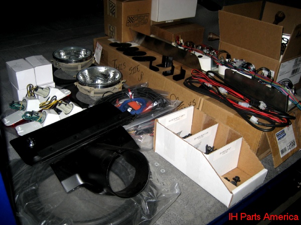

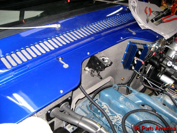

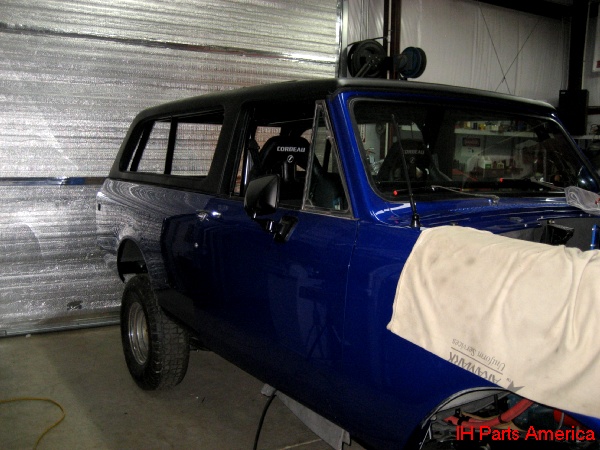

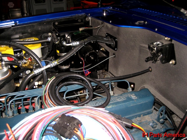

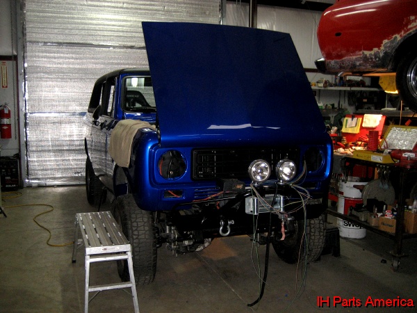

The front bumper got a quick sanding and a fresh coat of paint.
Hard top #1 was brought in and set in place.

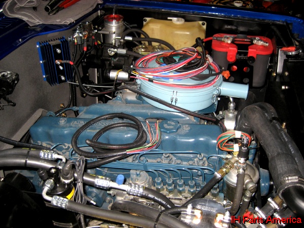

Wiring and plumbing of the various components has been on going.
As you can see it is a very busy engine compartment.
Many of the components to be installed are pre-assembled before installation is performed.

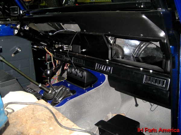

The AMA air conditioning system was installed under the dash.

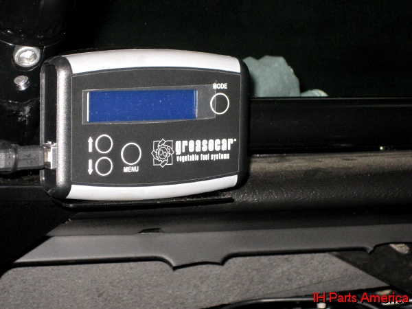

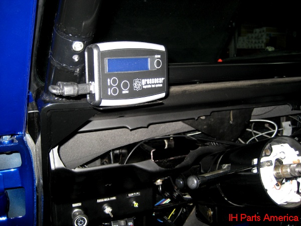

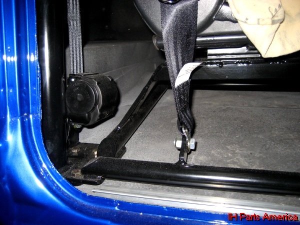

Modern shoulder style seat belts were installed to the cage.
The controller for the grease car system was also installed off of the roll cage dash bar.
A closer look at the controller.

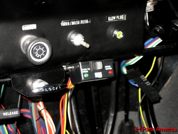

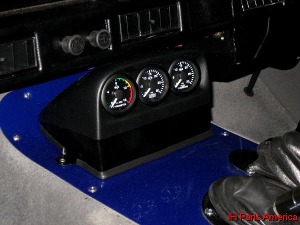

Darren assembled a custom three gauge pod for the mounting of a few extra gauges.
This switch controlled the diesel fuel filter primer/heater control.

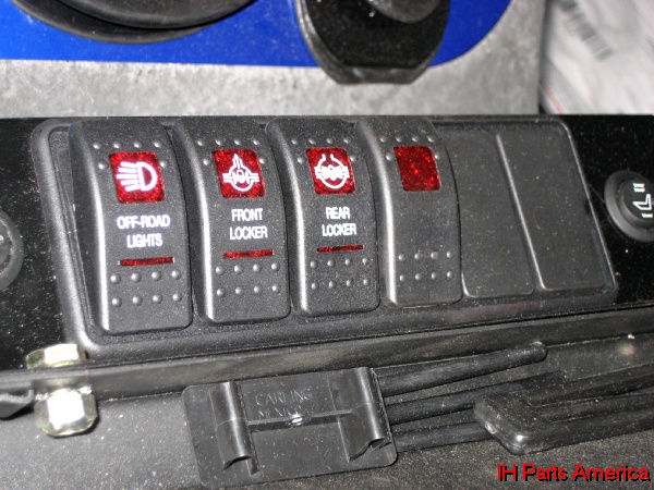

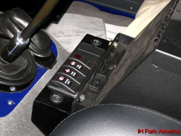

Darren also fabricated a custom switch panel that mounted directly to the Tuffy center console.
A little closer look at the switch panel.
