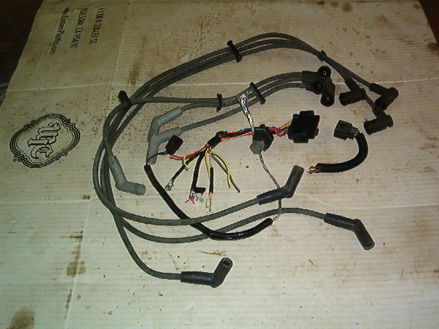

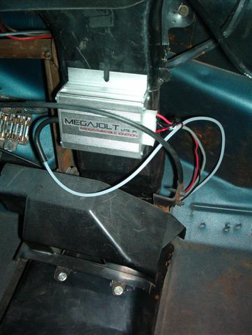

Attached are pictures of the edis components you'll need. For my first setup, I went to ebay and bought a "kit" put together from salvaged parts. You typically get a trigger wheel, the ignition driver, and the coil pack, along with spark plug wiring, and harness plug ends for the coil pack, driver, and pick-up sensor. The parts pictured are for a six, and a four is just more of the same but with two fewer terminals, of course. For my Scout, I simply went to picnpull and grabbed these same parts from a 1993 Ford escort four-cylinder, but passed on the crankshaft trigger wheel, as I went in a different direction. I'll post those pics in the next post. Picture 009.jpg

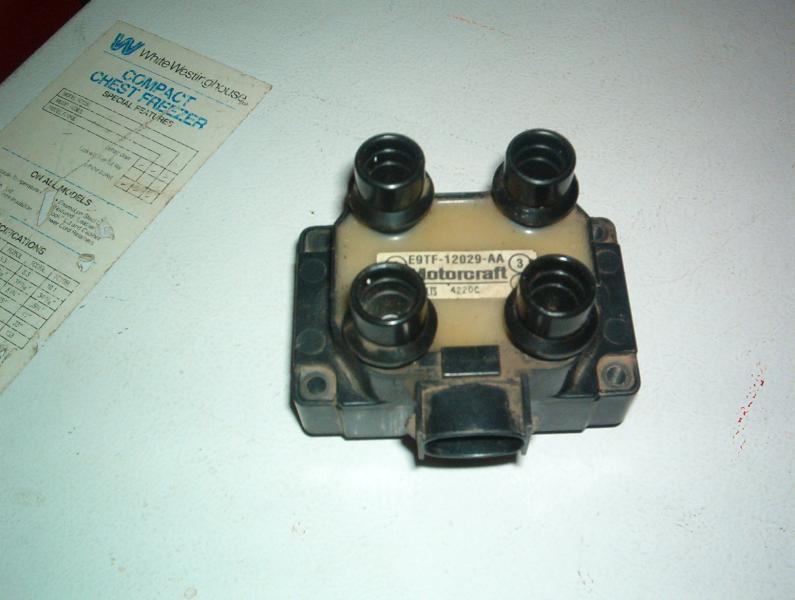

The first thing you need are the components. I went to picnpull and found the endless lines of Ford products. What you want are the edis parts from an early '90s series. In my case, I ended up getting the parts from a 1993 escort w/four cylinder. I think pnp charged me $45 for all the parts I nabbed. I think it is always good to get the vin from the donor vehicle so that if you need to replace the coil or control module, you can act like you actually have a vehicle in mind when you go to napa or o'reilly's. These parts are fairly generic within the Ford line, but nonetheless, it's good information.
You will end up with an ignition coil pack. In our case, this will have four terminals with the early-style locking ribs, although there are only two coils beneath it all. That's because this system is wasted-spark, I.e., each coil fires both plugs on the other end of the wires plugged into it. One of these plugs will be the cylinder you have in mind, the other will be on the exhaust stroke of another one, hence "wasted spark". The Ford coils are good but you can upgrade if you wish, to an accel or msd variant. Those run about $90 and put out 40,000 volts. I think the stock unit is around 30,000 volts (these are $50 new). But whichever, the spark energy is much better than whatever came originally on any Scout. You will also grab the matching connector plug for the coil pack. Snip off as much wiring as you can get. It will have three wires - one is the power (12 ga, I think), and two smaller wires - one for each coil. Be certain to grab the mounting bracket and screws, not just the coil pack!
You will also need the "ignition control module". I call it the "driver", for short. This thing is the interface between the coil pack and the computer that originally ran the car. The driver is pricey if you need to replace it (about $130). You need the connector plug for the driver. Cut off as much wiring as you can get.
Pick-up sensor. Officially called the "camshaft sensor". This part can be a pain to get off a car, as is its connector. Do what you can, but you May also do what I ended up doing anyway - getting new parts. If you mount the pick-up sensor the way I did - which tucks it neatly behind the crankshaft pulley and in front of the timing gear cover (see pictures), you want the one that bolts flat against the bracket as shown in my picture, and the connector tips forward 45 degrees. That is napa ech css400. It was only $21. There are many variations on these sensors and they look similar, so be sure to get the one you see here! Another reason to go new is that if you have to replace a twenty year old part, well, look at the front of an IH i4 or sv and tell me what that will involve...

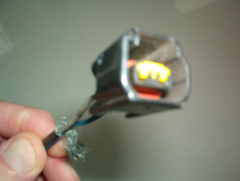

The new connector - which I highly recommend because all that I've ever pulled off were heat embrittled and the little locking tab thingy snaps off. This connector is napa ech 252 or o'reilly's pt 5742. Napa wanted $29, o'reilly's $21, and the napa guy matched their price. If you go new from the outset, still grab the original plug and as much of the wiring from the donor, because this wiring is shielded. The replacement connectors don't have the shielding (mesh stuff). You can transfer it over, or do what I did with tinfoil (more on that later).

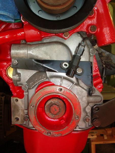

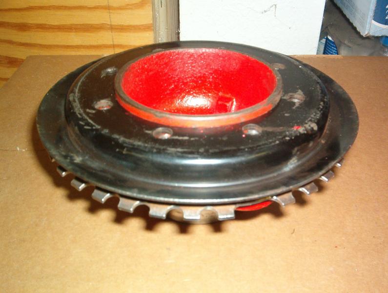

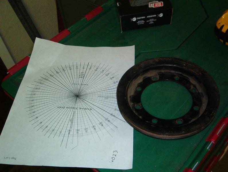

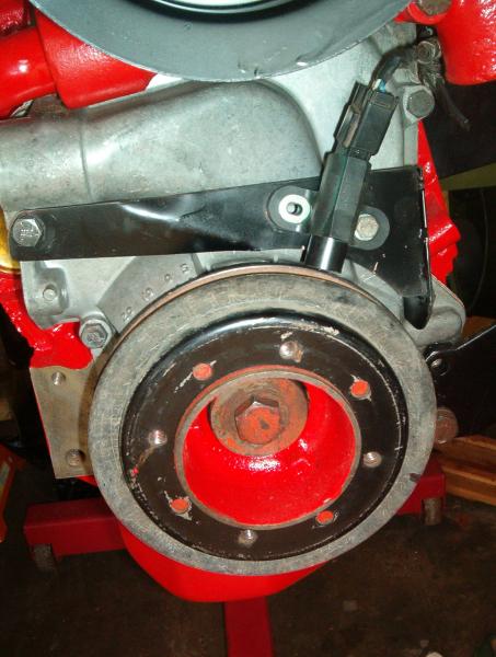

I got lucky when it came to the trigger wheel. I purchased an aftermarket wheel, and thought I'd machine a mounting disc from aluminum like I did with my corvair. I began doing this and didn't like the way it was going, and then one night while viewing the posts on the autosports lab site (the megajolt site), saw where a guy with a sbc posted pics of how he hand-cut teeth on a pulley, using a hand grinder. He printed out a degree wheel on paper with marks every five degrees, and taped this to his pulley, and carefully ground the slots. Brilliant! The IH four uses a similar setup, sheaves stacked onto a crankshaft hub. There are three types of sheaves - deep offset, shallow offset, and flat. It turned out that turning the shallow offset pulley around put the sheave behind the hub's mounting flange. Perfect! And because I didn't want to go to a lot of work hand-grinding slots and not get them right, I discovered that autosports lab had a recommended machinist to custom fab trigger wheels. I marked out what I needed on the IH sheave, mailed it to them, and it came back a little more than a week later. For $100, I consider it money well spent.

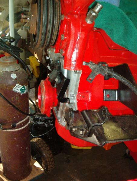

So...exactly where to cut out the missing tooth. From the pictures, you'll see that I mounted the hub onto the crankshaft, and then fashioned my mounting bracket and mounted the sensor. I then placed the sheave into place and adjusted things to where there will be a running clearance of about 1 mm between the edge of the sheave (soon to be teeth), and the flat end of the sensor. The gap was about the thickness of a blade for a utility knife.
Since this is a four-cylinder, megajolt needs to know 90 degrees before tdc, when to initiate the ignition sequence. So what we do is put the #1 cylinder at tdc, and then line up the mounting holes in the sheave, with those on the pulley. There are four mounting holes on the pulley hub, and eight on the sheave. Go ahead and line up the sheave as if you were going to mount it for service, and screw in two opposing 5/16" bolts so it bolts up flat and even. Now carefully locate the centerline of the sensor. If you look at the end of the sensor you'll see a small circular area. Dead center is the centerline. Transfer this imaginary line onto the edge of the pulley. Scribe a line here. This spot will be the center of what will be the missing tooth. After this spot has been determined and marked, carefully unbolt the sheave and rotate it clockwise 90 degrees. Do not let the crankshaft rotate when you do this. In our case, a particular hole on the pulley will simply move to the next hole on the pulley hub. Bolt it down again. This is now the permanent orientation of this sheave - which will be machined for teeth - to the pulley hub. Somehow Mark a particular hole in the sheave with its mate on the hub so it can be reinstalled in this same orientation later on.
What you will have is a tooth five degrees wide with a gap five degrees wide. The Mark you carefully made on the edge of the pulley will be the center of this five degree wide tooth. If you use miller's mule, just tell the machinist this and that the center of the missing tooth is marked by a small line. If you use someone else, you need to explain this to them.

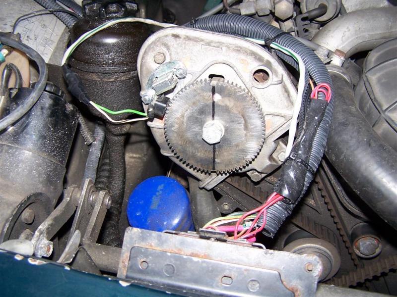

It looks doable. This is on a 924 porsche. Apparently this trigger wheel was an off-the-shelf part from mcmaster-carr. It's 72 teeth with the two opposing teeth ground out. Pick up coil is from a mazda rx-7, but it drives the mjlt. Adapting it to the top of an IH distributor shouldn't be all that difficult. Just a place to begin applying the efforts of all your brain cells. :d
so let's assume you had mounted a wheel like this on an IH distributor base, and fixed the rx-7 pick-up coil to an appropriate location. For the sv8, you'd turn the engine over until you reach tdc for #8, and on this small trigger wheel, line up the center of the missing tooth (any missing tooth) to the small linear metal piece in the pick-up coil, and then rotate in the direction of distributor rotation (still clockwise, right?) five teeth after that. For a four-cylinder, you'd rotate #1 to tdc, position to the center of a missing tooth, and then continue rotating nine teeth in that same direction of rotation. Then lock the toothed wheel onto the shaft, however that would have to be done.

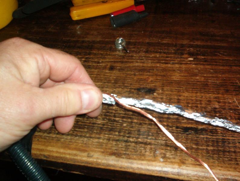

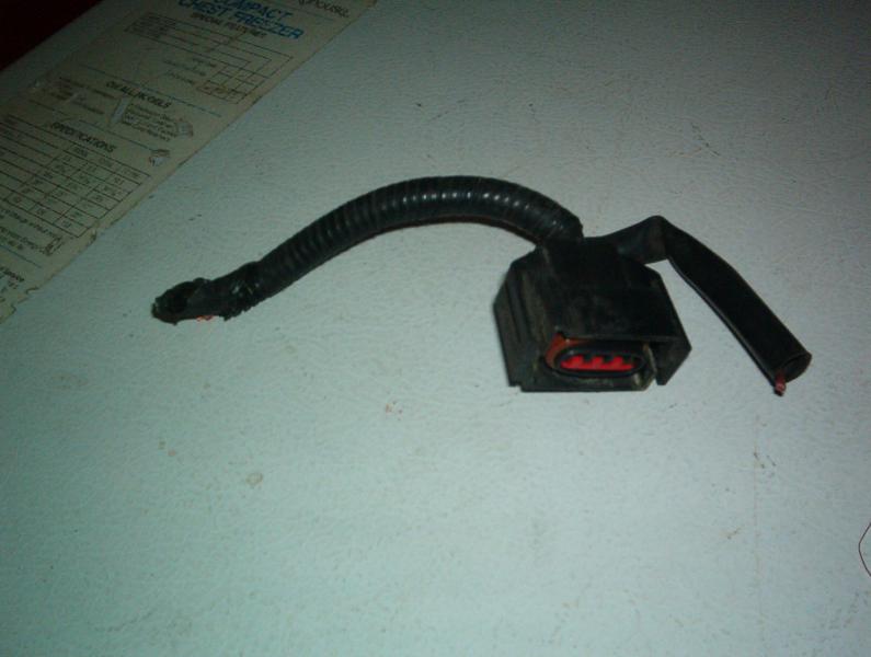

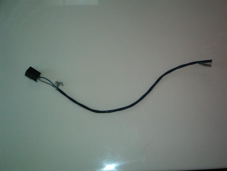

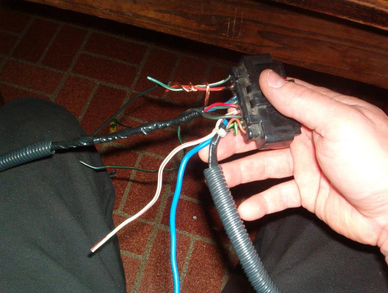

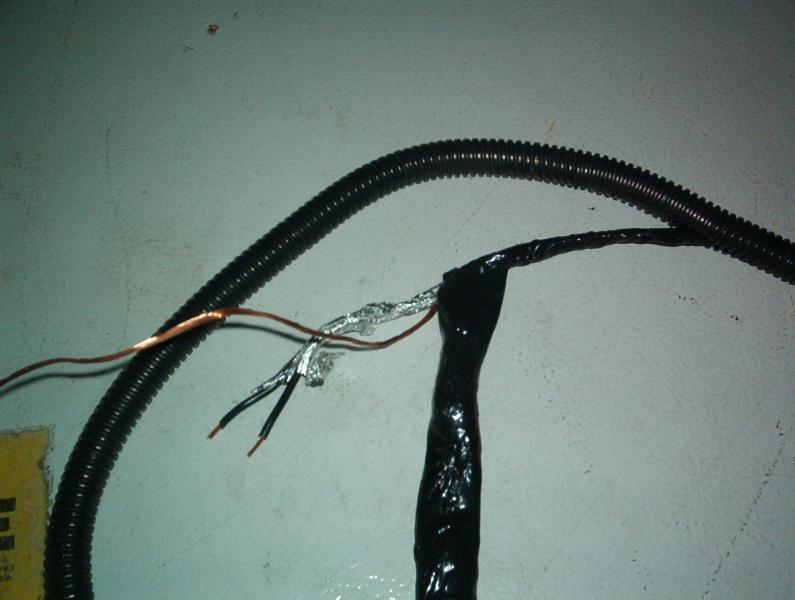

Here are some pics of my beginning to fab a custom wiring harness. In one picture you see how I took a new pick-up sensor pigtail and extended it by splicing in two matching wires to reach the driver plug. Length between plastic plugs is around 35", so cut and solder in, to suit. But as mentioned earlier, the lead from the sensor to the driver plug is shielded. The new pigtail is simply two leads. What to do? Simple. Go to your kitchen drawer and tear off a piece of aluminum foil. Look at the picture to see the construction from the inside out: two wires, wrapped with tinfoil, wrapped from the sensor end with a lazy spiral of some 16 gauge wire strands obtained by stripping about three feet of wire. Then wrapping with loom tape, and finally the corrugated 3/8" loom. Note: these leads go to the edis driver, wire positions 5 & 6. These leads are polarized, I.e., one is marked +. You can sort this out with an ohmmeter for certainty if you either 1) have the original pigtail and trace the appropriately colored wires back to their respective sources on the edis driver plug, or 2) go to the autosportlabs website and print out the wonderful wiring diagram just for this purpose. (I've attached this pic in the next post). The shielding is grounded (through the spiral winding) by connecting to wire position 7, which is a ground. Later, I'll "jumper" this shielding ground over to the shielding that covers wire positions 1 & 3 which are the pip and saw shielded leads that then go the the mjlt itself. For this wire bundle (two leads covered with shielding), I resort to the security wire I bought at hd. The shielding for these two wires will be connected and grounded to the shielding for the bundle comprised of positions 5 & 6. It's not that complicated, really! In a nutshell, the shielding all connects and is connected to ground.
I apologize for the poor quality of the pictures.
I hope to finish the driver end of the plug in the next few days.
Fabbing your own custom wiring harness is easy once you have the plug ends. Shielding for the lead to the sensor (#5 & #6) and for pip and saw (#1 & #3) can be done in aluminum foil, although any suitable shielded wiring can be substituted. The shielding is all grounded together to #7, and then connected to the master ground lead shown in this diagram (#9). The mjlt module has a 12 v power input and a ground lead. It is strongly advised to tie this ground lead to the ground lead (#9) for the edis. This is then grounded to the engine block; I always include the body as well.
