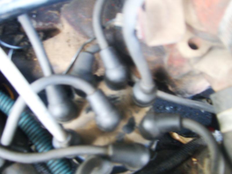

Thanks I just checked the plugs and all have fire using the old autolite plugs,so we put them back in and still same results! I think a restab is in order, never done it on an IH,but willing to try here are a couple of pics of dizzy #8 is the grey plug wire for reference to how the rotor is for #8

It makes absolutly no difference where the dizzy is stabbed or clocked ....
Only that you install the #8 plug wire on the cap tower that the rotor is lined up with when the engine is at tdc (compression stroke) of #8.. The rotor turns cw so place the wired according ly using the firing order 1-8-4-3-6-5-7-2. Use the timing marks on the front cover and crank hub to exact the tdc alignment... I would bet a dollar the wire order is wrong.
Cmiiar but the gold box was a Holley ignition system only accessory... Are you sure you have the correct cap?
