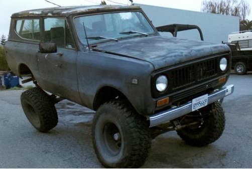

Well, this is the latest addition to my fleet of Scout II's. It's a 73. Origanally it was a later model year when it rolled off the manufacturing line, but I'm all good with it now for being a 73, since I dont have to deal with the ole smog crapola out here in califunkia. It does have a 345 with the auto 727 in it. It is sprung over, along with a Ford 9 inch in the rear and disk brakes and a Dana 44 front with disks. Although, who ever did the work on the front end for the SOA, did a piss poor job in the welding. The booger welds almost doesn't look safe. I won't know how bad it is until I actually pull it out, for a possible gear change to match the rear. It's also sitting on 35" shoes with a 2" body lift.
Here's a couple pics of before I got it:

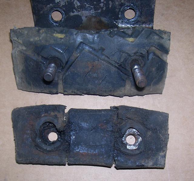

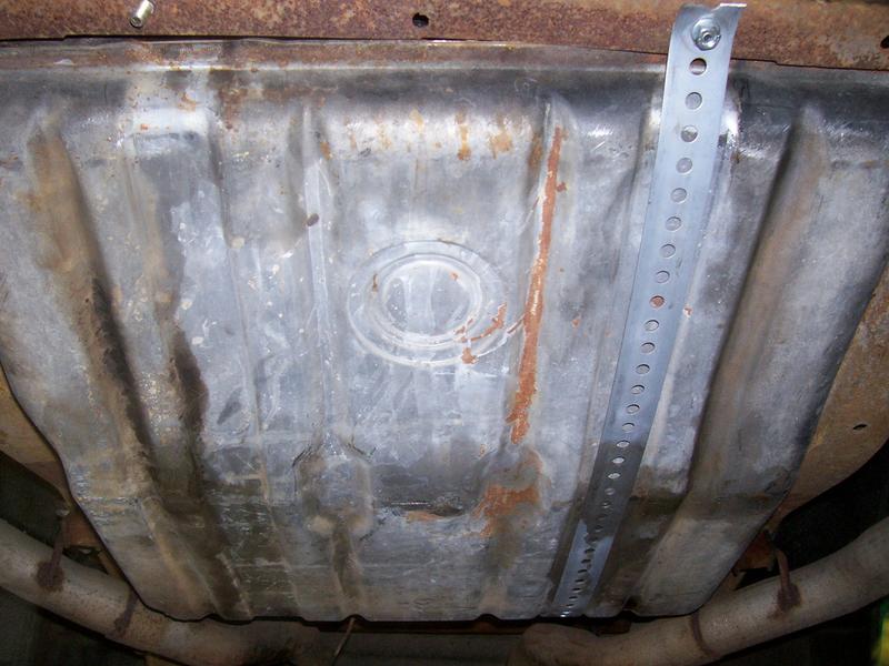

I forgot to mention in my first post, that before I did any of the other maintenance stuff, I had to address the gas tank issue. Issue being that when I topped off for the drive home, on the day of purchase, about a gallon or two poured out the two vent tubes on top of the front part of the tank. They were not plugged off, and one of the vent tubes was so loose that it was about to come out. Plus, the tank was being held in place by only one strap. So I swapped tanks from my barrel rolled 74 Scout that was in good condition. And I had a spare set of stock straps here on the shelf for mounting the tank. Plus, the sending unit in the old tank did not have the sock filter attached to the fuel pick up tube inside the tank. Here's the shot of before the swap:
Name:  Gas tank mounted.jpg
Another thing I did while I was underneath the beast dealing with the tank, was to replace the transmission mount. I installed the CPT trans mount, which I robbed from my barrel rolled 74 Scout. The old mount was so rotton, that I'm surpised it held up at all. What made it even worse, is that half of the old rubber looks like old tire tread that was cut to fit
Name:  Old Trans Mount.jpg

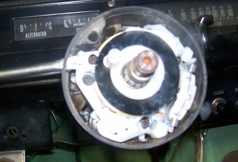

Last weekend I worked on turn signal switch in the column. The wiring seemed to be original and getten fairly brittle. And the signal switch was not returning back after completing a turn. So, with parts purchased from ihon, it was all replaced and fixed. Although, while I was taking out all the old guts og signal plastic unit out of the column, these bearings were rolling out of the column onto the floor:
It all works like it's suposed to. And here is after installing the new parts:

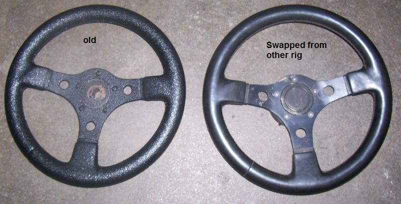

Today, since I had a change of plans, and had some spare time, I swapped steering wheels from my barrel rolled 74 Scout. Granted, both wheels are identical, but the old one was coated with bed liner. And I didn't care for it much. Not only that, I wanted to be able to utilize the grant steering wheel locking option I had readily available.
Name:  Grant - steering wheel.jpg
And here's the installed locking unit:
Name:  Grant - Steering lock.JPG

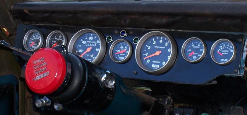

Steering wheel off I can put the cap on in its place to complete the lock. The way I figure it, is that this is like the best deterent in a theft of this rig. If the steering wheel is not there, how is the thief gonna drive off with my rig.
Oh - here's what it looks like when locked cap is on:
Name:  New Dash & Gauges1.jpg

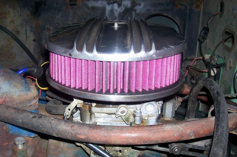

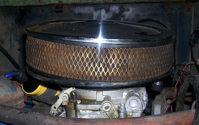

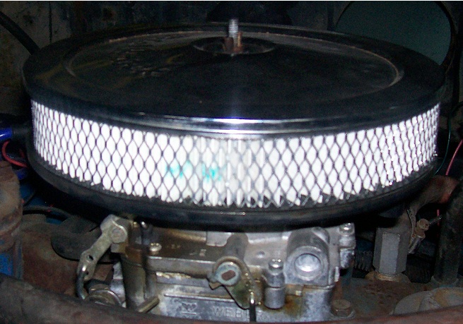

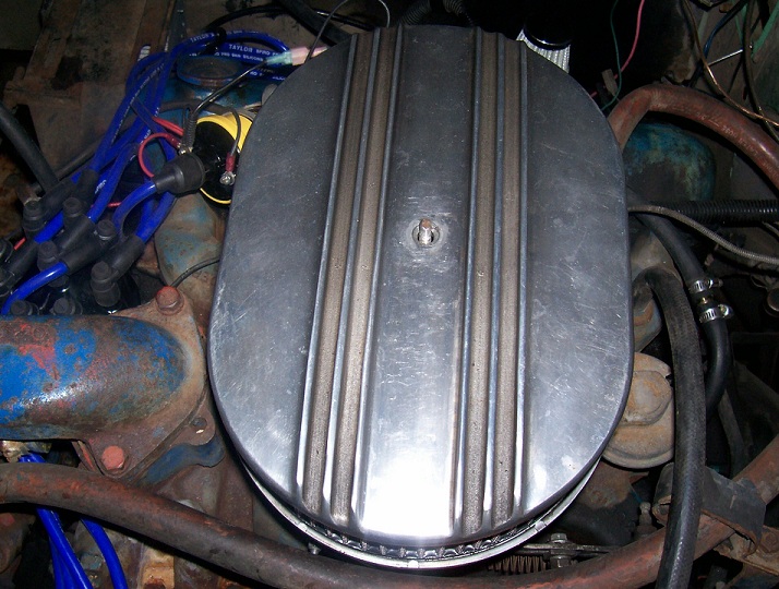

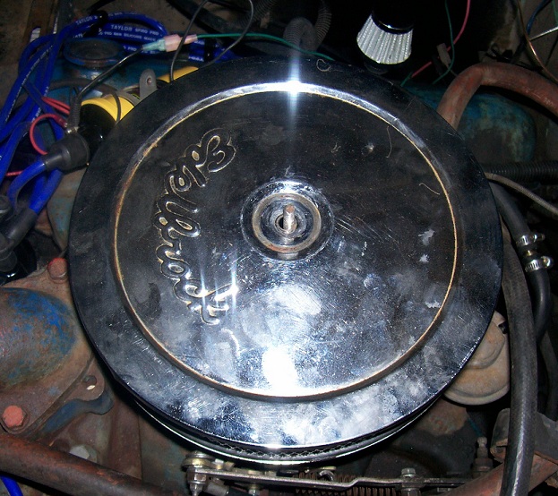

Well - one of the maintenance issues that go along with these old rigs that we love so much, is that I finally got around to dealing with the much neglected air cleaner. It was so bad that even the rats would run from it. I wanted to use the one I had from my 74. But it kinda melted when left over fuel from carb and fuel hoses caught fire. In the last couple weeks, I recently had to order a new element for what I wanted to use, but takes awhile to get. In the mean time, while playing the waiting game, I was able to get a new replacement paper element to get rid of the ole crapola. Finally, after using the temporary new paper element for over a week, my new element came in today. now it's time for a drive
Name:  old air filter.JPG
Name:  old round filter cover.JPG
Name:  Temporary air filter element.JPG
Name:  new air filter.jpg
Name:  new filter oval cover.JPG

Yea - when I saw the ole crap of tire tread for the trans mount, I just shook my head in amazement. That's something that the hoodlem cheap bastards in my area would do.
I had the CPT trans mount, that I purchased from ihon, in my barrel rolled Scout, and just swaped it over
the engine oil did look fresh, but I changed it anyways. Plus, I also recently changed the transmision filter and oil. The oil in the trans smelled a little burnt and the filter was just as dirty. Had a very slight matalic residue, when I pulled the pan. Looked more like band wear, which seemed almost normal

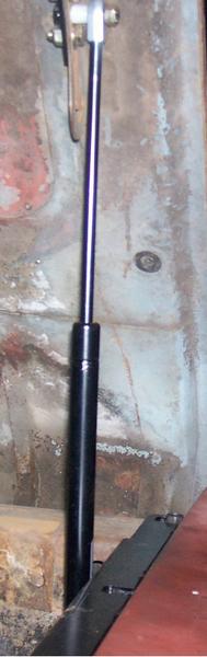

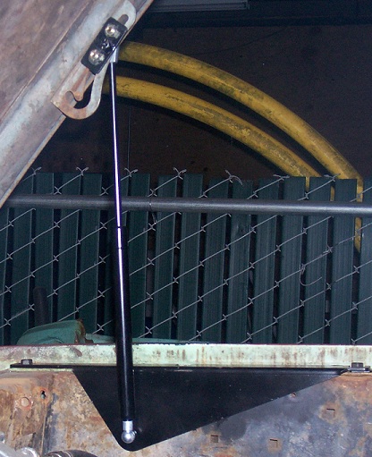

Yesterday, I took the time to install the hood strut kit. Easiest upgrade install known to man. Took all of 5 minutes. Compliments to Jeff once again - thank you
So much easier to lift up the hood. And ya don't even have to go to the passenger side to let the hood down

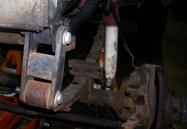

Got started working on a shackle reversal kit yesterday. I had the kit sitting on the shelf for a couple years, that was ear marked for my 72. But that project is on hold for now, so I decided to install this kit into my current beast.
As I was tearing through it, to my suprise, one of the previous owners had installed urethane bushings in the leaf springs. Also, noticed that the front left bushing is a little chewed up from what ever happened in the past.
These are the front shackles I took off in order to mount the fangs for the shackle reversal
Name:  Shackle - Front Left.JPG

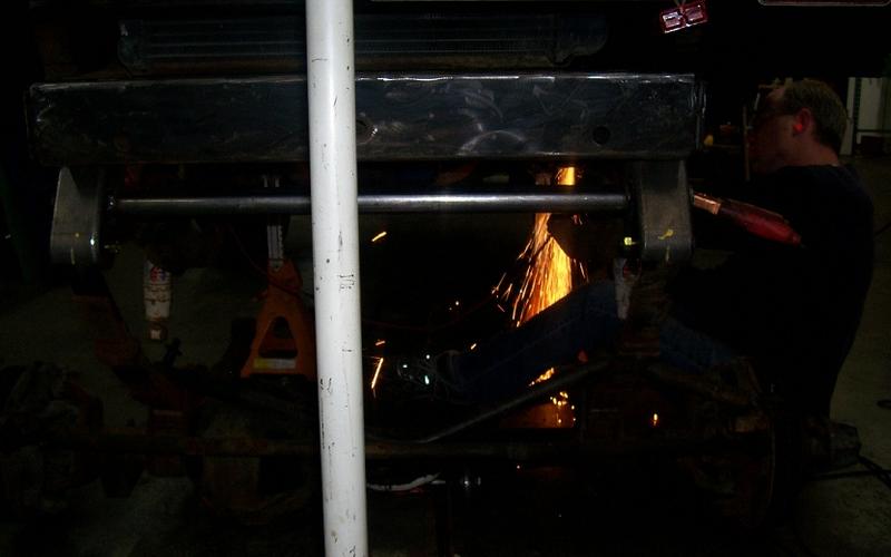

After getting the fangs mounted with some good tack welds, we moved onto plasma cutting off the rear leaf spring hangers and cleaning up left over bugger welds
Name:  Andy getting ready for grinding.JPG
Name:  Andy at the grinder.jpg
Still need to get the proper angle for new shackles, then drill through the frame with hole saw for the sleeves that came with the kit. Then 100% welding will be done on fangs & sleeves, once they are in place.

I noticed the shock mounts when I got it also theay look like there for a much larger axle tube like a 60 or 14 bolt lol

While I was setting up to set the shackle angle I figured I post this shot of tires being temporarily mounted to get all the weight onto leaf springs.
Hopefully, by this evening, I will have holes drilled through frame and the sleeves welded in. Along with the shackles with the new bushings installed

You've got the *little* grant formula gt steering wheel (13" dia). Grant offers the same style in a 15" wheel (the #1770), which feels more like the rallye option steering wheel used on late-model Scout iis. I had a 13" grant and changed to a 15". The 13-incher felt like it shoulda been on a slammed '64 chebby impala...
Quote:
Originally Posted by scooter View Post
today, since I had a change of plans, and had some spare time, I swapped steering wheels from my barrel rolled 74 Scout. Granted, both wheels are identical, but the old one was coated with bed liner. And I didn't care for it much. Not only that, I wanted to be able to utilize the grant steering wheel locking option I had readily available.
__________________
