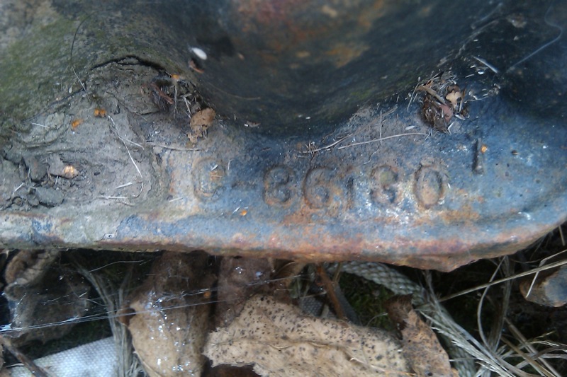

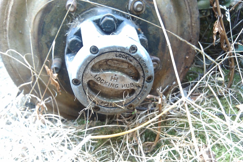

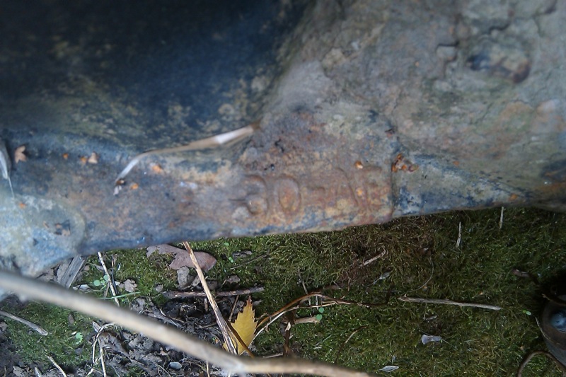

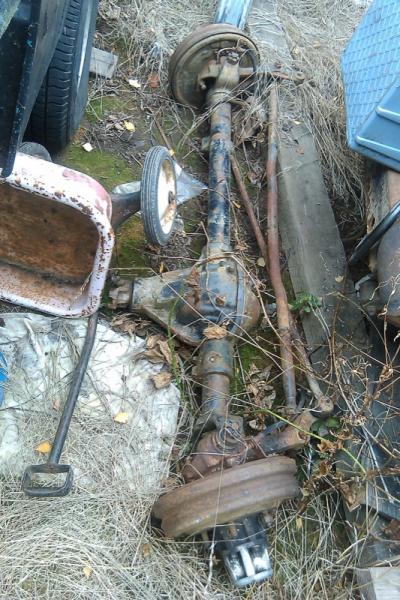

I have a front end off an International that I am trying to get rid of. I have no idea what the gearing is or anything like that. It is stamped on the housing with c-36130.
I have also attached a few pictures of the front end. Any one have a guess at what this is?

Someone had posted this link A while back that May help. You'll need to scrape down to the stamps.

That's a drum brake Dana 30 from a 72'-73' Scout II.
