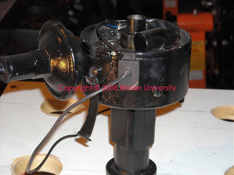

Another shot of the delco unit for an sv application, this one ahs the earlier style point and condenser set that were separate items and could be replaced individually.
The 2nd gen design of the delco unit used a "uniset" point/condenser combo which eliminated the separate electrical components, and combined 'em into a single part that was much easier/quicker to service. The uniset assembly can easily backfit into the earlier distributor with no difference in dwell adjustment procedure.
There is no difference between the unisets used on I-4 apps as compared to the sv, they are the same part. And...an sv distributor cap May be used on an I-4 distributor, but it's best to blank off the unused plug wire terminals using some sort of rubber plug.
Because the mechanical advance assembly is located under the rotor, it's very accessible for diddlin' with changes in the advance curve.
This unit is easily adapted to an electronic trigger by using either a variation of the pertronix unit, or even better, using a crane xri conversion unit. The advantage to the crane unit is that is is a "lobe sensor" technology and does not require a separate rotating magnet system attached to the breaker point cam or rotor as does the pertronix.

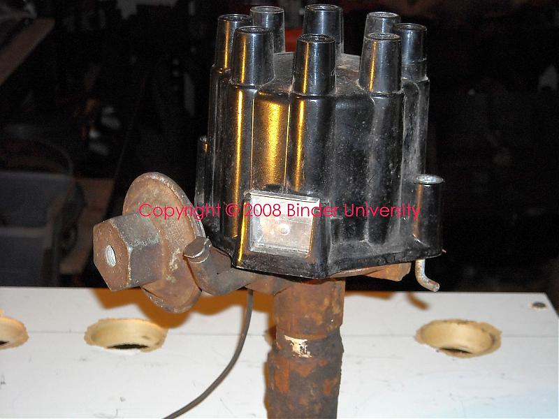

This shot is a prestolite breaker point distributor. Aluminum body but the breaker system and shape of the body is completely different as compared to a Holley distributor.
Notice the square shape to the lower main body, and the large "hex" nut on the vacuum advance can, those are dead giveaways to this being a prestolite unit.
A prestolite distributor (either breaker point or electronic) used a cap with male terminals. Some folks mistakenly attempt to install a Holley cap onna prestolite or vice versa. It will not work properly! The prestolite cap is too loose to locate and index correctly on the Holley distributor.
The Holley cap is a force fit on a prestolite and will also not be indexed properly, and could easily crack when force is applied to make it fit.
