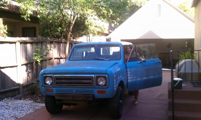

Here is my Christmas gift from my wife, not my prom date. Needless to say it is one of the best gifts ever!!

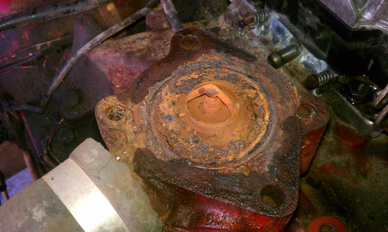

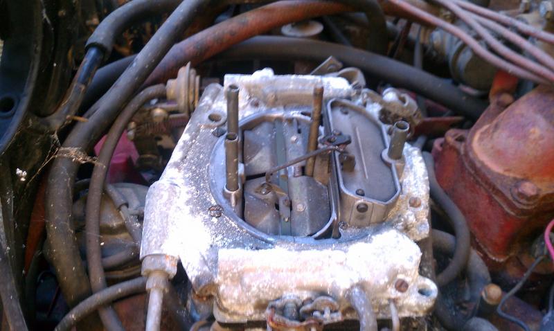

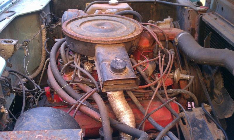

Finally got the beast towed home from placerville. It's a little more beat up then I had previously thought. But still worth the $500. Especially since it has a clean title. Oil in the 345 looks good. I will be changing out the plugs and wires this weekend in hopes that I can fire this thing up and see how it runs. Hasn't been started in 5 years says the po. Wiring in the engine bay looks a little shotty.
Anyone know what all the white stuff is caked around my carb?

Quote:
Corrosion. Your carter thermo-quad carburator has an aluminum throttle body (base) & metering cover (top). Aluminum does not rust, but it does corrode.
You can be sure the interior of your carb is just as bad looking.

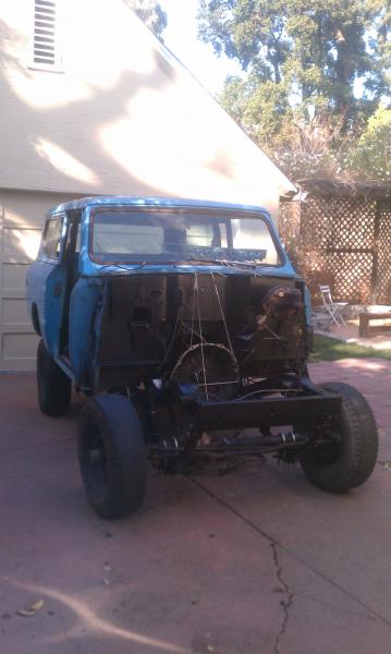

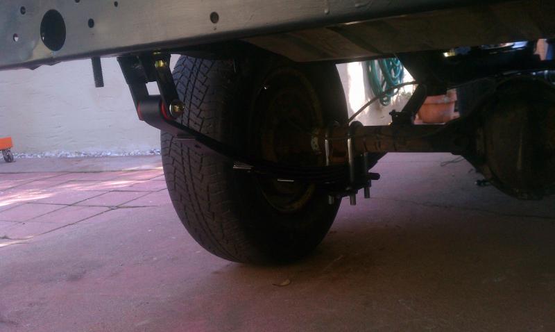

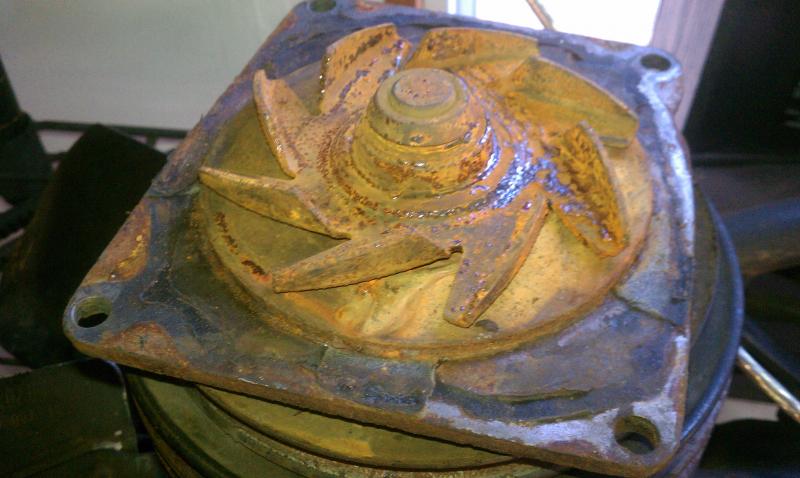

Haven't updated in awhile so here it goes:
changed the oil and all was well but did notice that the radiator was bone dry. Not worried though because it sat for so long. Followed the instructions on Maybens old iron doc and had both rockers oiling well. Buttoned her all back up and put some water in the radiator. Uh oh, tons of water coming out underneath. Never even occured to me to check the freeze plugs. Easy fix though because the one behind the starter was completely missing. Much easier to replace when you don't have to pull it out. So more water into the radiator. Damn, more water coming out. This time from the drivers side. Not so lucky here though. Two rusted out freeze plugs on this side. To get to the front one I needed to remove the oil filter. Here is where things go wrong. As I am loosening the filter I notice some water coming out of the filter. Hmmm, that's interesting. I decide that I would loosen the drain plug before pulling the filter to see if there is also water in the oil pan. You bet there is and lots of it. Well, there goes my plans of getting this thing running and playing with the suspension first. Probably for the better though. I've since pulled off all the engine accesories and found a ton of rust all throughout the cooling system. I've added a couple pics of what I found under the surface.

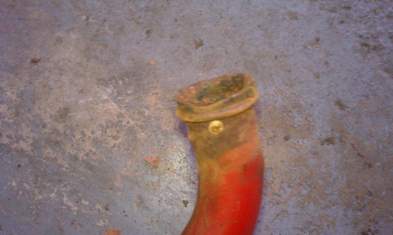

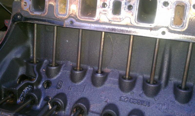

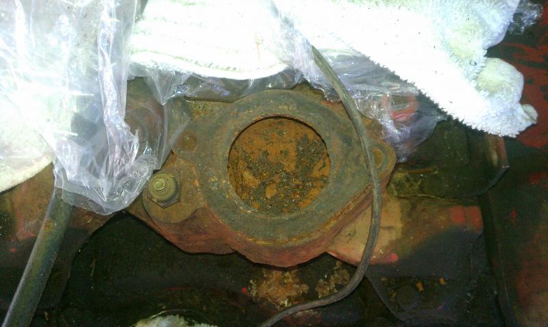

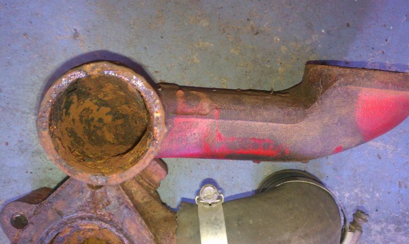

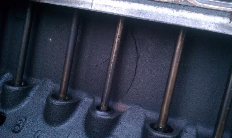

Update on the old beat up engine that was leaking water into the pan. Pulled the valley pan and found a huge crack in the block. Time to find a new block.

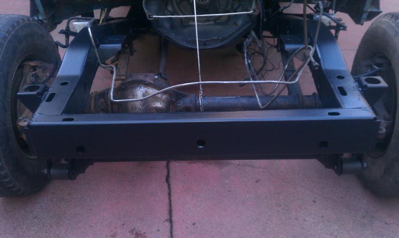

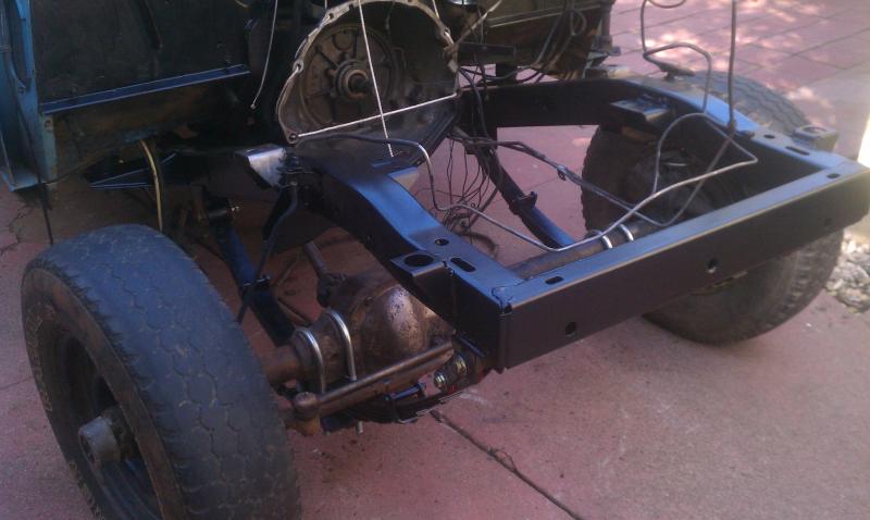

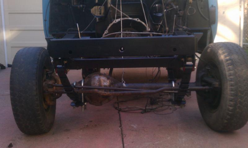

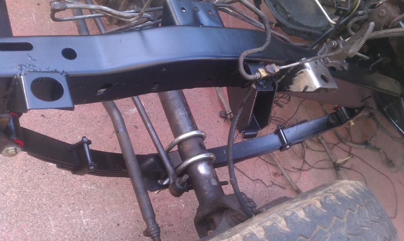

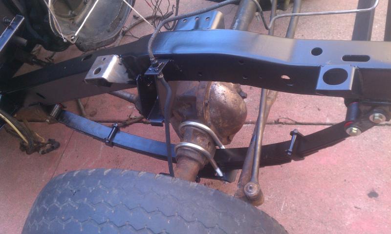

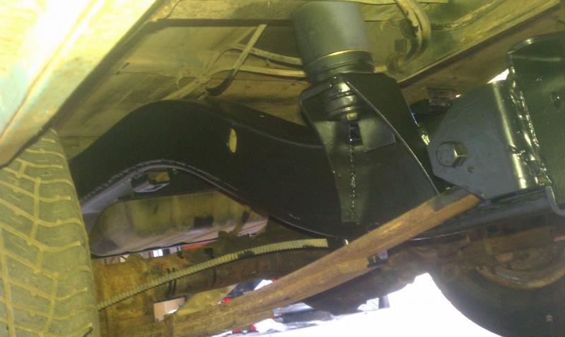

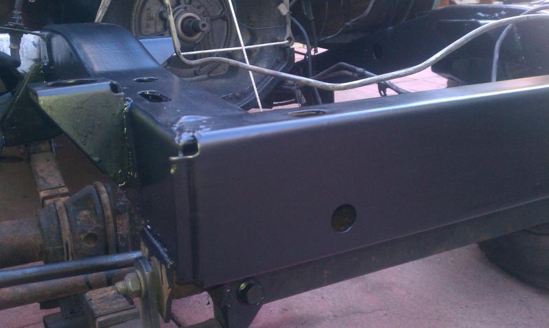

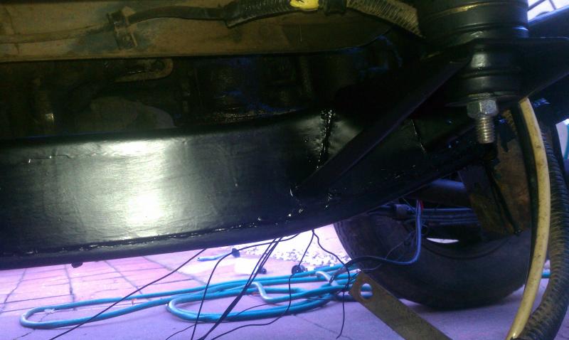

Finished sanding and grinding down the frame and coated it with eastwood extreme chassis black paint and primer. Really like how it turned out. Won't know how tough the paint is till I get this thing on the street but it is supposed to be very durable. This is 2 coats of primer and 3 top coats.
