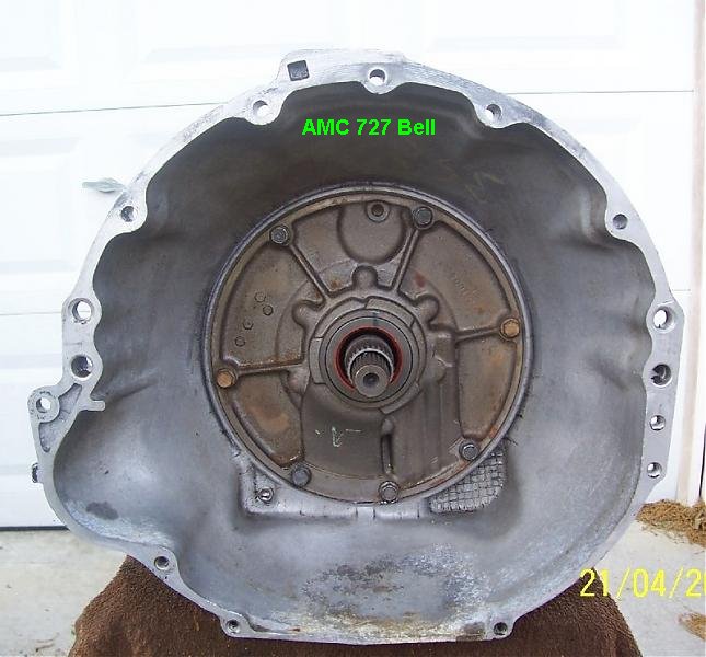

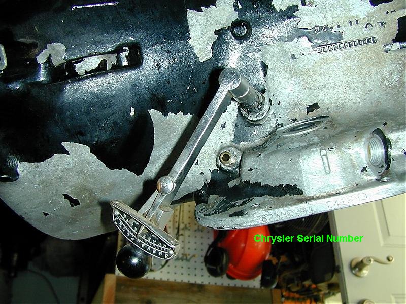

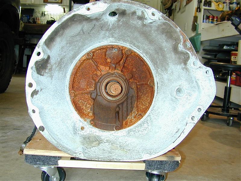

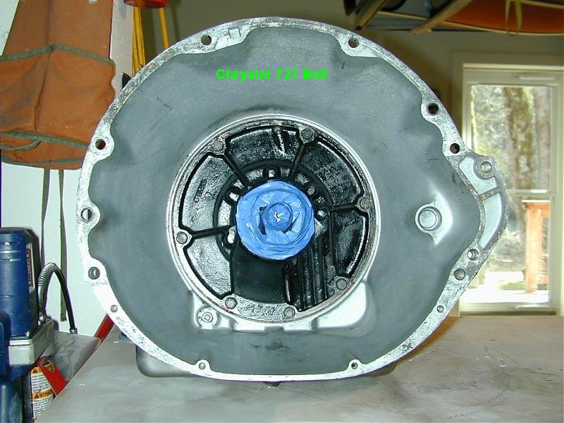

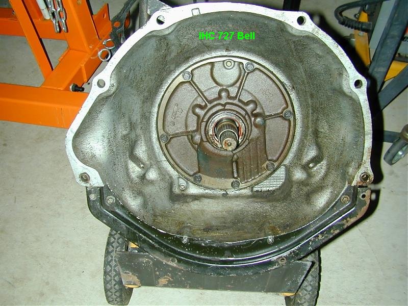

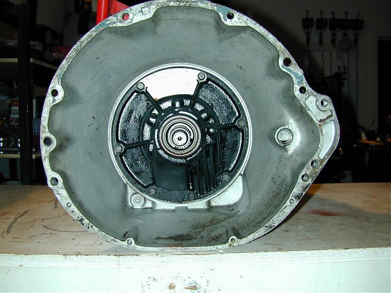

First off, we need to be able to identify which tf 727 basic unit we are dealing with. There were three main variations produced, one for all chrysler engine apps, one for amc engines, and of course, the unit used in ihc beginning sometime in the m/y 1972 production run of various platforms.
The first pic shows the amc variation...notice the full "circle" bellhousing, with the starter mounted on the passenger side. Starter location is the most obvious point of identification.
The second pic shows a chrysler engine application, again, full circle bell, but the starter is on the driver side.
Third pic shows a typical ihc tf 727, starter on the passenger side...but bolted to the block...not the transmission bell. And...notice the sheet metal "filler" piece mounted to the bottom of the "cutaway" bell, allowing for attachment of the flex plate/torque converter dust cover.
All tf 727 variations will always have a unique identifying number set stamped (not cast) into the pan rail on the driver side, just below the shift lever location...that is usually a "partial" serial number (earlier vehicles), or vin (later vehicles). That will tie the particular transmission case to it's original oem installation.
The 727 shown in the last pic is a very early tf 727 chrysler app (late 1966), notice the numbers stamped into the pan rail, lower left corner of the shot.

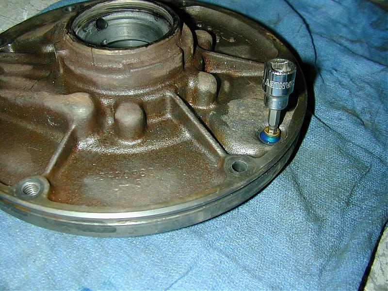

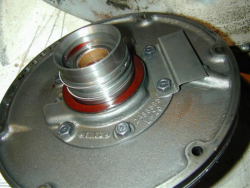

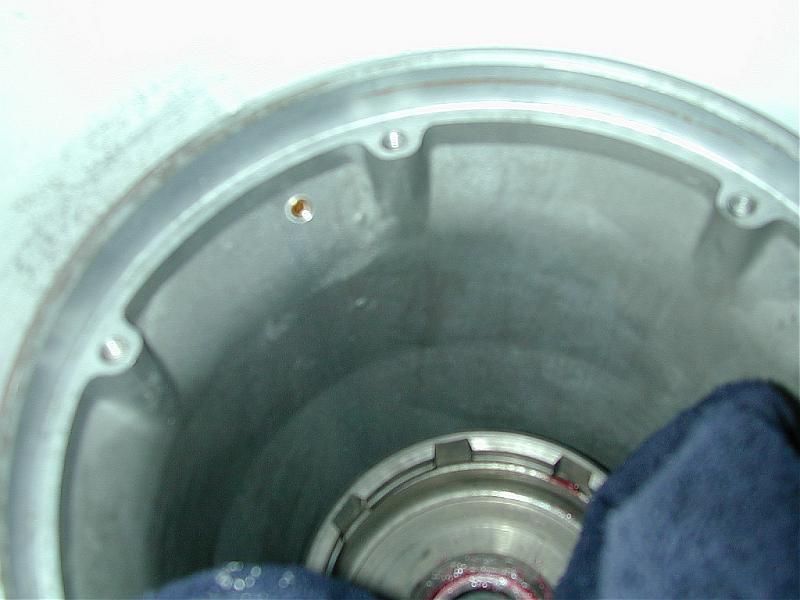

Ihc made the switch to the tf 727 tranny from the borg warner slushbox for all light line applications sometime in mid-1972 production. Those trannys used what I call an "early" design transmission case vent.
The vent is located on the upper portion of the front pump housing. It consists of a machined passage in the pump casting, which is covered with a sheet metal "baffle" visible from the outside once the torque converter is removed.
Internally, there is a similar baffle mounted which covers the actual vent penetration.
This vent system will allow water inside the tranny if the rig is stalled in a deep water crossing. So we're gonna eliminate it and add a new vent to the tranny case itself, located at the highest point, with a tube run to an even higher location on the vehicle. In order to do a vent relocation the transmission must be torn down, so it's best to do this when accompanied by a complete rebuild.
First the pump is removed from the case, and the oem baffles are also removed and added to your scrap pile of useful bits of sheet metal for some other project.
Next, from the inside of the pump casting, the oem vent hole is drilled and tapped to 1/8" npt, and a brass internal wrenching 1/8" npt plug is inserted permanently. This process seals the oem vent forever as if it never existed.

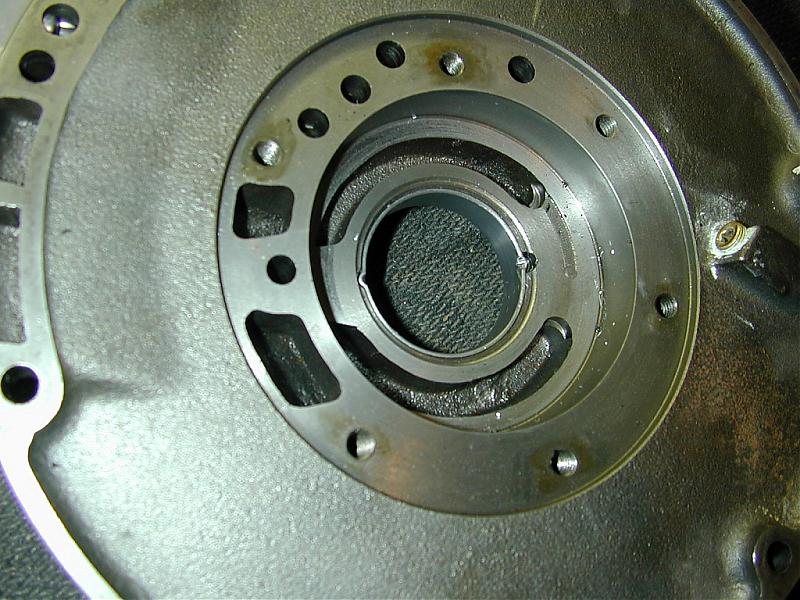

Sometime during my 1973 production, chrysler changed the vent design , along with the pump housing.
The re-designed vent system consists of a plastic vent "module" which is mounted in a large boss machined into the pump body from the inside and retained with a drive rivet. Only the vent hole is visible from the outside and no sheet metal baffle was used
this vent system is by far the most common used in ihc applications, both fullsize and sii. To eliminate it, a similar but different process is employed.

Here's the actual plastic vent unit installed on the rear of the pump housing.

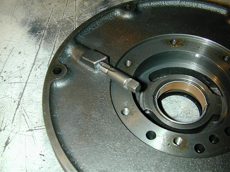

Here again, we're gonna plug off the oem vent hole, but we're gonna do this from the outside of the pump body, that is a much easier drill/tap process than performing the mod in the early vent system.
Simply use the appropriate drill bit to enlarge the existing hole and drill straight through the plastic baffle, no need to control the depth of the drill bit unless ya want to with a stop collar.
Then tap to 1/8" npt and install the brass plug and set it. In this case, I use hylomar (shop staple) for the thread sealant.
This completes the blocking of the oem vent for both types of systems.

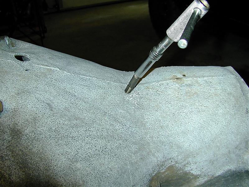

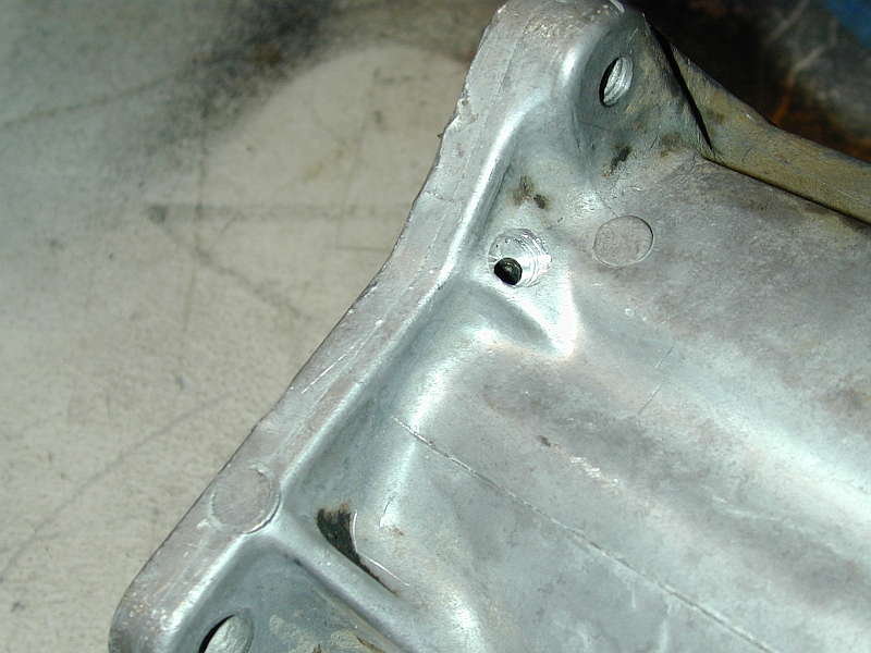

Now let's install the new case vent at the highest point on the tranny that is on the "wet" side of the pump.
The approximate location (not super-critical) is 1" to the driver side of the case mold parting line, and on the "sloped" portion of the case about 1" to the rear of the internal machined surface where the cast iron pump body seats against it's gasket. The case is very thin at that point so the hole must be drilled with the correct tap drill and must be absolutely perpendicular to the case casting itself.
Once the hole is drilled, then tap with a 1/8" npt tap, clean the threads and install a 1/8" nptx5/16" right angle hose barb. Be sure to seal the threads with the appropriate thread sealant and align the barb parallel with the case mold parting line and pointed towards the front of the case.
The large, 1" diameter hole in this bellhousing is for engine timing Mark access. This tranny is a motor home unit, which was bolted behind the hd/industrial/motor home dodge 440 engine. When those motors/chassis were used by the various coach manufacturers, the original timing marks on the timing case and the harmonic balancer were not visible/accessible, so chrysler put the timing marks on the tranny bellhousing and the flex plate so they were easily seen when the doghouse was removed.

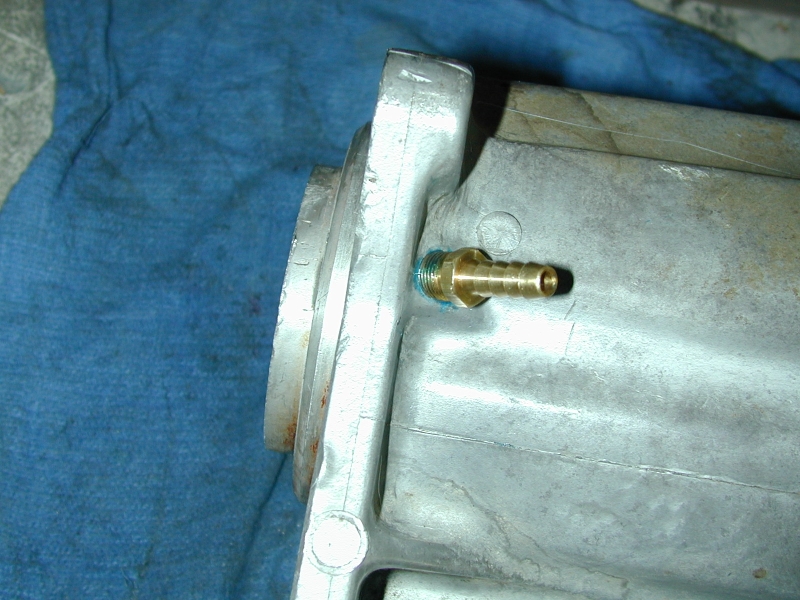

Here's a shot of the brass vent nipple installed.
No matter which year model 727 tranny is being modified, the case vent goes in the same position. Only the pump plug scenario is different.
Once the tranny is re-installed, then connect a length of 5/16" fuel-rated flex hose to the barb and run to a location in the engine bay, where it should end in an "air gap" loop and run into some form of catch can to prevent tranny fluid from spilling on the ground (or hot engine) during extreme angle operation (aka upside down/on yore side). We're gonna run the new transfer case adapter vent to the same location later on, along with a positive vent for the d20/d300 transfer case itself.

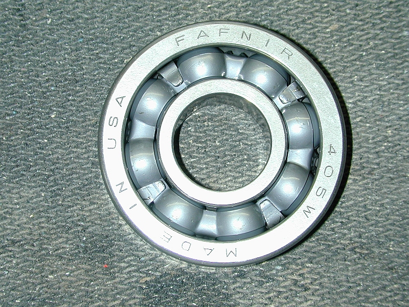

Once the hole is drilled to the proper size for the 1/8"npt thread on the barb fitting, it must be cleaned of all chips. And the bearing itself must be cleaned also without removing it from the case. Now is the time to replace both seals also!
Proper inspection calls for removal of the bearing from the case which can be a real pain...the case should be heated in an oven for about an hour at 400*f and the bearing will fall out (once the retaining ring is removed which is a major pita!). Replacing the bearing calls for heating the case again, while chilling the bearing in a freezer for about two hours.
