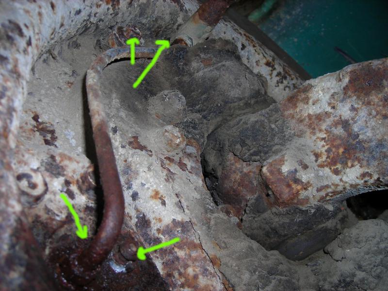

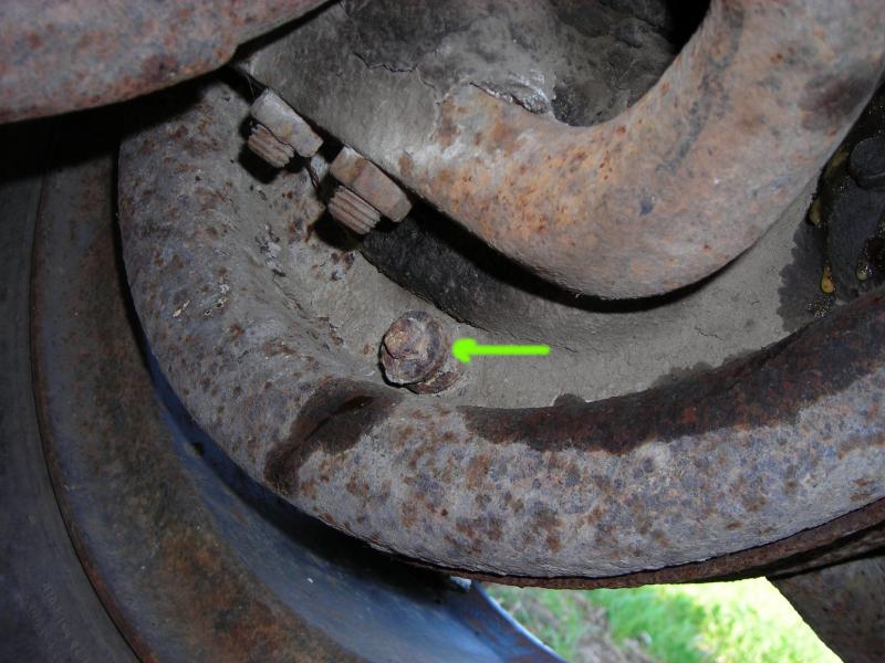

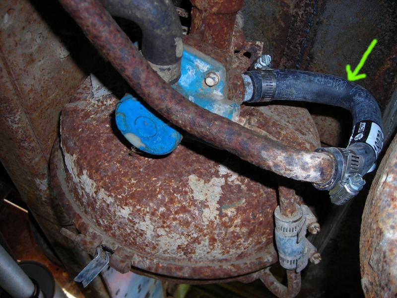

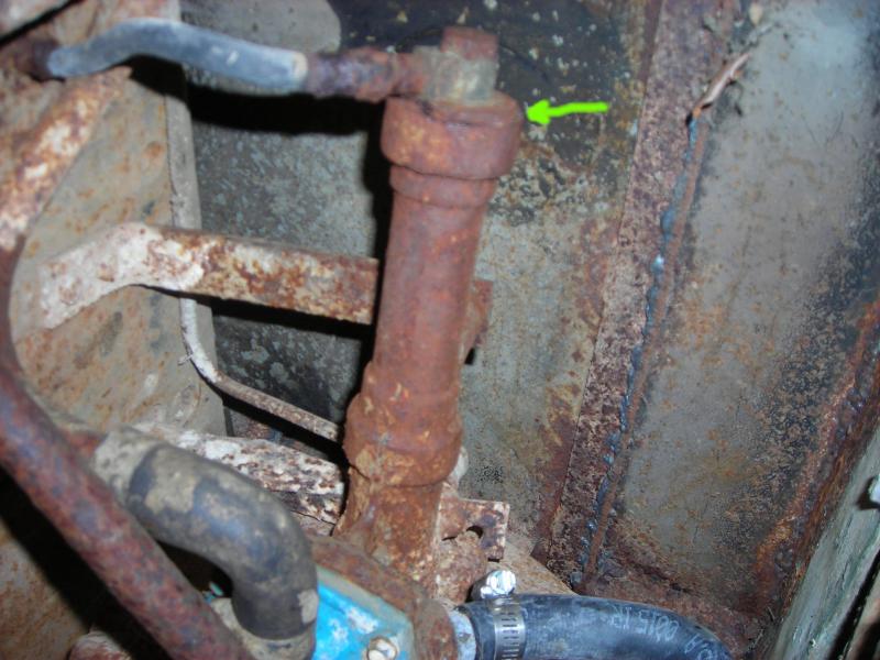

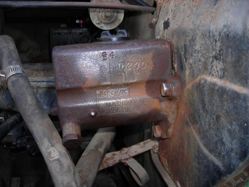

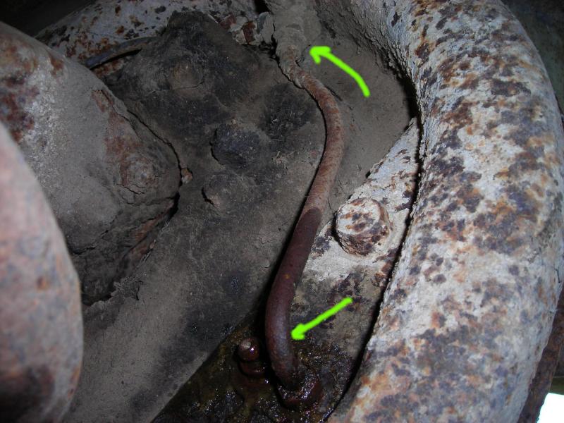

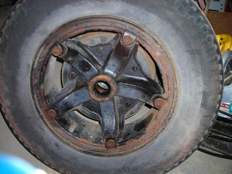

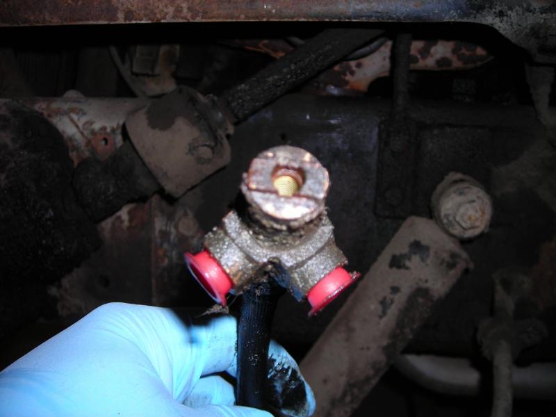

I have taken a few pictures to show the back side of the driver front wheel. Pictures labeled dscn0483.jpg shows apparently the cam bolt on the bottom of the hub.
Dscn0484.jpg shows the front bleeder and brake line going up to the top brake line splitter.
Dsnc0485.jpg shows the other cam bolt I’m assuming.
Dsnc0486.jpg shows the rear brake line coming down to the rear wheel cylinder.
Dsnc0487.jpg and dsnc0488.jpg shows the brake booster under the driver running board as well as the “slave cylinder” which I bled at the bleeder on this cylinder.
Dsnc0490.jpg shows the brake master cylinder with the id numbers on the side.
Dsnc0489.jpg shows the driver front wheel.

Great pics!
So...ya have the brake system that uses the external "cam adjusters, one for each shoe.
This is going to be a mess to work with, but then most all old hydraulics on rigs like this are.
Gimme some time to work through the tearout on this for ya and I'll provide ya the appropriate service procedure. Dealing with this type wheel/hub/brake system is not like working on ihc light line stuff at all.

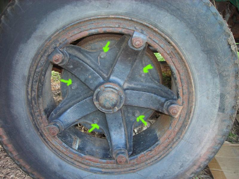

Ok! I finally got the loadstar on some pavement so I could jack it up to take a front wheel off....
I started by putting an impact wrench on one of the five lug nuts identified in the wheel picture posted earlier. The nut turned hard at first then started spinning. When I removed the impact I found the stud was turning. I then put a breakover bar on the next one but after turning hard a couple of turn, it started turning as well.
I then removed the four bolts holding the dust cover on and took out the outer wheel bearing. I was unable to get the wheel and hub off that way. I am assuming that I will have to loosen the cam adjusters to release the shoes from the drum. Before I really get things in a mess, I thought I would ask there was anything special in releasing the cam adjuster? Assume you would turn them left or counter-clockwise.

You have a dayton or demountable wheel setup. The wheel comes off the center cast hub by removing the outer nuts that hold the rim locks on. The nuts/bolts you first tried turning are what hold the drum to the hub. The wheel by itself, let alone the hub with it, is a heavy sumbitch; so without a jack or some way to support, it would be almost impossible to remove the whole lashup by going the wheel bearing route without hanging up on something. My 1st choice would be to dismount the wheel, then work on the hub. The studs look like 5/8" or 3/4" , rusty, serious wrench'in there.
The cam adjusters are turned in the direction of forward wheel rotation to tighten things up. (cw on the driver's side, ccw on the passenger side). So the opposite of that would loosen things up.

thanks for the response and yes the nuts were 3/4. I had thought about the weight of the tire (it even looks heavy) and had planned to use my motorcycle jack to lower and raise the tire to remount it.
If I understand you correctly, if the inter five nuts that I started to take off first are removed the cast spoked hub and wheel would come off without taking the wheel bearing out? At this point about the only answer for the first two nuts are to cut them off with a torch or burp gun, the studs just spin as the nuts are frozen on at this point.

No-o-o torchez
the drum is bolted to the hub, it comes off with the hub.
1. Remove wheel/tire from hub.
A. First loosen all the nuts and unseat the locks
b. Loosen the wheel from the hub, then remove the nuts and rim locks to remove the wheel.
(1) this step is a safe approach so you don't have the wheel unexpectedly falling off or on you!
2. Remove hub/drum like you would on another front spindle

are the five inter studs regular bolts or knerled studs that are pressed into the drum? Since I have never taken one of these wheels off... I don't know and have to ask?
You have convinced me to remove the outer lock/lugs first to remove the wheel from the spoked hub. Then loosen cam adjuster to allow the drum to come off the shoes. Remove the center wheel bearing and remove the hub and drum as one piece.

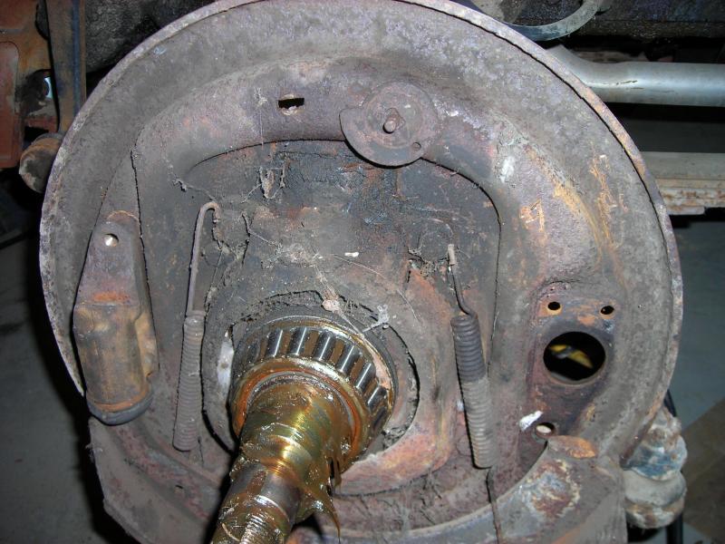

Okay, I finally got the wheel and hub off this @#$#%$* thing after a lot of different attempts. The brake shoes were frozen in place, assuming that the wheel cylinders were dry hence I was unable to bleed them.
We tried to remove the outer lugs to remove the wheel first but my ˝ drive impact would not even touch breaking them loose. Tried a break over bar with a cheater pipe still without any luck. The only way to get this driver wheel and hub off was to loosen the three bolts from the backing plate to give a little movement in the brake shoes, allowing us to pry the hub off with the wheel attached.

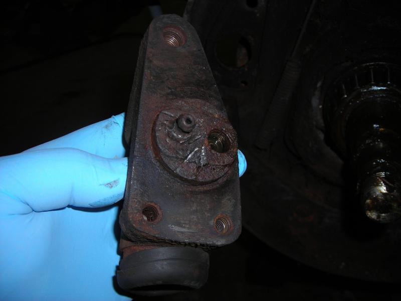

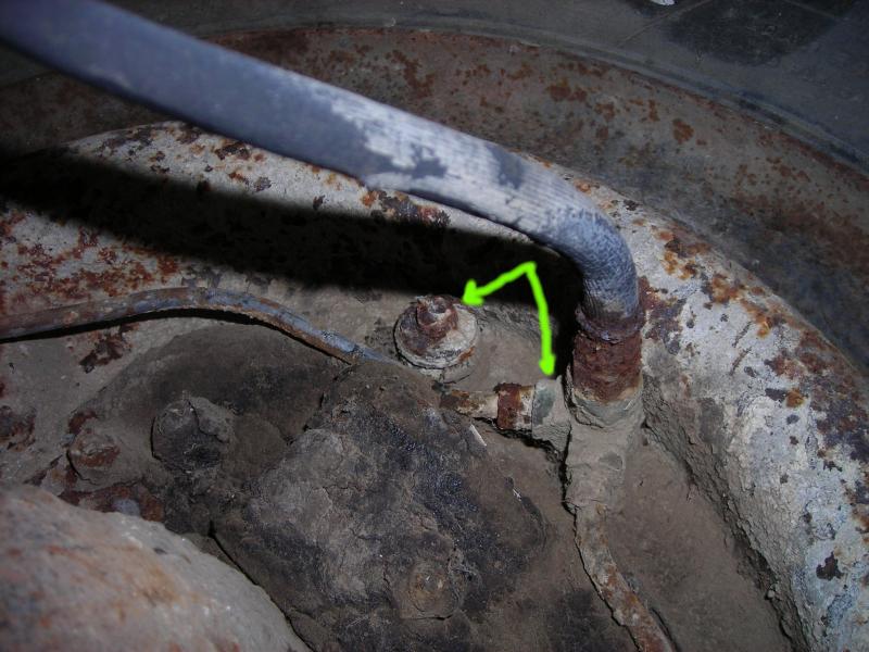

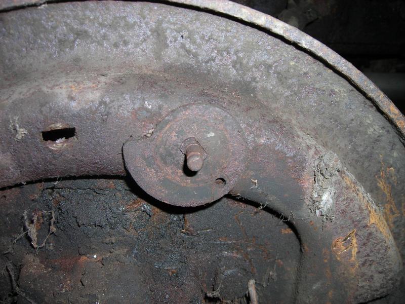

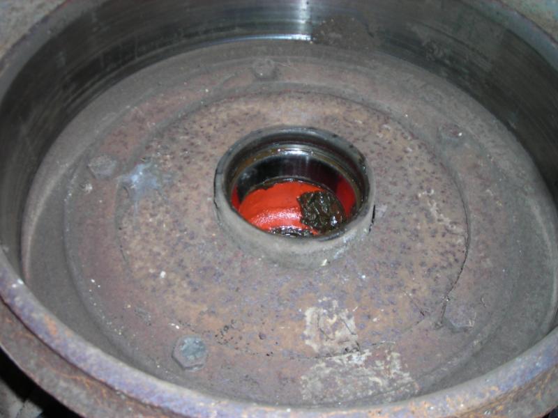

Once the hub was off, I saw what I figured was the problem. The wheel cylinders were toasted and hadn’t been working for quite some time. The brake shoes didn’t look that bad, I had already removed the upper shoe and both wheel cylinders to get the numbers off the cylinders before I took any pictures.
The front single action wheel cylinder pushes the bottom shoe downward against the bottom of the drum as well as serving as a solid stop for the front side of the upper shoe with the slot on the back of the wheel cylinder. The backside single action cylinder pushes the upper shoe upward against the top of the drum, again also serving as a solid stop for the back side of the bottom shoe. Both brake shoes are held in place by the single pivot of the cam adjust shaft and both springs connecting both shoes.
The slot at the top of the backing plate is where the bolt holding the “y” fitting connecting the brake line hose to split the brake line to feed both the front and back wheel cylinders. Once I had removed the upper brake shoe and loosen the bolt holding the “y” fitting I was able to get a 7/16 line wrench on the brake line at the “y” fitting to get it broken loose.
I was able to locate the correct wheel cylinders at the local parts house, raybestos wc37033 (left) & wc37034 (right). I am currently looking for the brake line hoses going out to the backing plate as the rubber is rubbing off on my hands.
Oh! The bolts holding the cast iron spokes to the drum appear to have a regular bolt head on the inside of the drum. I haven tried to tighten them but I would assume that I can or replace them if necessary.
I will upload pictures that were taken as an after thought covering my comments above.
