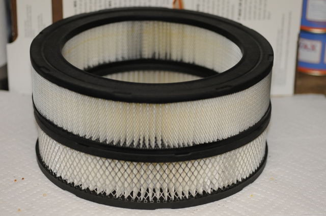

On air filters, you can easily see the difference -- if you put a wix air filter next to a fram air filter.

fwiw here is a picture of two air filters -- bottom is a stp air filter (made by ???) and top is a wix filter.
You can see the different number of "pleats" -- same applies to oil filters...
