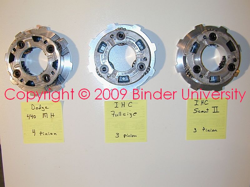

edit: a true 727 low gear set is an aftermarket item. I've never found any evidence it exists as a chrysler-source setup, though I've yet to get into all applications of that trans. I'm not saying it was never used oem by chrysler in production, I'm just saying I've not turned up any definitive part number or tech info with factual data and/or drawings/pics. Involved part number differences yes...but that is because of the four vs. Three gear planetary parts differences.
And the gear sets available don't come close to providing the advantages of a simple gearing change in the axles.
A "low gear" planetary set along with numerically high axle gears would be advantageous in extreme offroad or vocational truck operation. Especially if cost is no object.
The core dodge motorhome 727 transmission that I built for maranda's "pink" mud drag rig supposedly had that phantom low gear planetary set in it,...but the only difference in the motorhome units (and same for IH motorhome apps) is a four gear planetary setup instead of the three gear setup used in standard duty 727 apps (including all IH stuff except motorhome):
