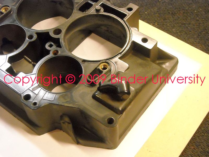

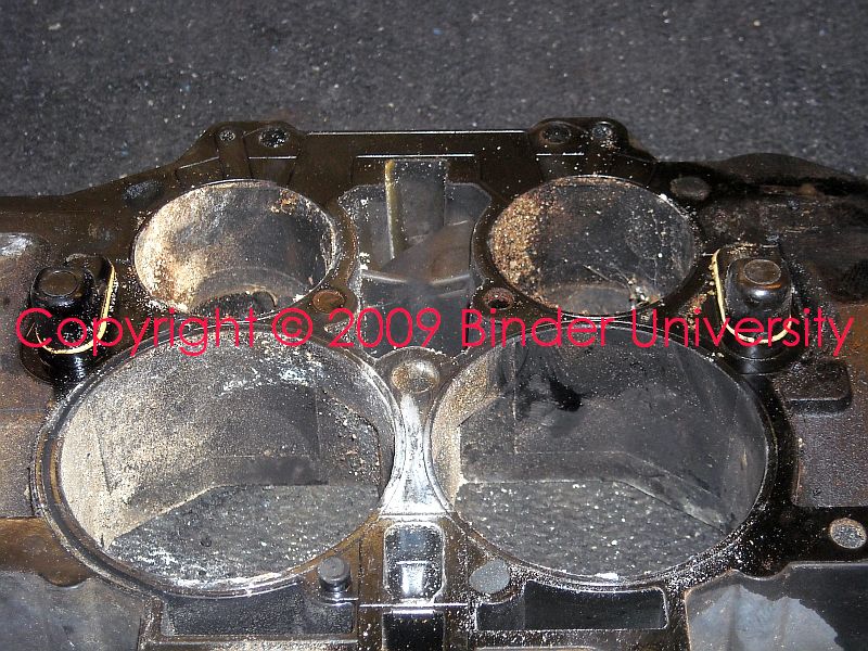

Beginning with some possibly later m/y 1977 Scout II rigs with a 345 and on through eop, the carter "thermoquad" 4v carb was standard issue.
The same carburetor series was also used on some fullsize rigs equipped with the 392 motor for m/y 1974 and 1975 production.
These units are generically refered to as a "spread bore" throttle body design, a description of the design which incorporates relatively small diameter primary throttle bores, with much larger secondary throttle bores.
The mounting fastener configuration for this carb series is also not interchangeable with the Holley modular carbs we refer to as "square bore" throttle bodies.
It is possible in many cases to use a suitable adapter to convert one manifold design to another so that these various carbs can be interchanged. But performance-wise, an adapter is not considered to be the best solution, and it also adds to the induction system height which May create a hood interference issue on many vehicles.
This shot shows the intake manifold side of the cast aluminum (not cast zinc) throttle body used on the thermoquad.

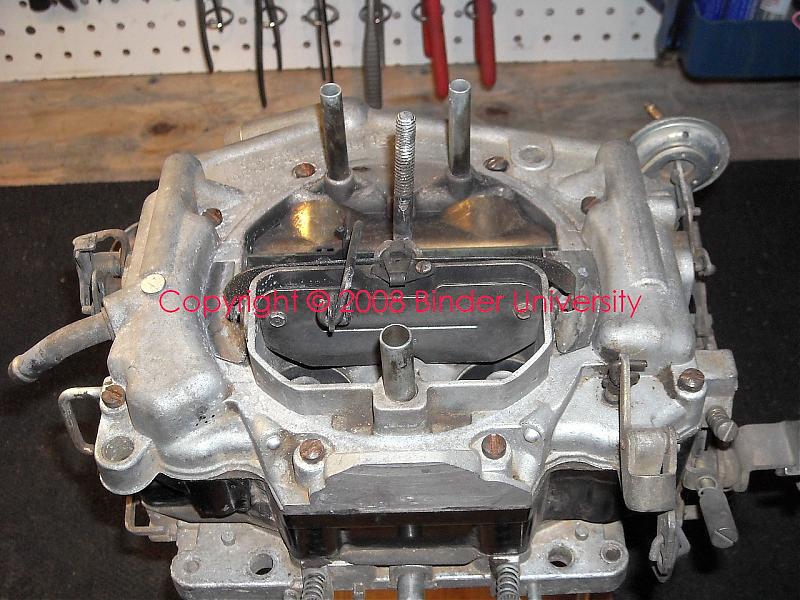

The "tq" was a very advanced, high-tek carburetor engineered to provide both adequate performance for larger displacement v8 engines popular in the 1970's and into the 1980's, with an overall much tighter calibration needed to meet both 49 state and CA-only emissions requirements which came into being with the advent of m/y 1973 light duty vehicles in general.
The most unique component of the tq design is the use of a molded thermoplastic resin main body/fuel bowl. The bowl was capped top and bottom with a cast aluminum airhorn and throttle body.
Many manufacturers (most notably chrysler), used significantly increased engine operating temperature specs as part of their emissions schemes as compared to previous versions of some engine families. This of course resulted in much higher underhood temps as well, so the problem of "fuel percolation" within the carb when a hot engine was shut down for a period of time, became much more significant. And percolation just added to the "load" that the evaporative emissions control system had to deal with under the same "shut down" conditions.
As compared to previous carter "afb" designs, as well as the Holley modular carb series used for many years by ihc, the tq was consider to be much more complex to deal with, and that was pointed to regarding the difficulty mechanics had in calibrating/adjusting these mixers to stay within emissions limitations, yet trying to enhance drivability complaints which flooded dealerships back in the day. Same type of "technology overload" that was experienced again just a few years later with the advent of rudimentary electronic engine management systems such as the chrysler "lean burn" concept which used an "electronic" version of the tq. These were not good times in the automotive service industry! The IH dealer mechanics also faced their fair share of difficulty in dealing with the same while also learning how to service electronic-trigger ignition systems.
Then add in the later variations of these mixers which incorporated a electrically-controlled rudimentary "altitude compensation" circuit and it's no wonder most special interest vehicle enthusiasts shy away from these mixers!

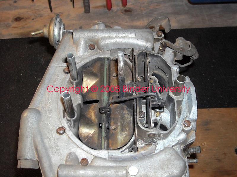

One aspect of the carter 4v carb family has always been the use of some type of "air valve" to assist in modulating air flow through the carb secondary venturis as the throttle plate angle increased. The increased air flow (and the corresponding increase in fuel volume) must be controlled in some "progressive" fashion when the throttle is suddenly pushed to the floor, otherwise the engine simply cannot deal with a sudden overabundance of mixture instantaneously (we're talking the average "street" engine/vehicle here, not a high performance/race application).
Holley accomplishes this by using a design which incorporates a vacuum motor to actuate the secondaries on their oem/aftermarket "street" carbs. Thus it's not possible to "over-carburate" an engine (within reason) if all the tuning parameters are correct.
Carter uses the "air valve" to accomplish the same thing. The secondaries are connected to the primary throttle control using a "progressive" linkage arrangement that is very simple in design. The air valve in the secondary side (the large rectangular "plate" seen on the left side of this pic) is spring-loaded to a closed position in a balanced fashion. Once air flow through the secondary throttle bores/venturis is sufficient, air flow overcomes the spring tension and the air valve gradually opens to allow an increase in air/fuel mix to be drawn through the intake manifold and distributed to the cylinders.
A rochester quadrajet carb was GM's answer to this same design...but a quadrajet was never oem for any ihc application so we aren't interested in including those in this discussion.
The true "secret" to proper operation of either the tq or a quadrajet is a correctly-operating "choke pulloff" (either one or two depending upon model variations). These devices "lock out" the operation of the secondary throttle system until the engine is both up to operating temperature and the manifold vacuum signal is correct for secondary throttle bore engagement in a progressive fashion. Without correct choke pulloff functionality, neither of the two spreadbore carb designs will operate at all as they are supposed to.
Likewise, Holley also developed a "spread bore" version of their modular series but those never enjoyed any popularity as an oem emissions solution. They are available in the marketplace as a replacement for a tq but won't be "emissions legal".

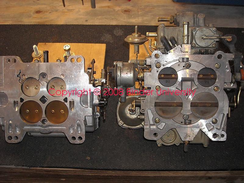

Let's take this spread bore deal a bit further here and hopefully we won't confuse anyone.
This pic shows two alternatives to a spread bore carb solution as provided by a tq. But only one of 'em is a true spread bore design, the other is a wannabe crossover.
The carb on the left is an edelbrock "thunder" series mixer, those are a clone of the original carter "avs" carb series, an excellent carb in it's own right. As can be seen, this throttle body is not a true spread bore, it even carries a mounting hardware pattern for multiple manifolds. Those units incorporate an "evolved" version of an air valve for the secondary system, quite different in execution when compared to the more common carter "afb" and it's clone family...the edelbrock "performer" series. The avs/thunder mixers could be used on IH square bore manifold applications if much port matching was performed on the oem intake manifold. Same for port matching onna spread bore IH manifold. An intermediate adapter or spacer would be of use in making the port transition...I've not attempted that myself at this point.
On the right in this pic is a true "spread bore" replacement carb for the tq, a Holley modular in the 4165/4175 design series. Virtually identical in most all regards to the traditional Holley square bore mixer, but incorporates a completely different main body and throttle body. This one is a "replacement" carb for a quadrajet used on a chev app, notice the fuel inlet fitting which point to the passenger side. Bop (buick/olds/pontiac) replacements for the quadrajet have a front-facing fuel inlet fitting.
In order to use these 4165/4175 carbs on an IH sv app, most likely the primary fuel bowl assembly would have to be replaced with a different version, otherwise tstat housing interference would be encountered.
The edelbrock carbs are currently manufactured under license from carter by marelli in north carolina iirc. Marelli is also the source of the "weber" product in the u.s. Market currently, you will sometimes encounter a weber version of the afb or avs that will have neither the carter nor the edelbrock brand identified on it, only the weber tradename.

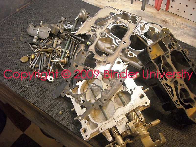

Must be alotta folks bringing their projects outta hibernation this past week. I've had several contacts regarding dealing with thermoquad carbs that have been sitting with fuel in the bowl and have now deteriorated to the point they need some attention.
And comparing a freshen of a Holley modular carb with a tq, is a real eye-opener. The tq is far more complex with it's myriad links, interconnects, dual vacuum pulloffs, and composite materials construction. But I've finally sourced the "right" kit for dealing in an IH app tq, so let's take a look.
Here's the first one I pulled put of the core pile that looked decent on the outside. Man was I mistaken! This is about as rotten a carb as I've ever seen!!! Been full of water for years, and obviously was involved in an engine fire and the fire extinguisher chemical had it's way with the body. So this one goes in the parts donor box.

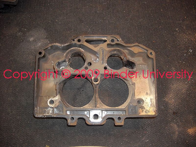

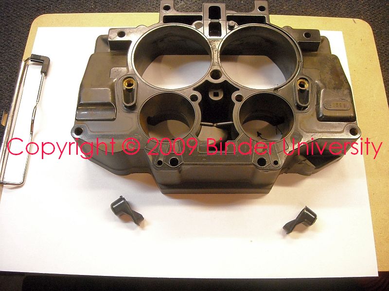

This is the interior of the thermoplastic resin main body after I dumped a cupful of corrosion and garbage out! Even had a screw left inside the bowl that is nothing like the fasteners used on the carb!
Folks talk about these plastic bodies "warping" like that was something that happens all the time. In actuality, I've seen very few of the bowls with that issue. And if they are, it's easily delt with by carefully using a wide plate belt grinder with an alox belt to correct the "flatness".
Then, looking down into the primary nozzle wells, ya see the second one of the two principal problem areas regarding these carbs. Fuel leakage /drool from the nozzle wells and fuel bowl continuously. Starts out with the bowls leaking down slowly over a period of days when the carb sits unrun. That progresses to fuel appearing to drool from the throttle shaft, causing folks to think the carb is now toast because the throttle shafts and bores are scruud...not true!
When the nozzle wells begin to leak, the fuel runs right onto the throttle shafts and to the outside. When the engine starts, we have a major over-Rich condition that is masked by the choke action. As the engine warms up, the liquid drool is so small, the motor seems to run just fine, though fuel economy begins to suffer.
As the issue becomes worse, the odor of gasoline (or today, that alkeegazz shot known as e10) is noticed when the rig sits for a few minutes. Especially if parked in an enclosed space.
Finally, engine performance deteriorates to the point the motor is a real pita to start and then run. So we blame it on a "crappy carb", "bad gasoline", Friday the 13th, whatever. Only problem is the carb is tired after 30+ years of neglect!
As shitty as this bowl looks, it will be brought back to life. These bowls are priceless and not available new unless ya find a stash somewheres that has been hidden since the 70's when they were popular!
This bowl is flat. It's only issue besides being badly grunged, is that the nozzle wells both leak. I test those by drying the inside of the bowl and then carefully pouring rubbing alcohol into the nozzle wells and filling the bowls up with about 1/2" of liquid. Then I carefully elevate the bowl and watch for the "stain" to appear around the joint where the nozzle wells are epoxied to the main body. And unless the bowl has been previously repaired, they all will leak after 30 years of service!!!

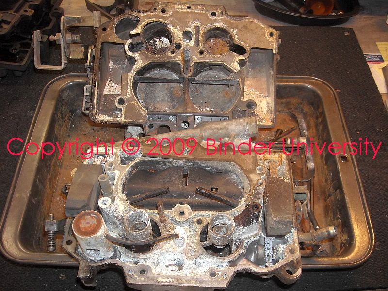

So after tearing down four different tq carbs all of which are for sii/345 apps, I finally got one that is a candidate for a reconditioning operation that I guarantee success when completed and will look fairly decent.
It takes me at least three times as long to fully build a tq (cleanup is a super-pita!) as it does the worst Holley modular or carter afb/edelbrock clone. And the service kit is much more dinero also compared to the Holley.
So this is a "before" shot. The choke pulloffs shown here are crapped as usual, so this carb will get a pair of fresh reconditioned pulloffs that are on the shelf at ihon.

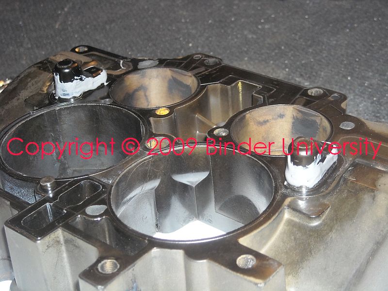

In posts #6, 7, and 8 in this thread, ya saw the guts of a damnastee tq.
Here's what the bowl looks like now after a preliminary cleaning.
When I checked the glued-on primary wells for integrity, they fell right off on the bench!
So this is a good opportunity to show the fix.
First all traces of the oem sealer was removed (remember that white line?) from both the bowl and each primary well. I use an exacto knife, a small pick, and a cut-down/sharpened scraper to do that. No trace of the original adhesive can be left to contaminate the repaired joint.

This is a closeup of one primary well and it's mounting point on the plastic bowl. The inside of the primary well and the bowl where the pieces join must be sterile so that the epoxy will adhere.

This shot shows the primary wells re-attached using jbweld.
A toothpick is used to butter a thin layer of jb on the parting line of the bowl, then the primary well is pressed into position .
A thin layer of jb is then spread around the parting line for reinforcement.
Jbweld works just fine for this application. There are some other proprietary epoxy treatments that could be used also, but are not generally available except in larger quantities (there is a shelflife to the stuff) and much more expensive. I use the jb for doing the same thing on a rochester quadrajet. They have a similar arrangement only they use pressed-in plugs to seal the access passage for the rifle-drilling. All quadrajets leak fuel out of the bowl unless they are also sealed, same issue as the tq! The bowls must be leak-checked and sealed when they are rebuilt.
