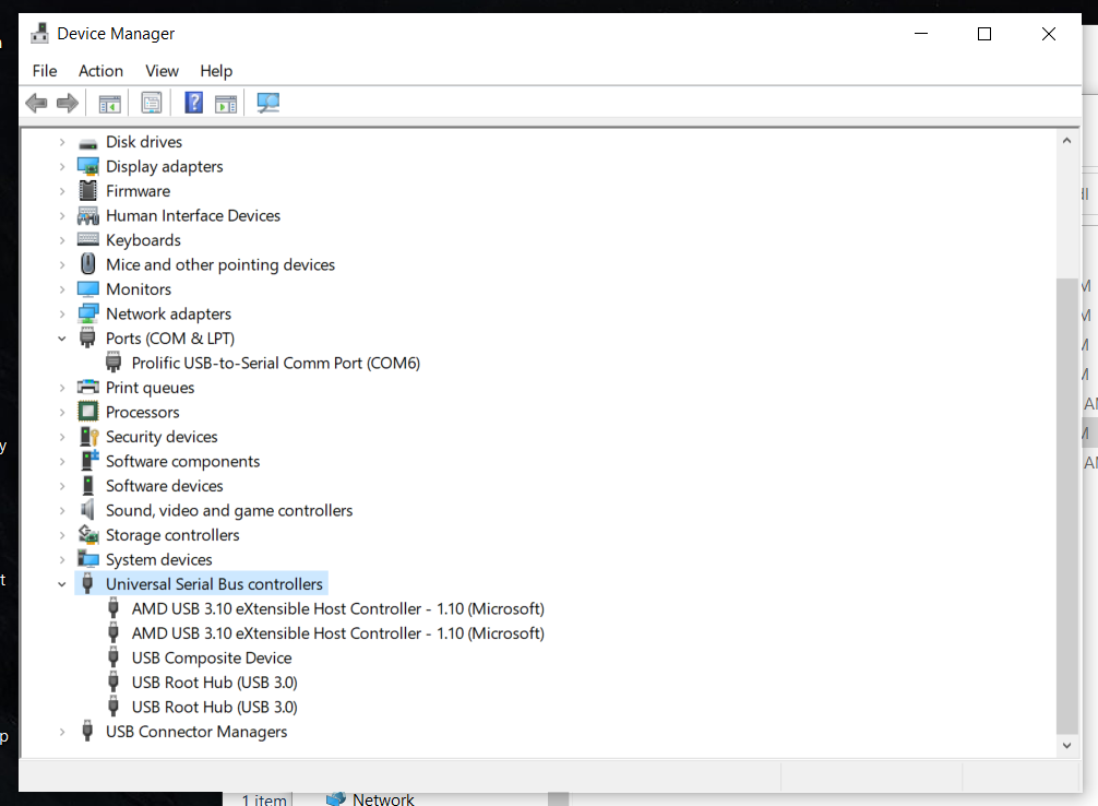

Click on the windows icon and type in ,"device manager." and click on the program. This should be the window you should see.
Then find the tab that says "universal serial bus converters." make sure the ECM is connected to the computer Other wise you will not find what you are looking for.

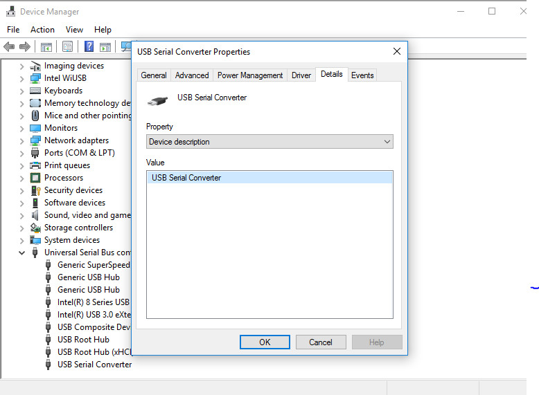

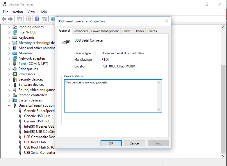

so find the part where it says, "usb serial converter." or something along those lines. And right click on the text and go to properties.

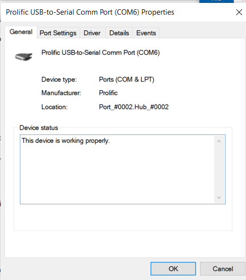

This is what it will look like* **mine says it is working fine because I fixed it so ignore that, but sometimes it says it is working fine but it isn't....
windows 10 is just weird....
So this is that part where every thing goes haywire. I've tried this on two different windows 10 pc's and two different things happened. When you go to properties, it has different tabs listed such as port setting and etc. So the deal is, if the computer "thinks" the device is working properly, it wont list that tab because it doesn't wan't you to mess with it per say.
But anyway, click on details and it the description of the driver should say,"usb serial converter." if not change it.
Then go to advanced and and check "load vcp."
Click ok.
And it should work.

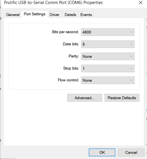

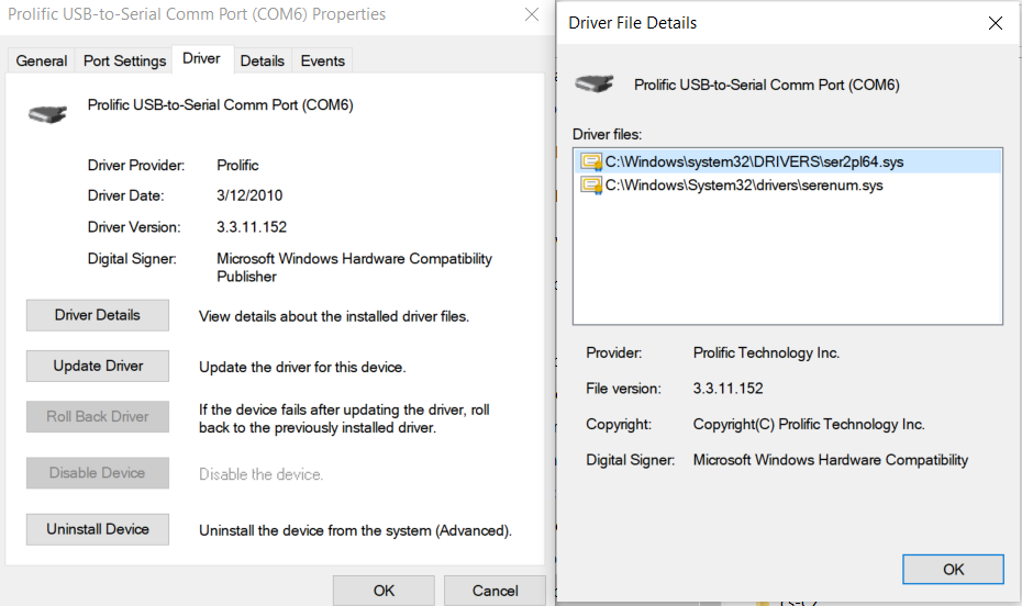

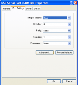

And it May show these tabs on some computers, ignore the different format, its all the same.

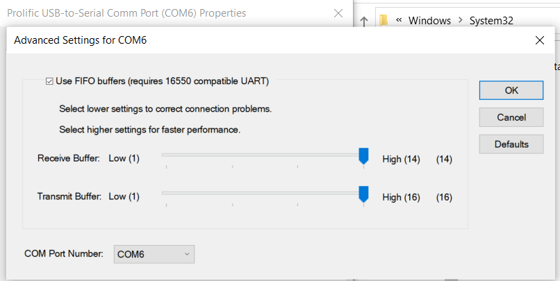

And this is what it looks like if it has the advanced tab. Change all parameters to what you see on the screen.

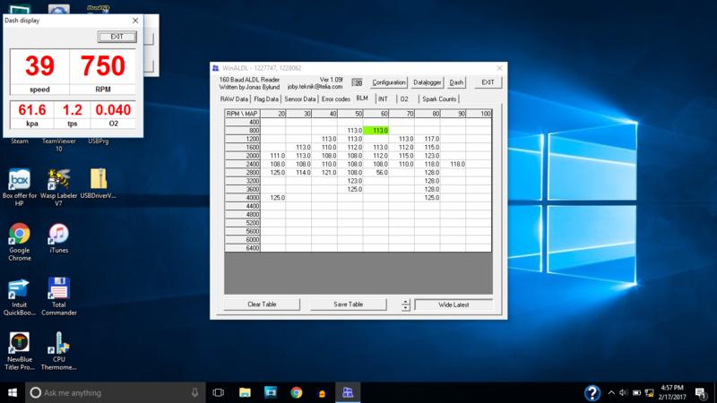

Then you should be able to log data.
