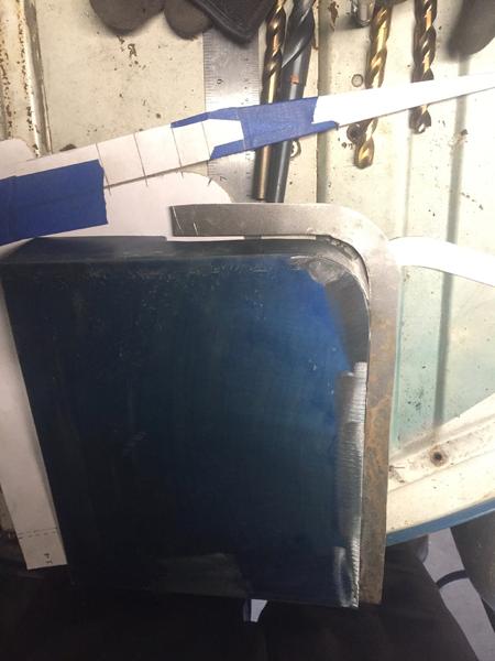

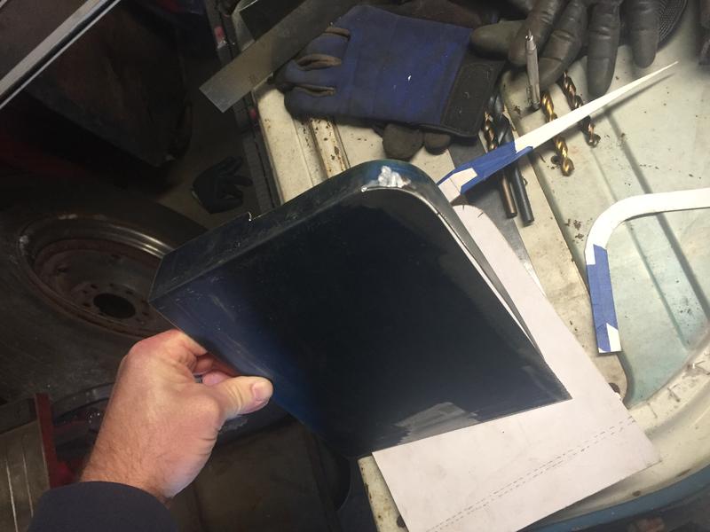

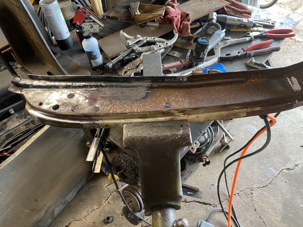

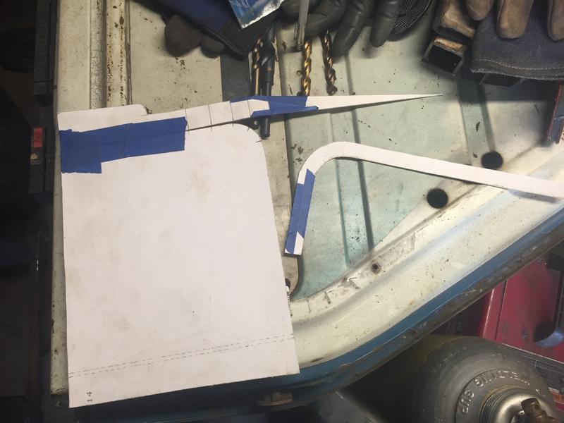

Here is the panel I have been working on slowly.
I started by making a poster cardboard template
I used dykem and transferred my tp, then cut, ground, and bent the metal

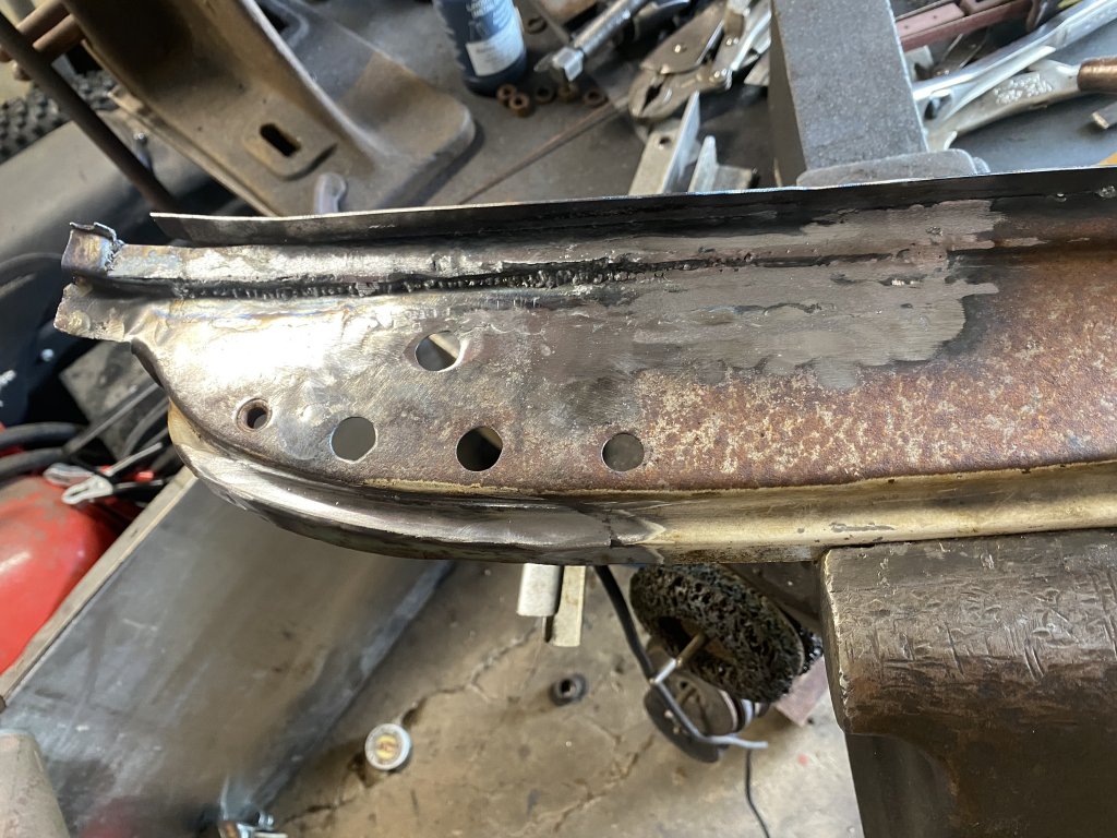

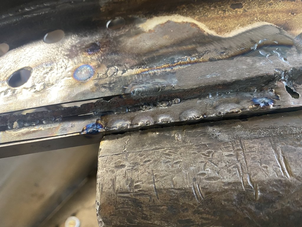

I welded and ground along the curved seam.
I tacked the flange portion of the piece to the main body.
...more to follow today

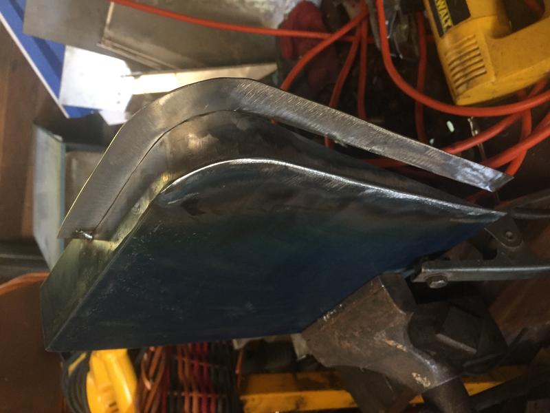

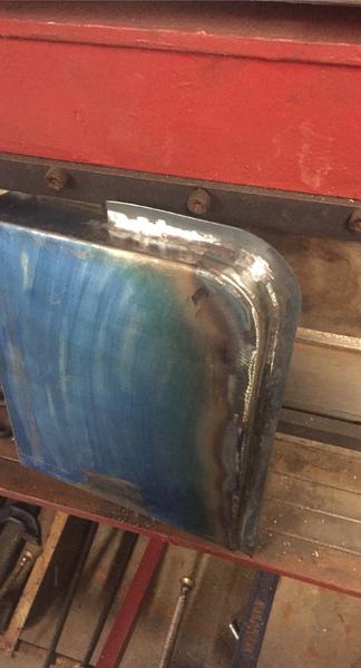

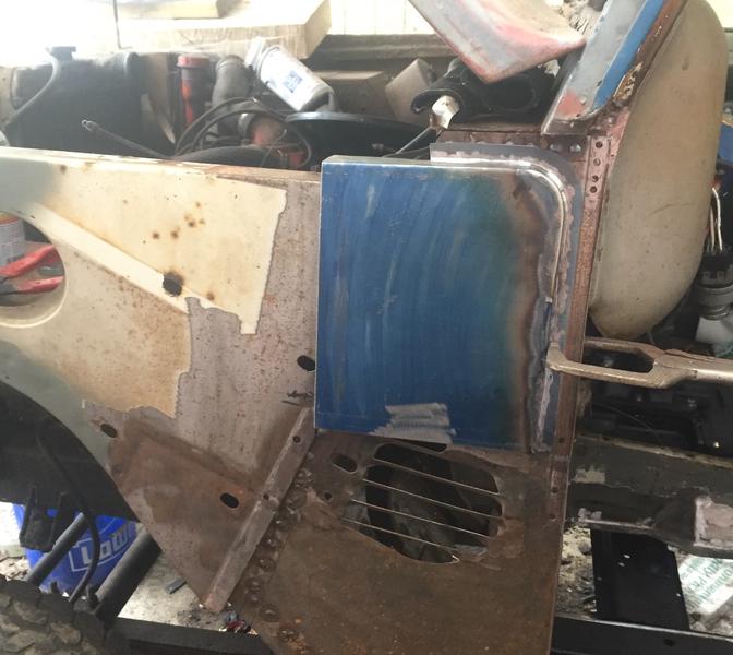

Is raining here today. I finished welding and grinding the piece for my inner fender. Here she is;
here is the piece after I finished welding it....

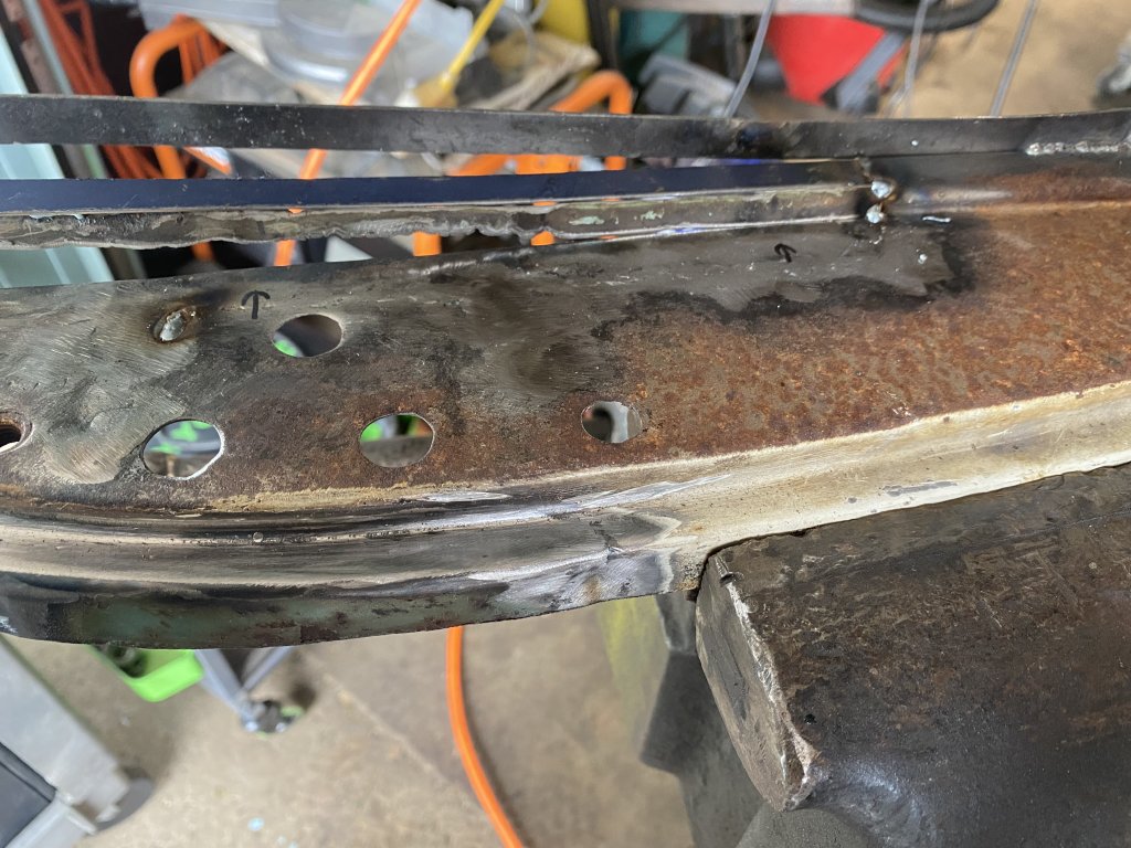

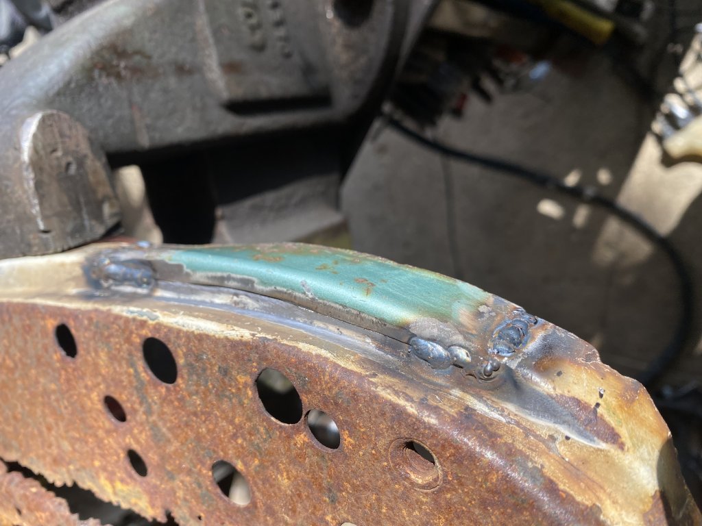

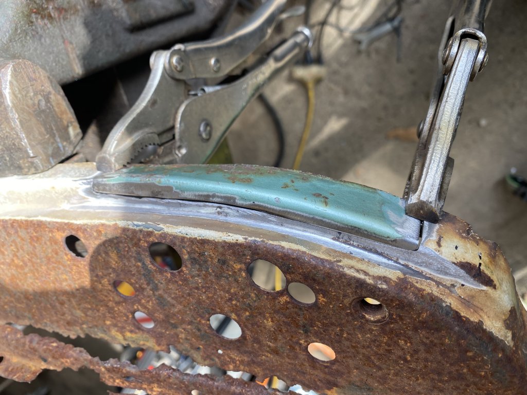

Here it is clamped in place. You can see I will have to lift the inner fender to match the lines.

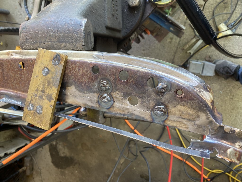

I May have to trim a little off the bottom. It looks like it interferes with the vent louvres.
I have to grind down some of my plug welds before I weld it on. I also bought some weld through primer, but because of the rain I am not going to paint anything today. I plan on hitting the surface rust with a wire brush on my angle grinder and then using the primer. More pictures to follow.
