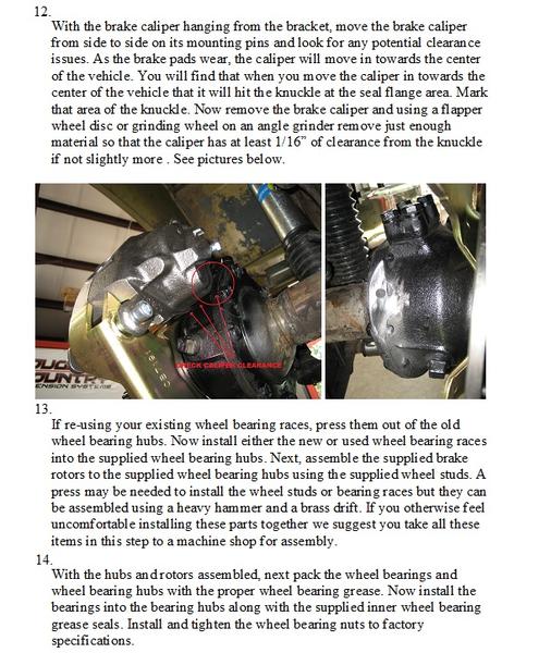

CPT Scout 800 Front Disc Brake Installation Instructions
ihpartsjeff
Administrator & Owner
Staff member
  • CPT-DIRECTIONS-S80-800-FRONTDISCBRAKEKIT.pdf

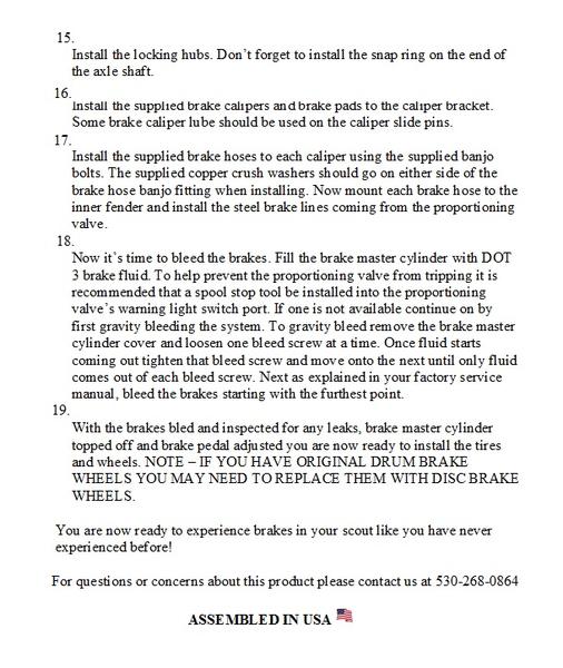

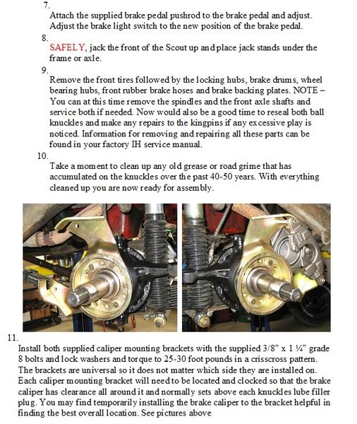

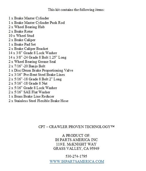

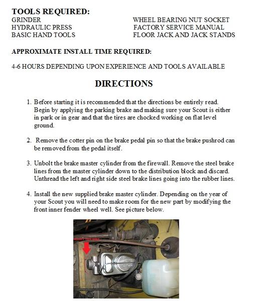

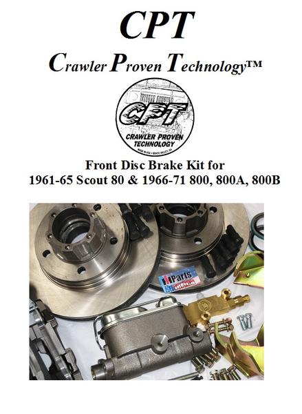

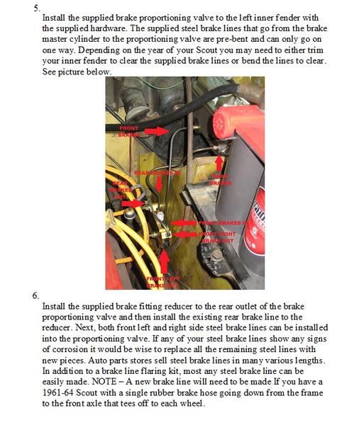

For the pdf challenged, we have converted our direction sheet into simple to see images.
See the provided links below for some other good places to get installation tips and tricks -
http://forums.IHPartsAmerica.com/IH-parts-america-build-ups/7953-IH-parts-americas-1971-Scout-800B.html
attachment.php
attachment.php
attachment.php
attachment.php
attachment.php
attachment.php
attachment.php
