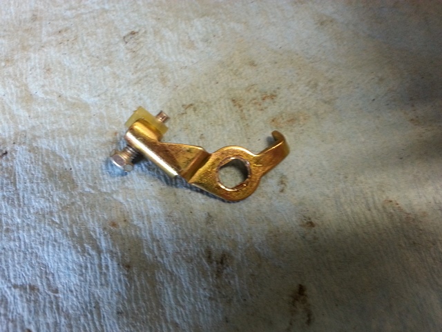

One thing I discovered is that I was only getting 2/3's throttle! I know that this won't improve the mpg, but what the heck, I want everything it's got when needed. The problem's were caused by the fast idle adjustment arm and the limit on the secondary throttle shaft. This carb as supplied comes with a fixed arm that opens to way below the intake manifold at full throttle, however with carb sitting on an IH manifold it hits the carb mounting surface. Fortunately there is an easy fix, Holley makes a spring loaded arm that does not protrude below the base of the carb. Luckily I had one from a carb that was switched to manual choke. It's a drop in replacement.
The other problem is that there is a lever on the secondary throttle shaft that limits full throttle. Why I don't know as the linkage limits opening already. IH didn't think it was needed either as there is no arm on my 392 carb. So with a few strokes of a hack saw it was gone. Now she set my eyeballs just a bit farther back in the sockets at wot. :d
