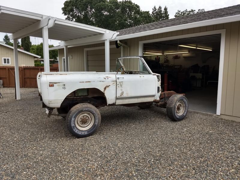

After what seems like forever, I'm getting back on this project! I set the body back on the frame and after killing some wasps, I started clearancing the rear inner fenders. It feels weird cutting metal that isn't all rusted.

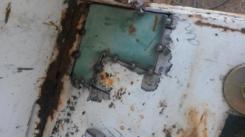

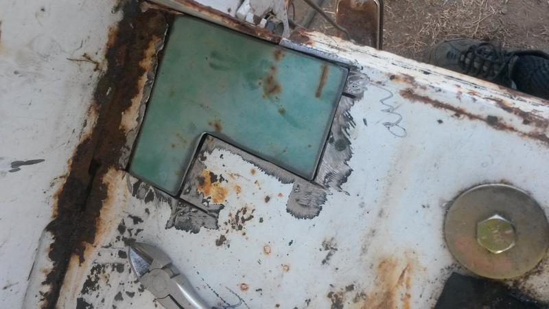

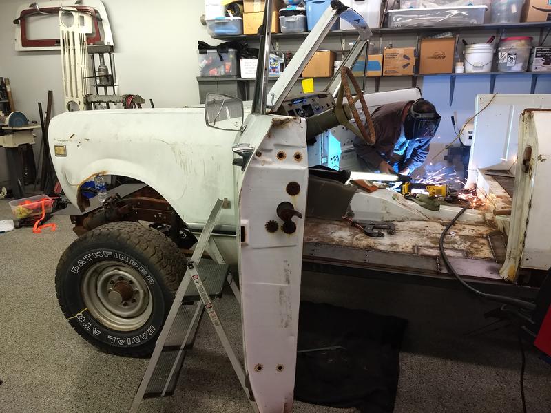

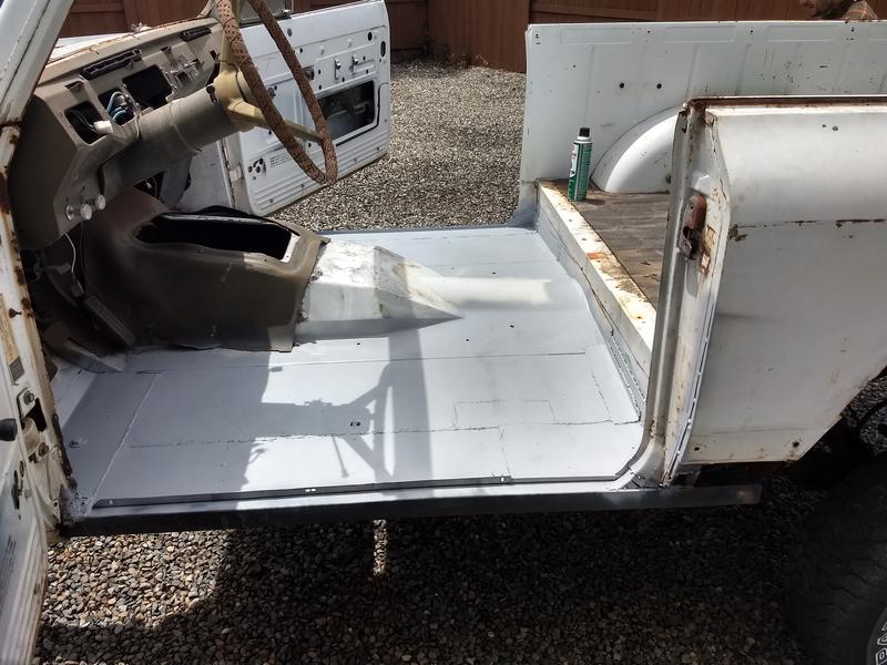

i finally got the fenders fully welded! now working on some rust repair! also had to modify the access panel since the fender is over the corner of it now don't know why the pic's rotated like that.

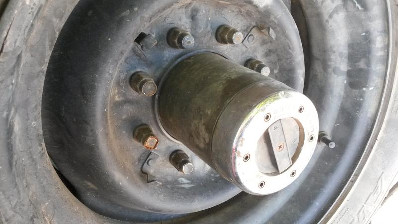

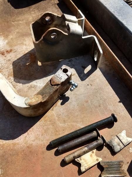

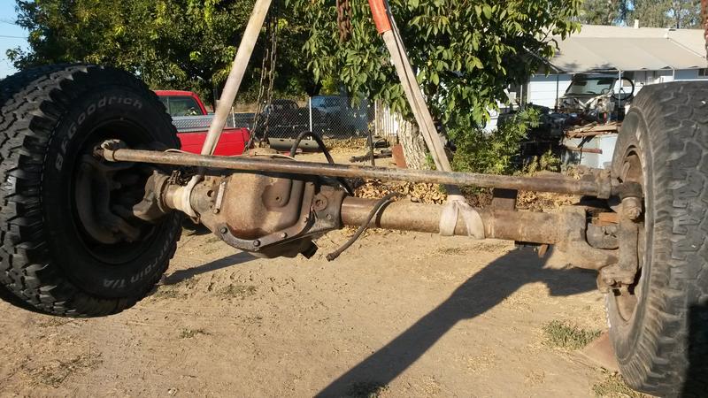

we always say custom builds like this are all about time and money. well this post is about money! i found a Dodge kingpin 60 front axle! it's about the same year as my frame so fingers crossed it will bolt right in!! it's a very beefy axle i'm already looking at lockers and high steer arms.

Should be a bolt in. '72 - '93 Dodges are pretty much the same under the skin.

Trust me in this, consider double shear.
Look into getting arms with the hole lines up with the stock hole on the knuckle.
Make sure you do springless.... With an adjustable spacer for the kingpin.
Run stock 30 spline outers to start.
Later, when $ permits look for 35 spline outer stubs & hubs.

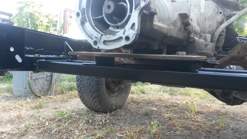

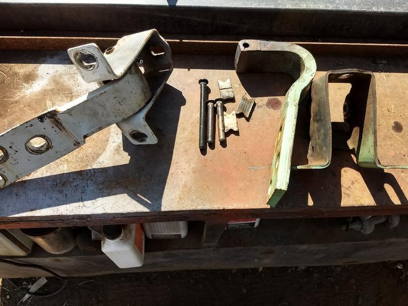

i finished the cross brace a little while ago, i just never posted pictures. it's designed similar to the stock scout cross brace in that one side is over the frame bracket and the other side is under. the hope is to not need a jack to remove or install the brace. hopefully i don't have to modify it to clear the front driveshaft.
