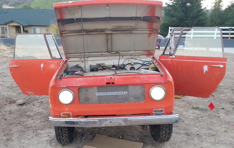

Hi, I'm new here and new to Scouts. I rode in one as a kid and always thought it was a fun vehicle that I hoped to own own day. Well, last Saturday I saw this one at auction and threw a modest bid on it and walked away, only to find out later I was the winning bidder.
I rented a car trailer Monday and drove up Donner to Sparks, Nv and that was the first time I had seen it in person. I was worried it might not have an engine because the auction description said "International Scout 800 Body - needs restoration" so i was hoping maybe 'body' didn't mean that's all i get the hood was propped open and I could see the 4 cylinder there and the old oil bath air cleaner still on it so that wad a good sign that it was all original.
I got it home that night and now I'm starting to work on getting it fixed up so it is driveable.
Here are some photos:

Nice!! That hood emblem is worth $$$ they are hard to find and a 1 year only. Probably a 196 with a T18 4spd and Dana 20 Tcase, which is a good combo. There are specific ways to bring them back to life without hurting them in the process.
DO NOT PUT A BATTERY IN IT AND TRY TO START IT!!
On a SV engine that has sat for a long time you need to pull the dizzy, valve cover, and plugs. I shoot Marvel oil in the cylinders and change the oil and filter, and add a manual oil pressure gauge that you can see from the engine compartment. You can drive the oil pump through the dizzy hole with a drill and bring it up to pressure, verified on the gauge that you put on. From there I spin them backwards for 3 or 4 turns by the crank pulley bolt. Then spin it forward while spinning the oil pump again to verify that the rocker arms are oiling. If that goes well, put it back together with new ignition parts, rebuild the carb, and fire it up..... Thats what I do anyhow. It looks to be pretty stock and untouched. GOOD FIND

I did shoot MMO in the cylinders and the oil was very clean so I took a chance and started it up. It fired up and I shut it down until I can get the bugs worked out.
I found the LSS in the glove box along with the owners manual and original dealer invoice I found out it has the RA 23 Dana 44 with power lock. It says T-45 trans and only "transfer case" below that so I have no idea which TC I have. How can I tell the difference between a 18 and a 20?
The T-45 references a T18c which I am guessing is the close ratio T18.

Look underneath at the rear driveshaft. Passenger side output from the right side of the transfer case is a Dana 18; left side output would be a Dana 20.
You have quite the score there!! It looks very nice. The RA23 rear axle is a two piece, meaning the ends are tapered with a matching detachable hub the brake drum may or may not be swaged to the wheel studs. Usually to get the rear drums off, you remove the hub with a hub puller. More on that later when you get around to it. Start in your fix'ins with a Service Manual. The schematics alone are worth the cost. You'll find most of the wires are green; but they have numbered ends for identification seeing it looks pretty unmolested at this point, it shouldn't be hard to gett'in her back to road worthy again!

I took a closer look at your pictures. That paint job seems to me to indicate some kind of special edition Scout. Could you post a picture of the Lineset Ticket or build sheet?

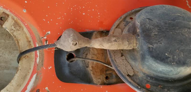

I did get a pic of the mud wasp nests that are ALL OVER this scout. No wonder this vehicle wasn't messed with too much over the years as it had an insect security system
