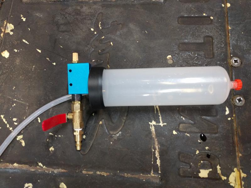

Not much to update on the 800. Spring/summer is tough to find time to work on it. I did however pick up a family vacation pop up to tow behind the Scout. Have to make due with the work truck until Scout is running. The color matches the Scout interior colors.

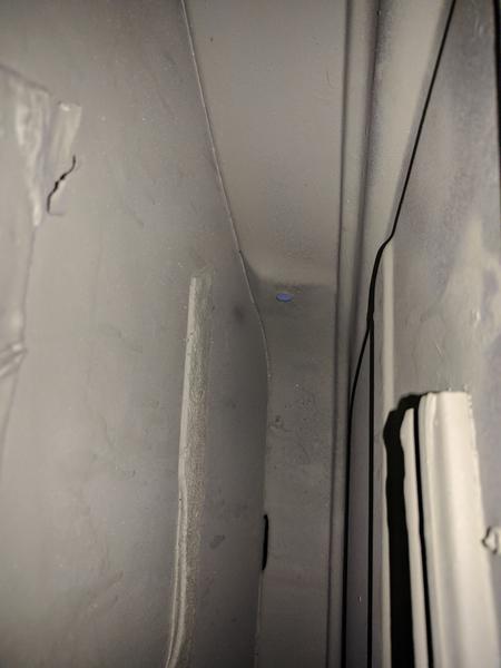

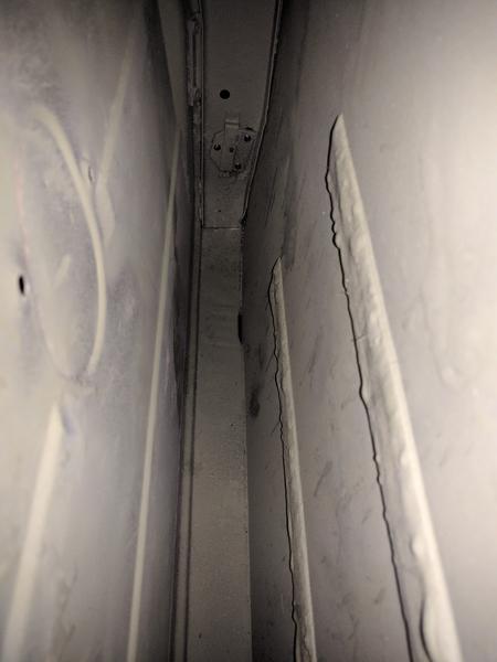

So here is the door rust I need to repair. Luckily this is it for both doors. Not being a body sheet metal guy I have been able to deal with the rust as it was all flat parts with straight bends, no radius. Not quite sure how to deal with this. I don't have any spare doors to cut a patch out of. Suppose I could try to hunt some down if necessary. You guys have any ideas to repair this area without a patch from a spare door?

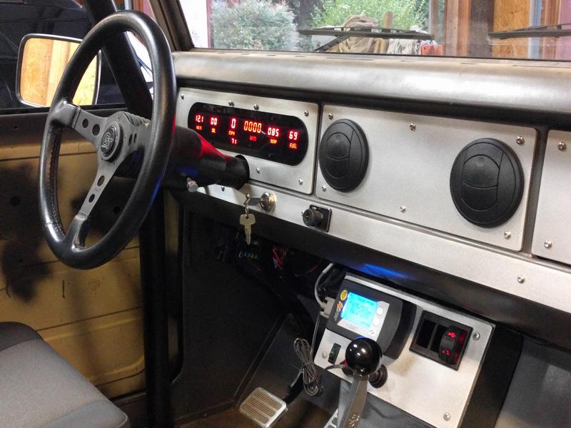

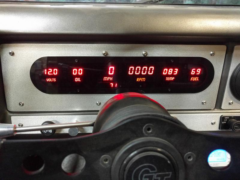

Its been quite a while since my last post for the project. The Scout has actually been roadworthy for some time and I have been driving it when I can. However, there has been a problem with it running to hot, not overheating, just to warm for comfort. I think I have finally gotten that straitened out but it took removing the electric fan and going to a clutch/fan unit with a shroud that required some fabrication. The transmission is also running hotter than it should so my next project will be to replace the cooler with a bigger higher quality cooler than the tube and fin unit it currently has.
Bumpers are finally painted and I am pleased with the finished product.
The Scout rides pretty good on the highway. Cruises nicely at 55. Still need to get the front end aligned and probably have the tires re balanced but overall it seems pretty good.
