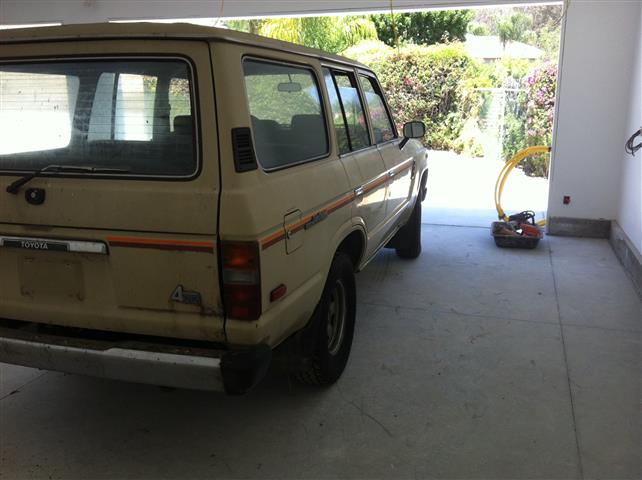

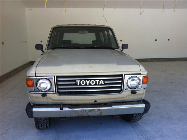

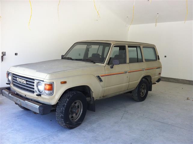

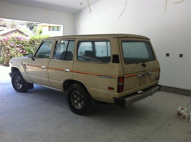

So some times we cross paths with a vehicle because we have our IH's that we can't refuse to bring home.
This one is not an IH but still a world renowned desert rig.
1984 toyota land cruiser, original owner, 100% socal resident, 100% as it left the factory with the exception of added age.
4 speed, 4.2 liter 6 banger, factory air. Not a dent or spec of rust. Paint still good if not for the dirt. Interior typically dirty from sitting but still nice and rip free.
It was parked before 1999 and remained parked since then.
Needs some restorative tlc and care before trying to run.

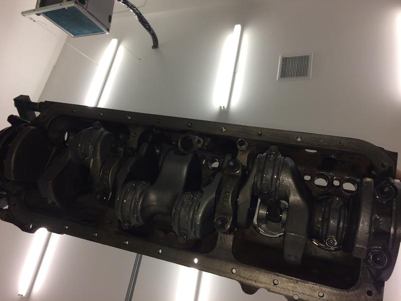

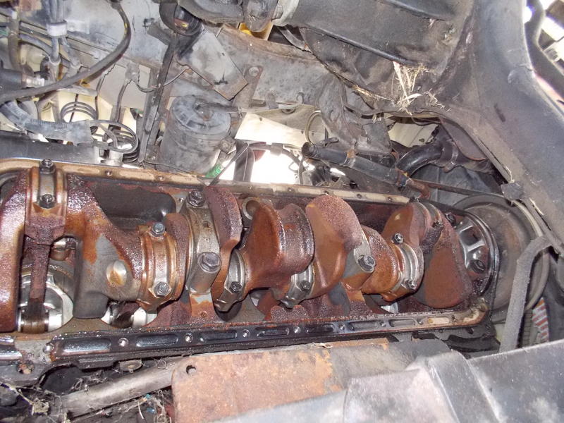

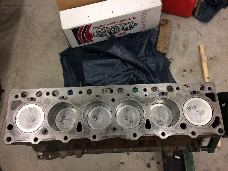

* ot vehicle update *

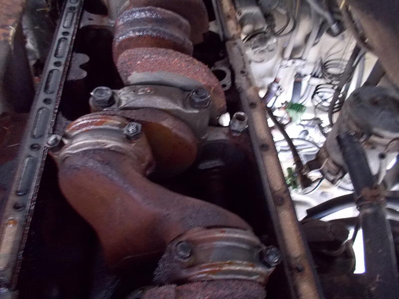

so last weekend I figured I'd pull the valve cover, pull the dizzy and do a quick pre-oil of the engine. I had already verified that the engine was not locked up by putting it in 4th gear and pushing the truck. Yep it turned. I also knew that the head had been rebuilt in 2000 (about when it was parked) because there was a receipt in the glove box from a local machine shop with the name zeke justice as the customer (google that for kicks), saying it was gone through along with a head gasket set and other parts.
The oil on the dipstick was new. With the vc removed and the plugs out I figured I'd bump it to tdc #1 and verify the dizzy was stabbed correctly. Bump, bump, bump, wtf the rotor was not turning but the valves were operating. First thought was water from a blown head gasket at or before 2000 had corroded and locked the oil pump, and the distributer gear pin had sheared when po had tried to start it after the head was replaced. This was 14 years ago.
So at least the dizzy was going to have to come out. Fail it was not budging. Uhhhooohhhh. Pulled the oil filter and I find corrosion in the passages and a bone dry filter.
Not looking good
seeing that the dizzy would not come out from the top I would have to pull the pan and try to remove the oil pump which wan probably rusted to the dizzy drive tab.
Pan off------- here is what I found. Yep still not looking good... The rods are free and move as they should. The problem as you can see is surface rust and lots of it. So mush that flakes off that there is no way the oil pump could survive ingesting it and that the float screen will surely plug up. Looks like the engine will need to come out and be gone through. The bores looked ok through the plug holes so maybe I can get away with a light hone, ring job and replace the other corrosion damaged parts. Looks like a cam and lifters will be in order.

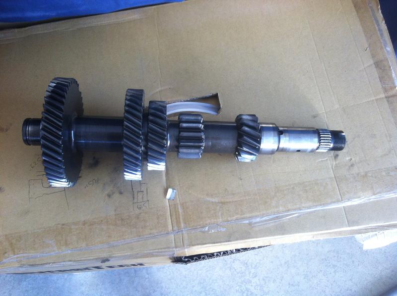

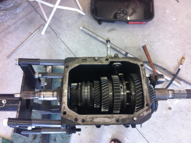

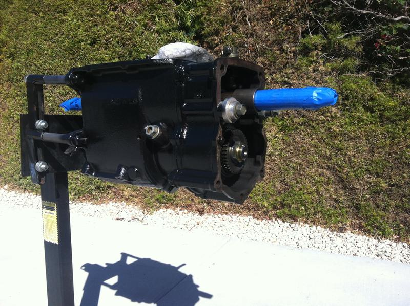

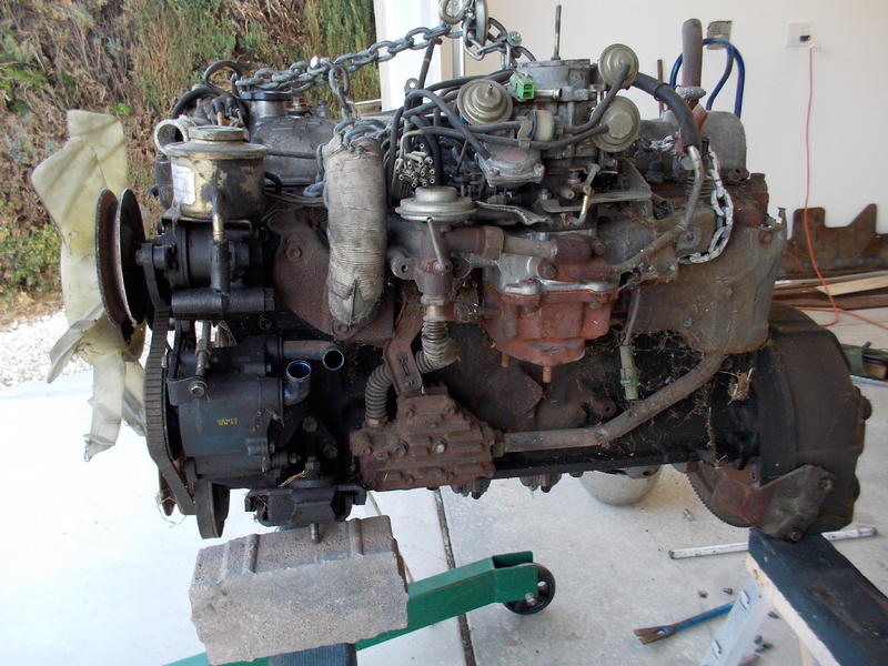

Update in progress.

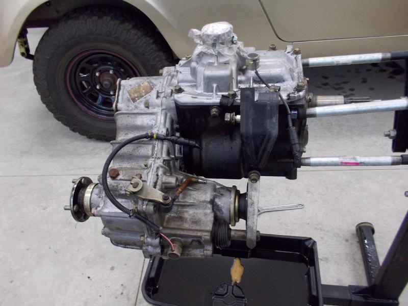

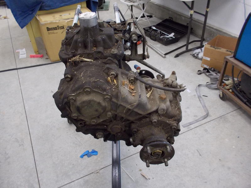

Ended up buying a second fj60 solely to give up it's 5 speed and drive shafts to my first one.
Trans reconditioned and fully inspected. It had a chipped primary reduction driven gear on the cluster gear shaft.
Ordered a new one, tore the trans down and installed it. It is in great condition now. Ready to install after I go through the engine.
The donor fj60 will receive the nice 4 speed mounted on it's original transfer case and the appropriate drive shafts which are longer rear and shorter front for the 4 speed
my keeper fj60 will get the 5 speed, the same transfer case as it came with and the 5 speed drive shafts.
Last weekend I got the front of the lc removed to make yanking the engine easier, 99% of the lines and needed hardware off. Next weekend the engine will be on a stand and 4 speed will be out. .........I hope.
More later.
