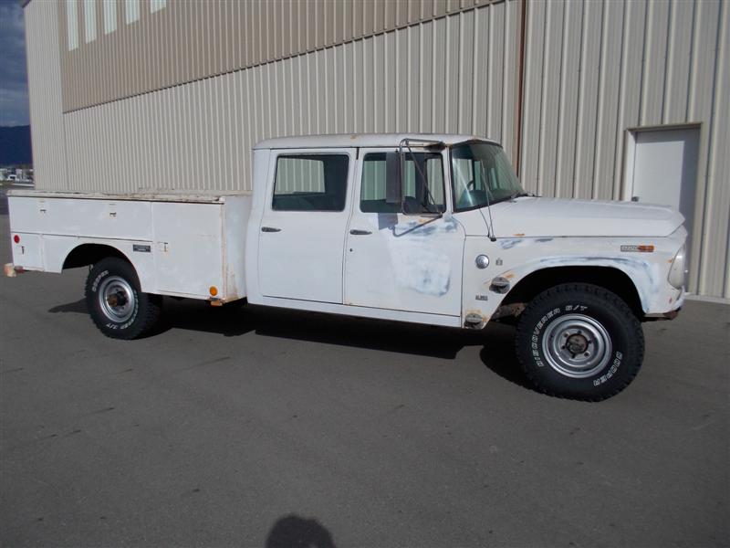

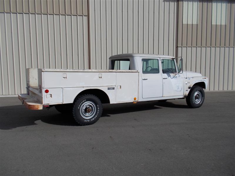

My new (to me) bed for my 1200c travelette was delivered last weekend. Now to recreate the mounting locations.
The middle front and middle rear appear to be where they should be. The front is a bit confusing. I measured some hole locations and the front bed pad needs to go almost exactly where the rear cab mount is..
The rear two (rear most not in photo) sit on the frame rail while the front two sit on brackets that sit just outboard of the frame rails.
I would like to see if any members with a travelette bonus load bed truck could take a few good pictures of the front bed/frame mounts. Only a 2 wheel drive could be bought with the long bed while the 4x4 was only available with the short bed. I presume the front short bed mount would be the same as the long bed so any photos would be appreciated.
A long bed standard cab would be good too from a mount location stand point.
Here is a photo or two of my bed. It's an 8 footer not 8 1/2. Mount width measurments added for ease of explaining the whole scoop. Also it's sitting front end down. Picture = 1000 words.

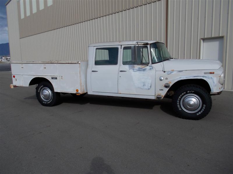

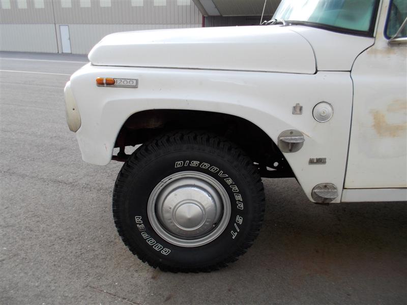

About 3 weeks ago I decided to recycle the original split rims. Just didn't want to spend the extra money buying new wheels.
Had the old tires removed, had the wheels sandblasted, primed them and shot them with paint. Black on the back, silver on the faces.
This weekend I went over to tucker tire and had new tires mounted. They use a remote service for the split rims. 100% hand deal.
Then balanced them. The tires are 255-85-16lt d load range.. 33.2 diameter.. Fit ok on the 5.5" rims..
Wow does the travelette drive nice now. I'm actually impressed by it's highway manors. 65 mph is 2600 70 is 2800. Good enough for me.

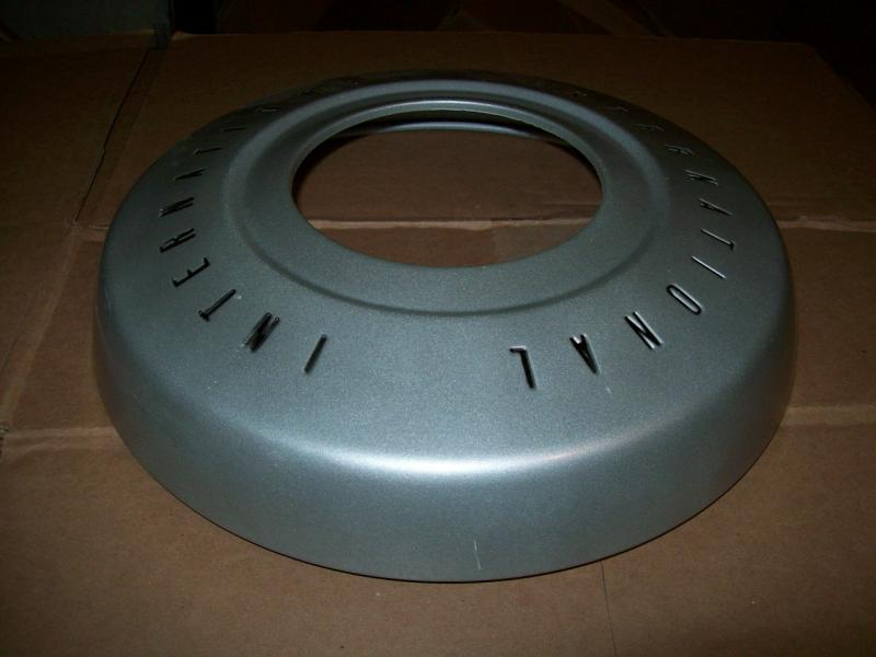

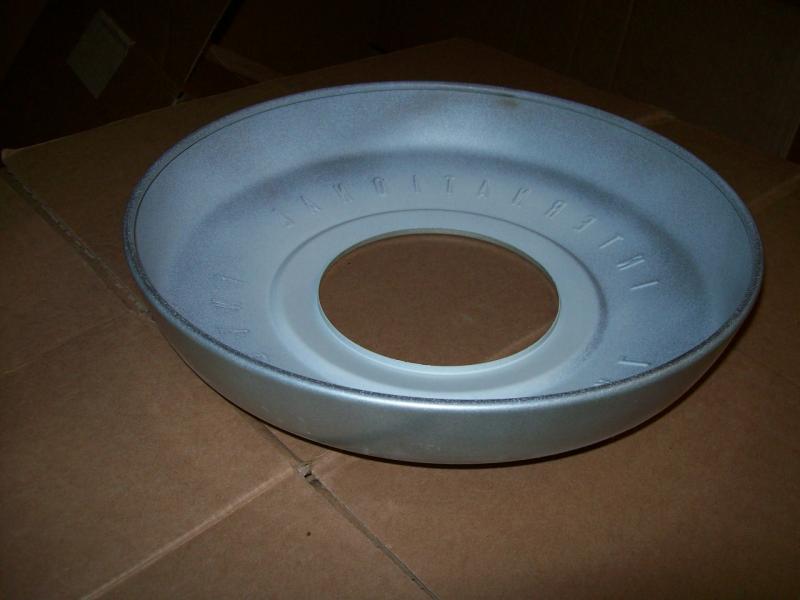

Found a nice set of oem hub caps which are on the way.
