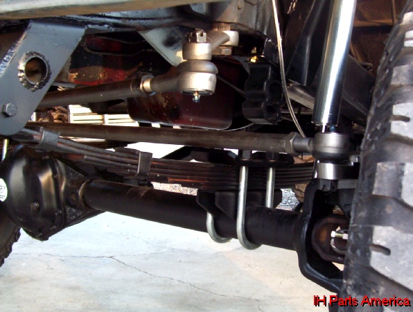

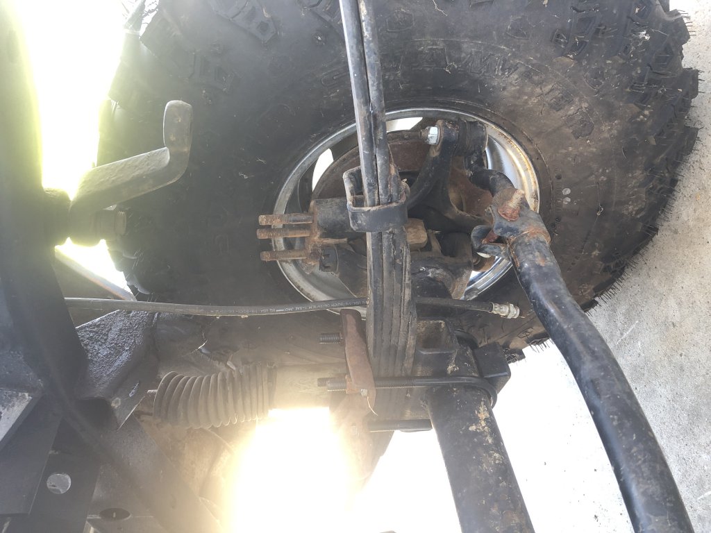

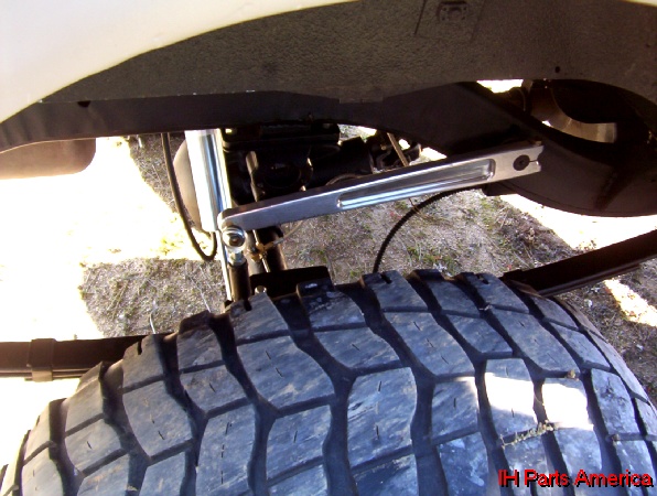

Can you tell us which pitman arm you used? It looks like a 6.5" long by 1.5" drop, is this correct?
harrywt is offline   Reply With Quote
Old 02-19-2013, 07:22 AM   #33
ihpartsjeff
Administrator & Owner
ihpartsjeff's Avatar
Join Date: Jan 2007
Member Number: 1
Location: Grass Valley, CA
Age: 44
Posts: 4,131
Default Re: Scout II SOA + R/S
Quote:
Originally Posted by harrywt View Post
can you tell us which pitman arm you used? It looks like a 6.5" long by 1.5" drop, is this correct?
Sorry for the late reply. It is arm #2 on our online store.

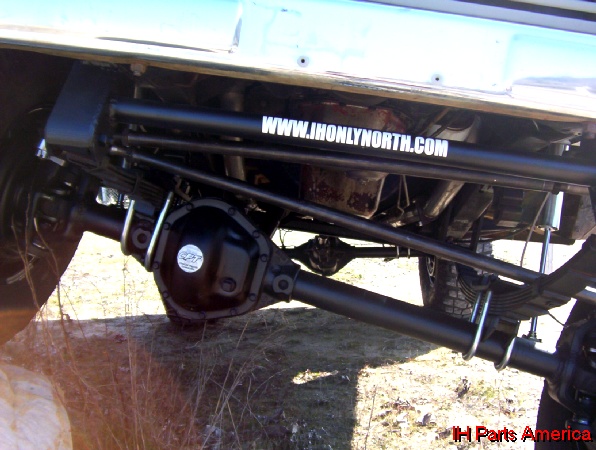

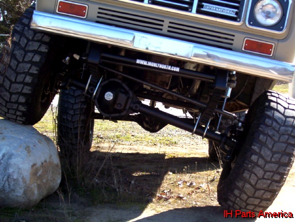

Is that front axle a Chevy Dana 44? Wondering cause the ubolts are uneven on the bottom like the Chevy axles. And if it is did you guys shorten it?
Justutt67 is offline   Reply With Quote
Old 03-11-2013, 07:25 AM   #35
ihpartsjeff
Join Date: Jan 2007
Member Number: 1
Age: 44
Posts: 4,131
Quote:
Originally Posted by justutt67 View Post
is that front axle a Chevy Dana 44? Wondering cause the ubolts are uneven on the bottom like the Chevy axles. And if it is did you guys shorten it?
Yes it was a GM/Chevy front Dana 44 axle and yes we did narrow it to Scout II width.

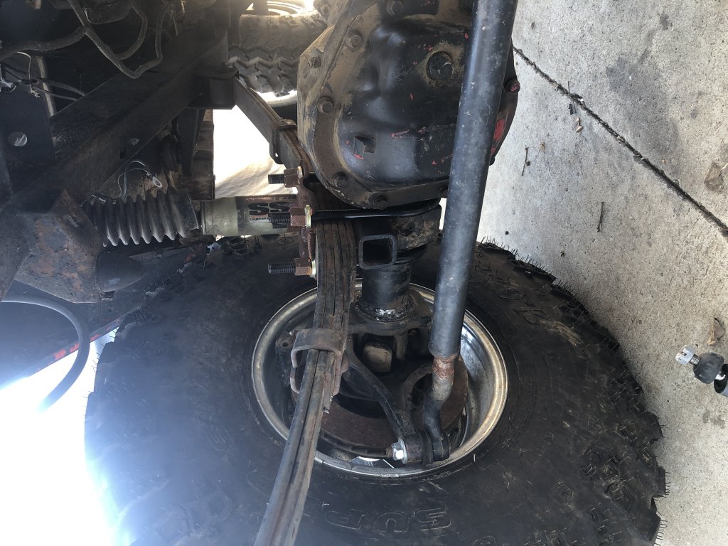

Hi Jeff just have a quick question for you. I eventually want to do a SOA on my rig and when I do I am interested in using a Chevy Dana 44 like this one. I plan to narrow it and use Scout axles with GM outers and brakes. My question is I can't really tell from the pics but it looks like there May be a caster shim on the right perch in the pic. Is this a must? I guess I was thinking that since they were SOA from the factory that the pinion angle would be good to go. Please enlighten me with your wisdom. Thanks!
Old 11-20-2013, 07:03 AM   #39
ihpartsjeff
Join Date: Jan 2007
Member Number: 1
Age: 44
Posts: 4,131
hi Jeff just have a quick question for you. I eventually want to do a SOA on my rig and when I do I am interested in using a Chevy Dana 44 like this one. I plan to narrow it and use Scout axles with GM outers and brakes. My question is I can't really tell from the pics but it looks like there May be a caster shim on the right perch in the pic. Is this a must? I guess I was thinking that since they were SOA from the factory that the pinion angle would be good to go. Please enlighten me with your wisdom. Thanks!
The passenger shim is needed to increase pinion angle. Just because the axle is set up for SOA doesn't mean it will perfectly work in all SOA applications. With the Scout's shorter wheelbase and hence shorter front driveshaft more pinion angle is needed to avoid any ujoint binding. Once the pinion angle is set the driver side perch is welded in place to match the passenger side's new angle.

Hi Jeff I forgot to ask last time. Do you recall what degree of shim you used on the passenger side spring perch and what the overall pinion angle was when shimmed?
Old 05-09-2016, 08:51 AM   #41
ihpartsjeff
Join Date: Jan 2007
Member Number: 1
Age: 44
Posts: 4,131
hi Jeff I forgot to ask last time. Do you recall what degree of shim you used on the passenger side spring perch and what the overall pinion angle was when shimmed?
I'm sorry but I don't have an answer for you. This project was done so long ago that I just don't recall. My suggestion is bolt up the axle as is and then check your measurements. After that you can order the shim(s) from there. Takes a little longer to get done this way but overall will net you a better overall driving Scout.
