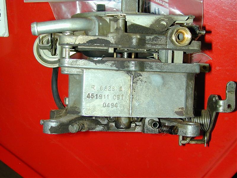

For identification purposes, here's a shot of a "typical" 22xx (this is a 2210c) used on IH-produced sv 304/345 engines, along with the amc 401. A 2245 is simply another variation of this same basic series.

The Holley 22xx series carbs will carry both the IH part number and the Holley "list" number stamped into the flat surface on the passenger side of the main body fuel bowl. Any number cast into the part, is not a list number, but is a part number for that particular part.
This carb is a 2210 with an evaporative emissions system bowl vent, 1975 304/345 pickup with any transmission.

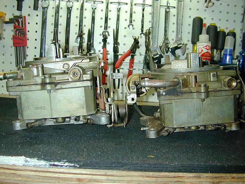

Thanks to david fulford in indiana, we now have a 2245 to use for a side-by-side comparative analysis for proper carb identification. This carb came from david's rig way back when which was converted to a 2300 centerhung (list 0-7448) with electric choke. This carb core has several issues which I'm sure david was unaware of, but now he'll find out the rest of the story!!
Throughout this series, the 2210 carb/parts will always be on the left hand side of the pic, the 2245 stuff will be on the right hand side. And...any anti-diesel solenoid and/or dashpot mounted to each carb have been previously removed for clarity.
First off, a shot of both carbs side-by-side, top view. The 2210 has a throttle lever-operated bowl vent, the 2245 does not.
Also notice the "tower" in the center of each carb, the 2210 has no external penetration to the vacuum chamber for the power valve actuator. The 2245 does have a penetration in it's tower, which is "plugged" at the point of manufacture.

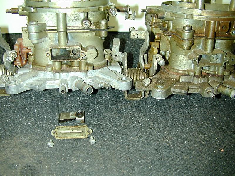

Here's a front view of both mixers. 2210 is a previous commercial "reman". How do I know? The ihc part number and Holley list number have been obliterated by media blasting. Very common commercial practice and is not the way to "clean" a carburetor! If the stamped numbers have been blasted off, just think what has happened to the critical surfaces and passages!! Typical practice of "champion" brand remans.
I do know the history of this carb/vehicle. I did a Holley 2300 centerhung conversion on the rig last fall. It has been problematic for several years.

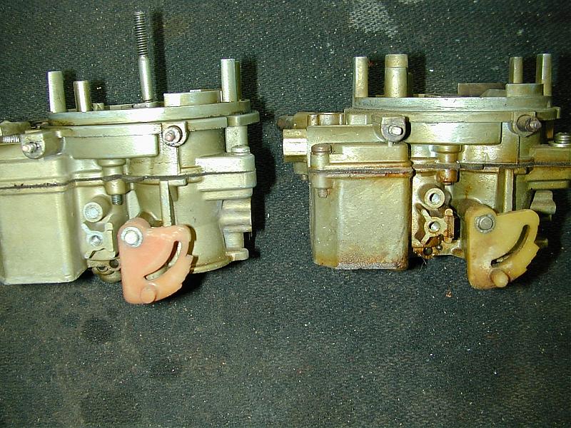

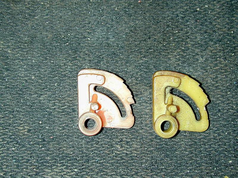

Here's a driver side view. Slight variations in the choke shaft linkage, notice the two different colors of the nylon fast idle cams, that's an important difference we'll discuss later.

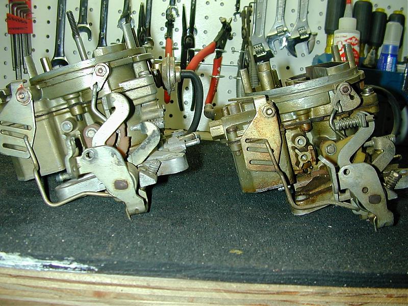

And here's the passenger side view.
Note that the throttle shaft penetration in the 2210 throttle body has been plugged with black rtv, that's a dumazz thing to do!
And...look close, the "ported" vacuum source nipple for the 2245 has been plugged internally with red rtv!!! How tha hail can the distributor advance operate if it sees no vacuum signal???
Also, the vacuum choke break has been jury-rigged with a piece of wire as a replacement for the oem link.

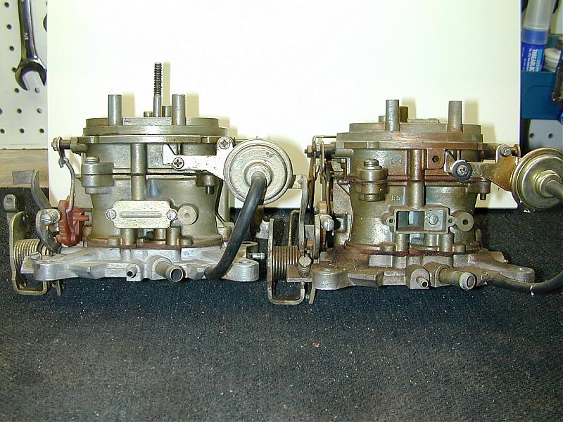

Here's the rear view.
The 2210 is equipped with a hot idle compensator valve located under that rectangular steel cover retained by two screws. Under the cover is a bi-metal thermostatic control which senses main body temperature (indicator of underhood temperature) and serves to provide a calibrated "vacuum leak" under certain conditions, part of the "smog" add-ons for this carb series and is not used in all variations.
The 2245 has provisions in the main body casting for the hic valve but has not been completely machined and does not use an hic system.

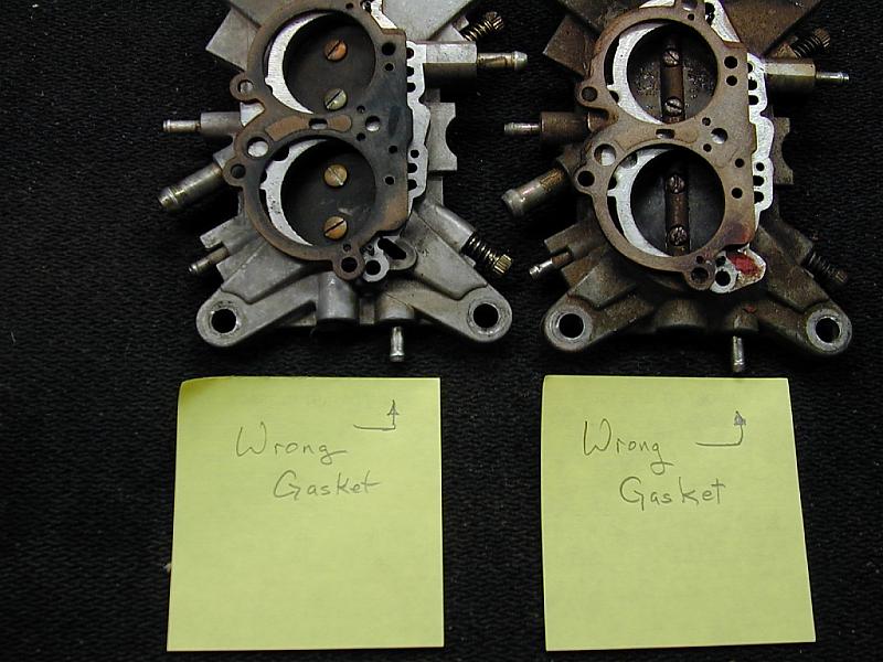

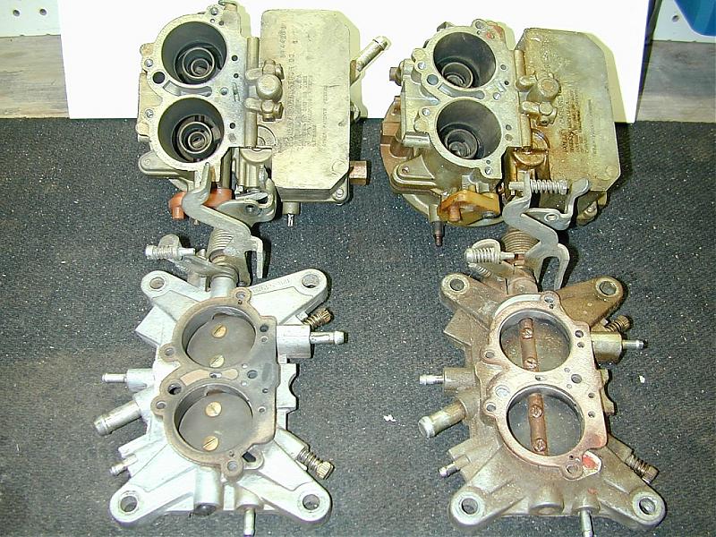

Here's a shot of the throttle body removed from the main body. Can ya spot the same issue which is root cause failure for both of these carbs???
The gasket between the two components is actually a heat insulator. That is a design used to reduce "fuel percolation" in applications of this carb on various smog motor applications (both for ihc and all other oem apps).
In the case of the 2210, the wrong gasket was installed (remember this is a commercial "reman" carb?), the "ported" vacuum port for the distributor advance is open to the atmosphere because there is no gasket coverage on that area!!! That means a major vacuum leak is introduced when the throttle plates are in "tip-in" angle and after. Probably not a vacuum leak at idle depending upon idle speed. And of course, this would result inna no vacuum signal to the vacuum advance can on the distributor control circuit.
On the 2245, the same issue is present. However, someone plugged the vacuum port with red rtv!
Once again, folks that should not be attempting to work on carbs have screwed up perfectly good mixers. This is typical of folks that post ..."I rebuilt the carb but it's still screwed up"! This is totally inexcusable in the case of the "commercial" reman 2210 carb, but I see issues like this quite often.

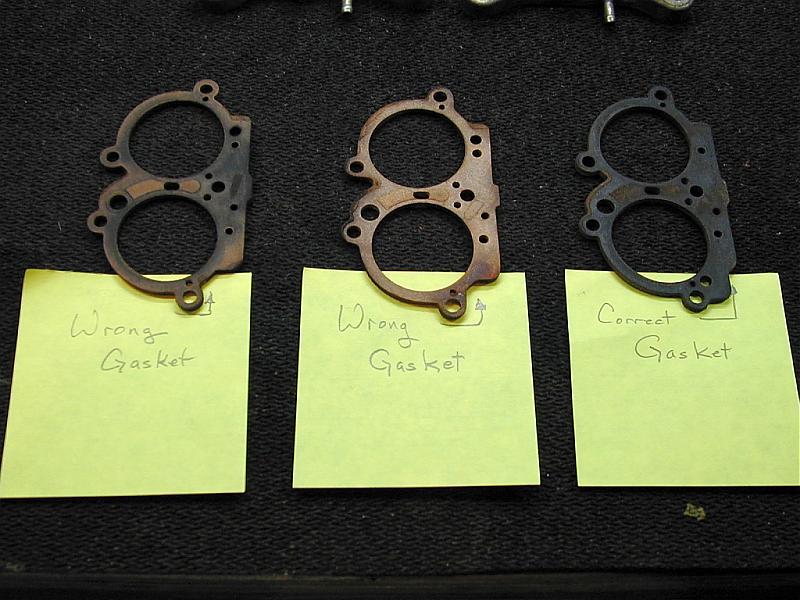

Another shot of the incorrect heat insulator gaskets with partial removal. This pinpoints the area of failure.
These gaskets are actually accurately located when installed through the use of two very small roll pins inserted into the throttle body, that keeps the gasket properly aligned during carb assembly.
There are several variations of both these carbs used on oem apps other than ihc. In those cases, the throttle bodies all have a different mounting flange/bolt pattern arrangement. Some of those apps do not use a ported vacuum source on the throttle body.
Many of the commercial carb overhaul "kits" contain only one gasket (the incorrect one for IH app). Currently, I use the hygrade p/n 928c kit for these carbs because it contains new power valves of either configuration (more on this coming up). But occasionally, that kit does not contain both gaskets (packaging quality issue), I have one of those on hand now. The wells ck 540a kit always has all correct parts, but can be a problem for some folks to source locally. The Holley-supply kits for this app do not contain replacement power valves (either type) which makes those kits useless in my book.

Here's a direct comparison of the heat dam gaskets, both variations, the left hand and center gaskets are wrong for the ihc-app 2210/2245 carbs, there is no seal created for the "ported" vacuum source.
The gasket on the right is from another 2210 teardown, it is correct, notice the protrusion of the gasket which seals the ported vacuum port.
Other than that single point of reference, all the gaskets are identical. If you are gonna play with these carbs, you must pay attention to this detail!

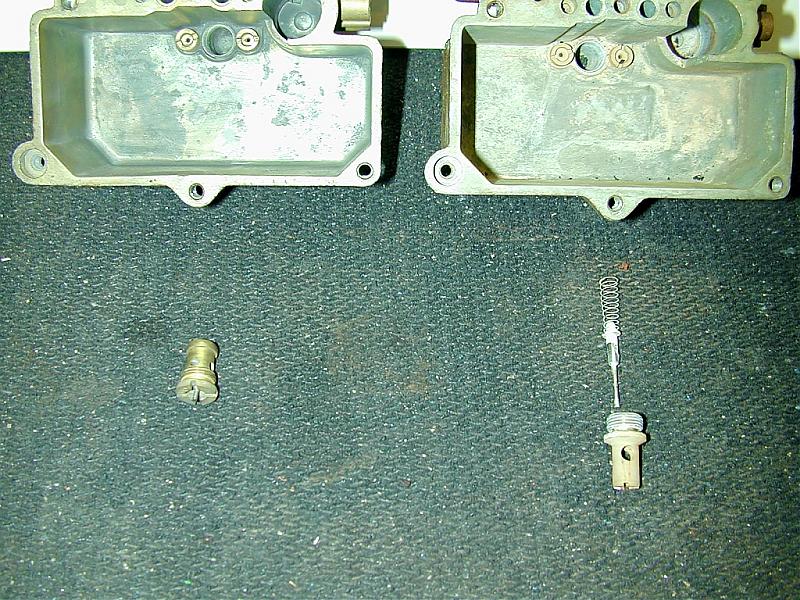

Now we have the bowl covers removed. Ya can see that the power valve actuation systems between the two models are completely different in design. The actuators are the items between the two brass tubes sticking out of the tops.
This actuator is the most problematic area of these carbs, and a major reason I refer to 'em as "throwaway" those items are not replaceable (no service parts are available new) and the bore in the top can be heavily corroded and unusable.
The 2210 uses a "two stage" power valve actuation system, it's either closed, partially open, or fully open depending upon manifold vacuum level.
The 2245 uses a more advanced, "gradient" power valve system, this circuit is variable over a wide range of manifold vacuum levels.
The components seen in this shot are the power valve actuators...not the actual power valve components themselves.

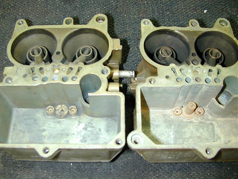

Now let's look at the actual power valves themselves. Some references refer to these devices as "economizer" valves also, a carryover from the early model of various Holley mixers. So the term "power valve" and "economizer" can be used interchangeably.
The two stage power valve in the 2210 is short and squat, and is mounted between the two separate main jets (one jet for each venturi). The power valve system feeds both venturis equally.
The gradient-type power valve for the 2245 is mounted in the same position, but is taller in size to accommodate the tapered valve stem and it's balance spring.
The main body below the power valve seat is machined to accept only each type of power valve, they will not interchange from 2210 to 2245 and visa-versa.
