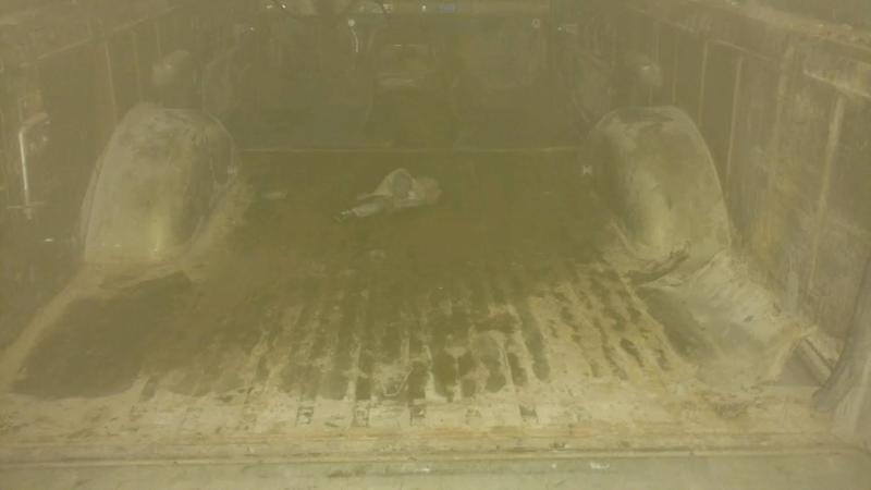

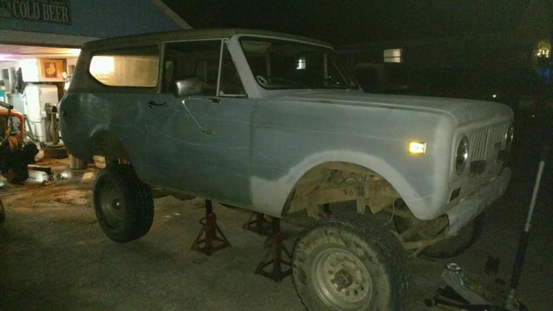

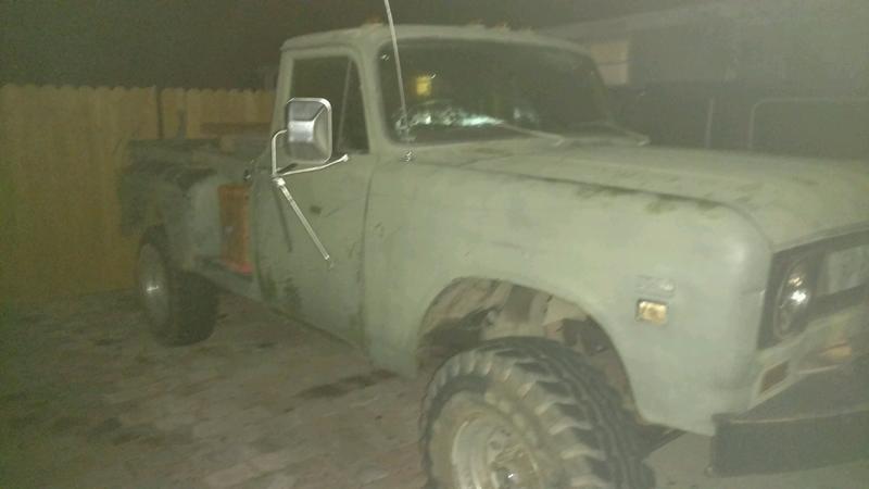

Alright so its a 74 with a 345 (so I was told haven't verified yet) 4 speed disc brake Dana 30 up front 44 out back 3.73 geared and a SOA lift with a very scary looking homemade z bar that has got to go,so far just swapped out the carb for a known good Holley I had and got it running properly and replaced the top and tailgate with ones outta my parts pile the po apparently had a hell of night he can't remember and woke up parked in the middle of some trees

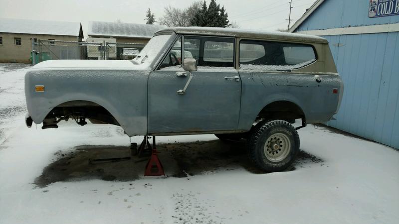

Here it is after taking some measurements and getting ready to tear her downName:  scout build.jpg

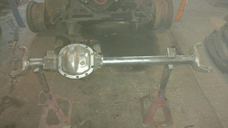

Now I know I know its just a Dana 30 but I still took the time to do a cut and turn on this thing making due with what I got till I pull the Chevy 44 out of another rig to put under it planning to throw in a reverse shackle at that point alsoName:  PART_1453208038263_IMG_20151231_053403928.jpg

That big green ugly thing is my beast thatll be giving up its Chevy Dana 44 and replaced with a GM kingpin 60 ive been hoarding

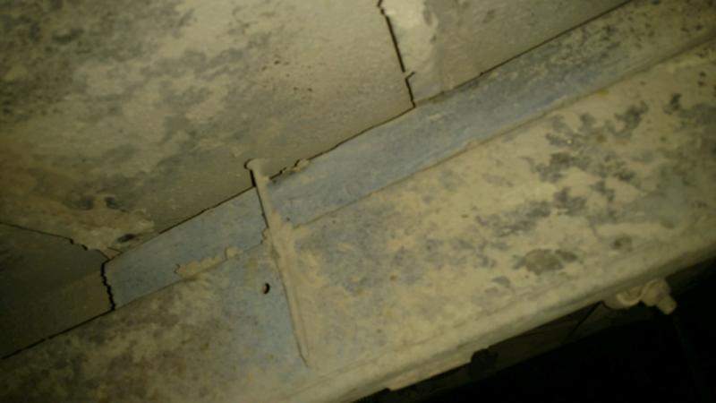

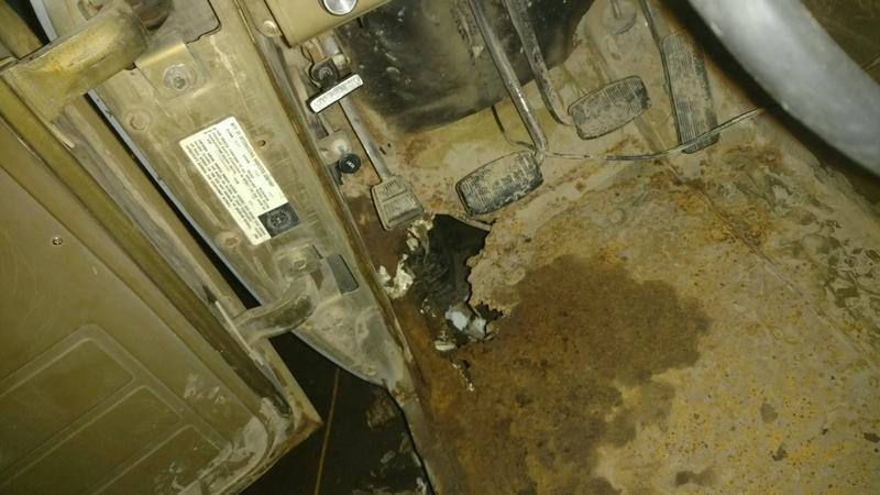

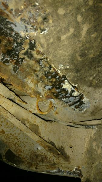

Ok so at this point I had the suspention where I wanted it put in a new steering pump and drove it to work for a few days but a valueable lesson I learned from my very first Scout was that go figure these things are rusty! Guess I thought it would fix itself so I just ignored the issue and drove the tires off it till it literally folded in half, so not wanting to make the same mistake twice I wasted no time on this new turd to tear out the seat and floor mat and see what I could do, I was alittle shocked at a po fix for the lack of body mounts gotta hand it to him though it was alittleName:  scout front mounts 1.jpg
Name:  scout front mounts 2.jpg
Name:  front mount 3.jpg
Name:  front mout 4.jpg
Name:  front mount 5.jpg

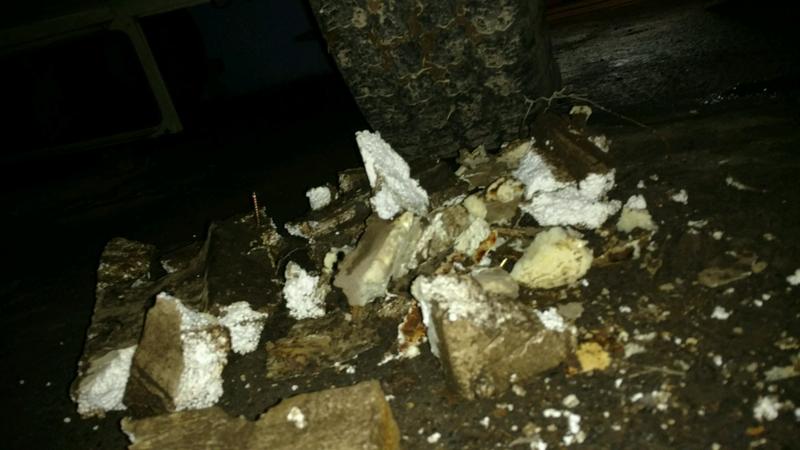

Size:  54.3 KB Creative mixture of styrofoam, chucks of wood and electrical conduit all held together with screws baling wire and bathroom chaulking topped off with bed liner for a classy finish

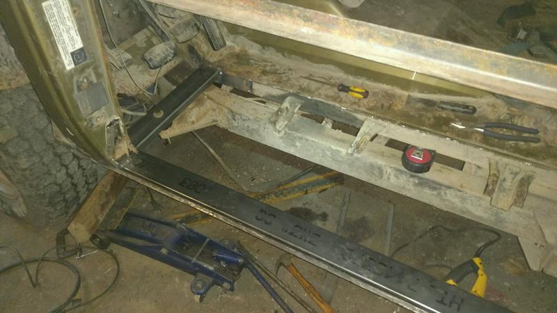

So I put in new body bushing wherever there was still a body mount left to do so then went to town with a cutting disc starting on the drivers side getting it all cut out and coming up with a plan to rebuild it with some stronger stuff from my local steel yard nothing that hasn't been done already a dozen times and covered in great detail on this site but ill still try to throw some pictures up along the way maybe somebody will find it useful

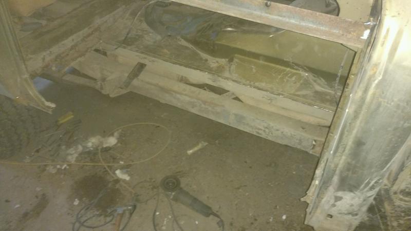

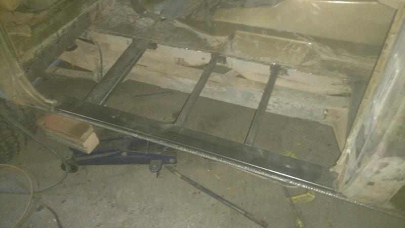

Had my day off so got some more work done on the Scout I set a goal that I wanted to get the drivers side body mounts and structure all put back together so five hours and not sure how many beers later I did just that
BRut is offline   Reply With Quote
Old 01-28-2016, 06:36 AM   #11
BRut
Join Date: Dec 2015
Member Number: 8030
Posts: 33
Default Re: I actually paid money for this?

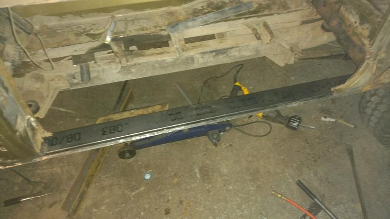

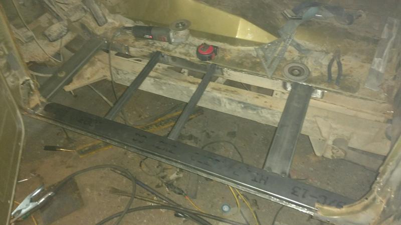

I made a new rocker outta 3x3 tubing if I had to do it again I woulda used some thicker steel but still twice as thick as original and plenty strong its hard to see in this picture but I replaced the center shelf mount with a piece of 1.5x 3 inch tubing as well it ties in nicely between the new rocker and back dogleg this was the best solution I could come up with sense there was nothing left of the original to salvage

Front floor mount in place not sure if it really needs it but I'm gonna add a gusset to the rocker just for a bit more strength

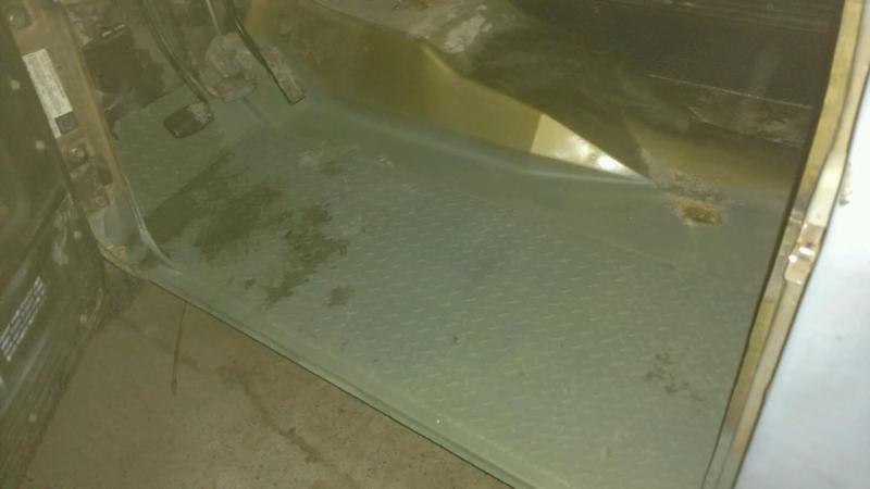

Old 02-04-2016, 05:41 AM   #14
BRut
Join Date: Dec 2015
Member Number: 8030
Posts: 33

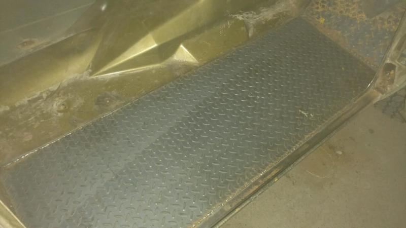

Had another night off so I tackled the passenger side same as the drivers gotta order up some diamond plate from the steel yard and hopefully get the front floors all buttoned up next week, Name:  passenger side floor cut out.jpg
Size:  35.3 KBName:  passenger side all tacked together.jpg

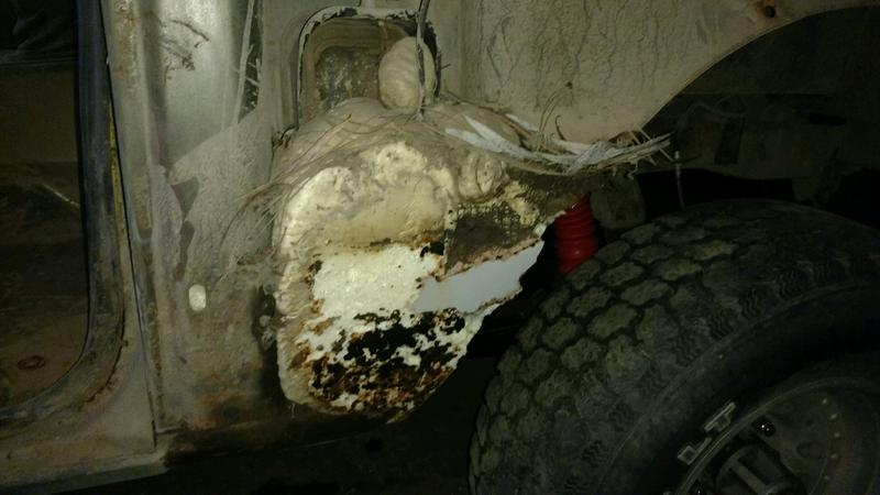

Size:  33.6 KBthe po must of got a really good deal on a case of expanding foamName:  passenger side front fender.jpg
