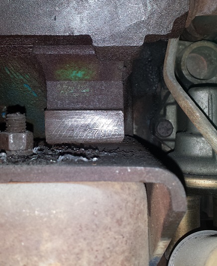

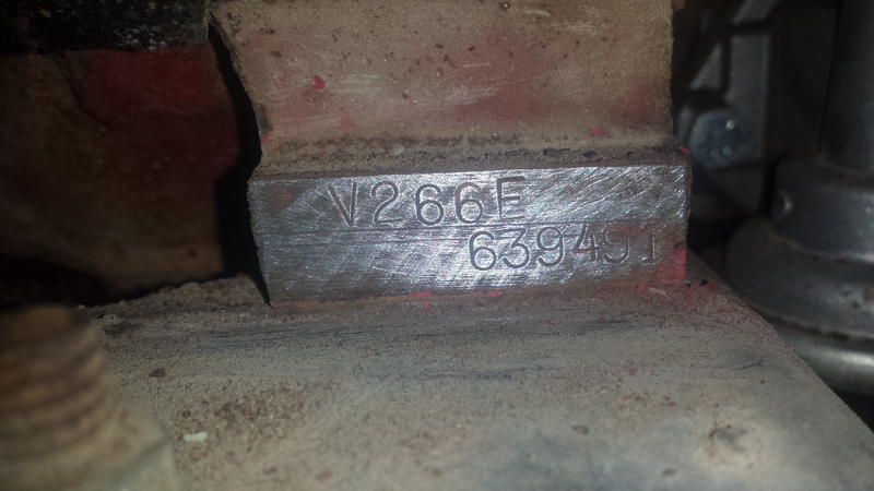

Here's a couple of photos of the engine id location. The 266 was mounted, with all accessories attached, in a 69 800 Scout when photo was taken. And the 345 was also mounted in engine compartment when photo was taken.
As you're facing the passenger side of motor, that machined boss were the stamping is, is directly above the motor mount just to the left of the fuel pump. The 304 id stamping is also in this same exact location. At least every 266/304/345 motors that I have seen are like this
Due to the extremely small space in the 800, I used my smart phone to take that photo of the 266. With small piece of sand paper had to sand off the machined surface in order to get a good enough photo to read.

Scooter thanks a bunch those pictures really help. I was looking in the wrong spot.

Figured that would be the best way to show where the engine id is located. It just so happened that I actually needed to identify the exact motor size of the 266 in order to order the proper parts for the fuel injection upgrade that it received. I was way too lazy to pull the motor just to read that number. So the camera on my phone and sand paper came in real handy
and the photo of complete motor/trans sitting there also is another great view of where it's located

Both the photos that I posted earlier, had exhaust manifolds still installed when taken. The 266 has stock oem manifolds and the 345 has stan try-y headers.
As I mentioned previously, when the motor, with all the accessories still attached, is installed in the engine compartment, space is extremely tight and can't stick head in there to see it. Which is why I ended up using the camera on my smart phone to take the photo of the 266. The 345 has a one inch body lift, that gave me enough room to view that id pad between the inner fender well and frame. I did not have to take apart anything in order to take the photos.
