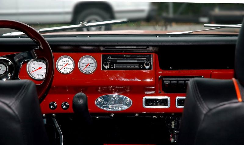

here is the Scout at the 2007 Scout nationals.....this was hands down the nicest Scout that I have ever seen.

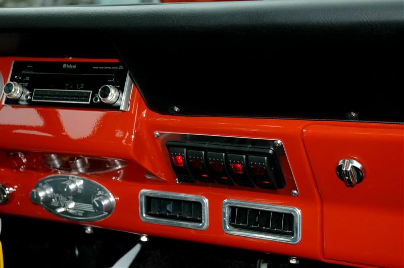

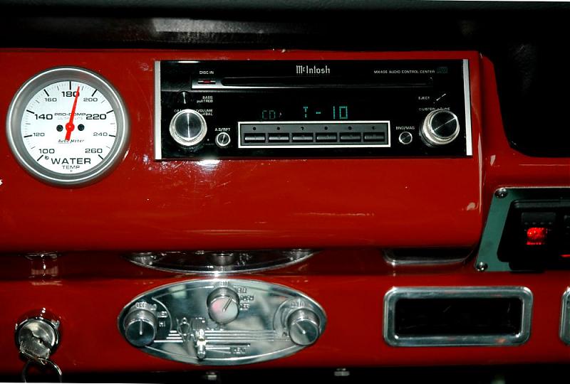

The dash after paint. The a/c vents, a/c-heater control, and auxiliary switch's were installed.
The vintage air hvac system was installed under the dash and hoses were hooked up.
The engine oil cooler and lines were installed next.

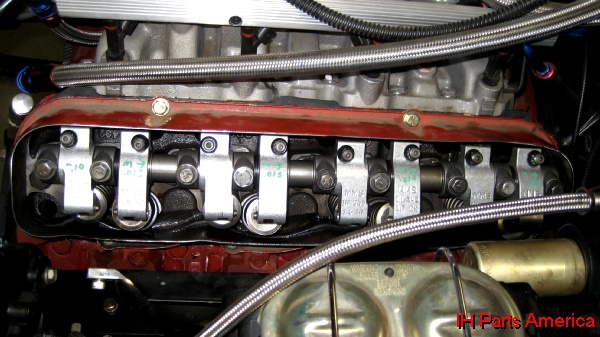

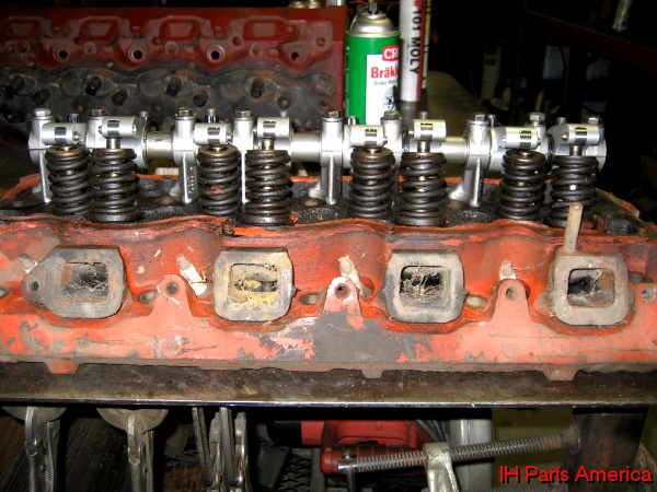

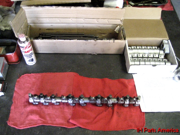

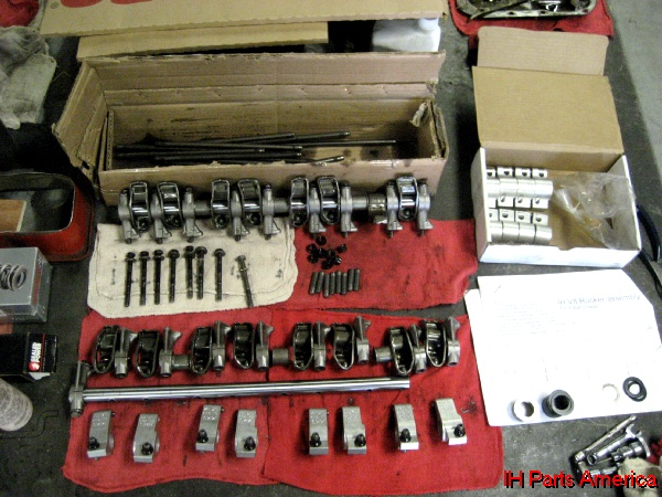

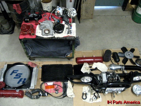

And now for a turn of events. After installing all of the coolant hoses Darren performed a dry pressure test of the cooling system to verify no leaks. Well were we surprised to find that the cooling system would not hold pressure. In fact it sounded like it had a pretty decent leak and it was coming from inside the valve cover area. After some more detective work we found the leak. After all these years the passenger side cylinder head had a porous casting and was now showing up.
With the cooling system under pressure you can see the geyser of oil spray up as we searched for the leak.
So off came the cylinder head. A quick trip over to huthcinson racing and the head was fixed.
