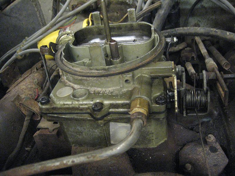

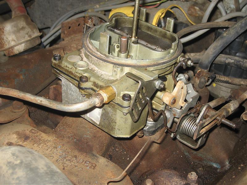

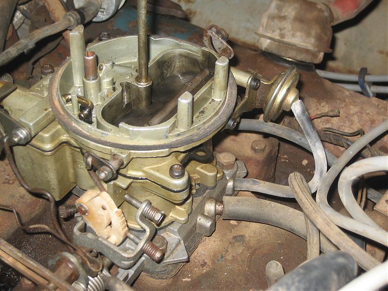

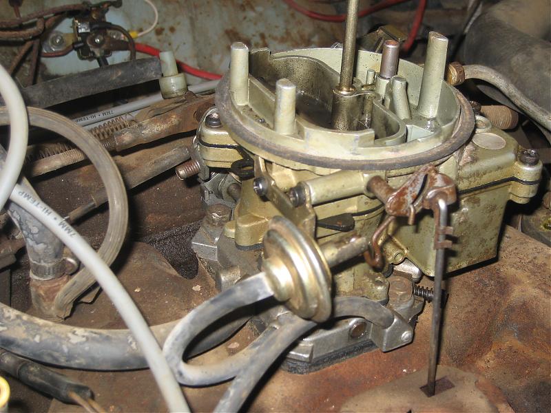

Take several well-focused shots of the carb on all four sides. Then do the same of the "top" of your engine so I can see the detail. That way we know what ya got upfront and we can advise as to all areas that might need attention.
