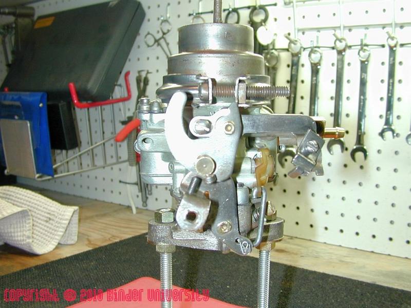

And this shot is the completed 1904 I have for you before installing for testing.
Notice the completely different throttle lever arrangement. And most especially, where the idle speed adjuster interfaces with the choke lever/fast idle cam. You cannot mix an IH throttle lever with the Ford choke lever if the "length" of the choke shaft itself is not a match.
Not all Ford versions of the 1904 were made like this, I have no methodology for identifying this stuff by list number, that is why I always need pics of what anyone has in order to determine "what" they got to begin with!
On that same note, compare this throttle lever with the modded version you have now. Appears that in the past, either judson or "someone" arc-welded that extension mount to the oem Ford lever. I'd say judson because you can see the same thing done on other examples of these parts I've found on the 'net. That could be done in a much neater manner though without welding!
In this shot, you can see that I drilled/tapped the throttle shaft and installed a stainless buttonhead to secure the throttle lever to the shaft, this one won't be giving any more problems! I'd do the same to your current carb when I build it.
