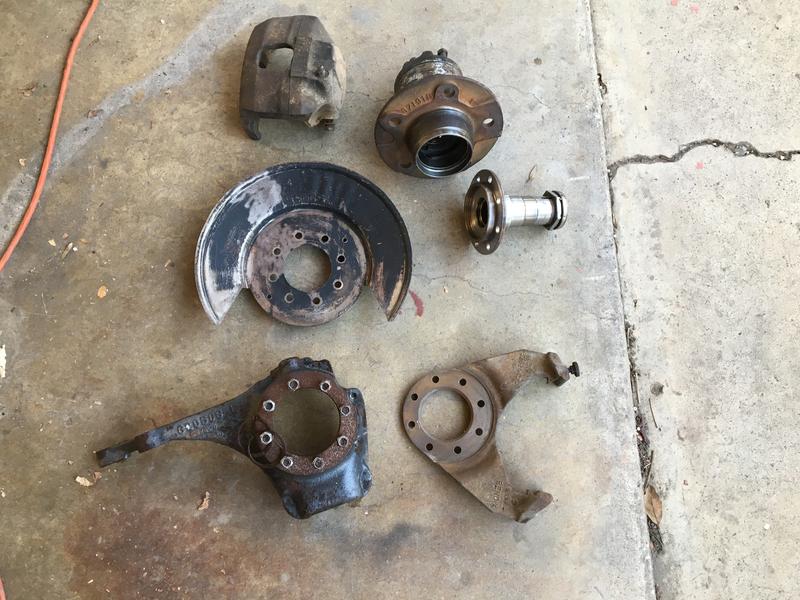

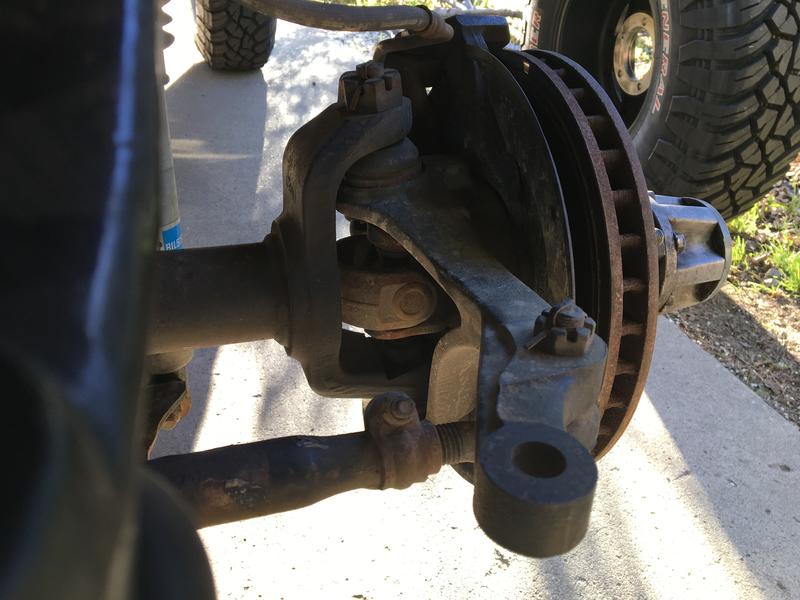

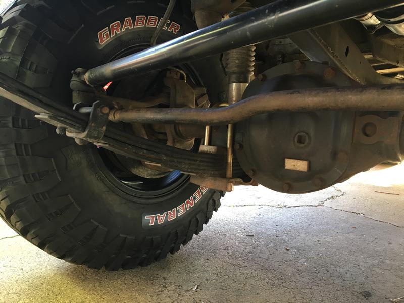

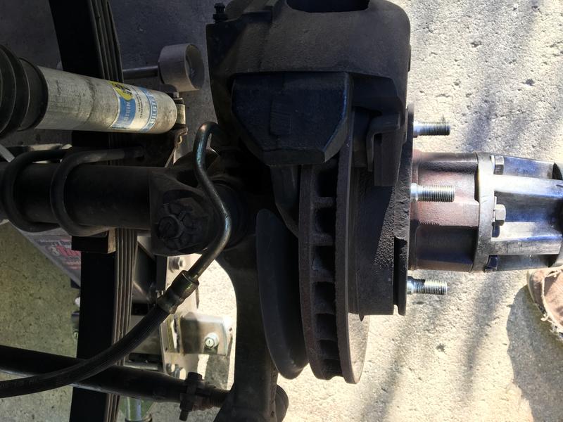

Lets see if I recall how to post multiple pics. Rotor is missing form group shot, but that's what is entailed from "Cs" out. Also not present are ball joints, bearings, seals etc. Your present hubs should work.

Another thing I just remembered, the stock drum wheels probably won't clear the calipers.
