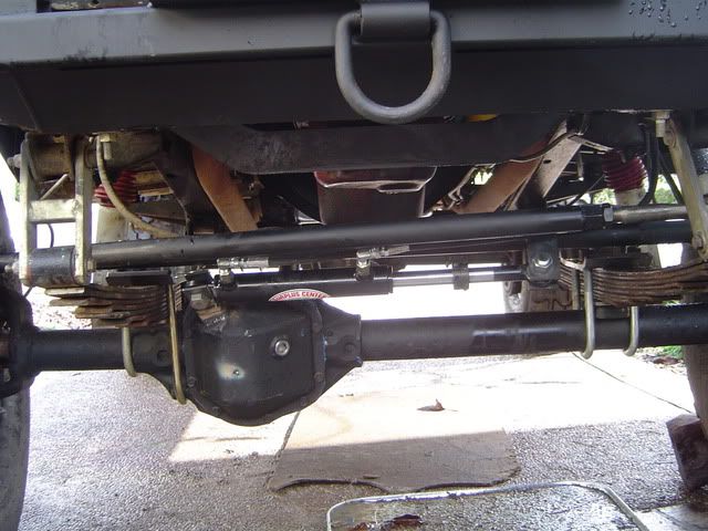

Mounted the ram.
I only tacked the mount onto the tierod in case I need to adjust the toe-in. I will weld it on before any wheelin' trips.
I did realize that I need to take out one of the leaves that I put into the front packs since the driveshaft won't handle two leaves. Good thing I hadn't put the spring clamps/wraps back on because that would have made the whole ordeal more of a pain. Then I'll extend the bumpstops.
